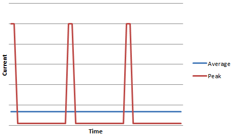

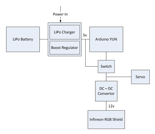

Whilst Hans was busy coding, Matilda was looking into power requirements. She was worried that the batteries might take a long time to deliver so wanted to order them long before they would be needed.
DevicePower Required
Arduino Yun300mA
MicroSD Card100mA
Infineon RGB LED controller9mA
Servo100mA
RGB LED 20mA per colour60mA
Totting up the numbers she arrived at 569mA peak consumption, she realised that by turning things off and running tasks in series that number could be reduced. She also concluded that if they only checked the weather a few times an hour then their overall consumption could be reduced too.
Based on these numbers she concluded that a 2000mAh battery would give them several days run time. She would need to measure the actual consumption once the circuits were assembled.
Given the small size of the cottage, a Lithium Polymer battery gave the best size to capacity, it was also easily capable of providing the peak power requirements. The PowerBoost 500 from Adafruit was selected to charge the battery and also boost the 3.7v of the battery up to 5v needed by the Yun.
