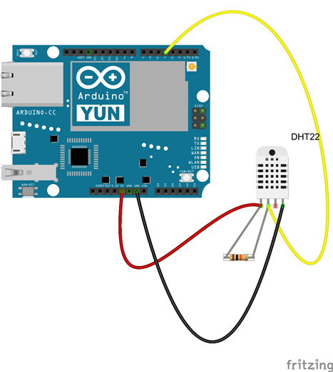

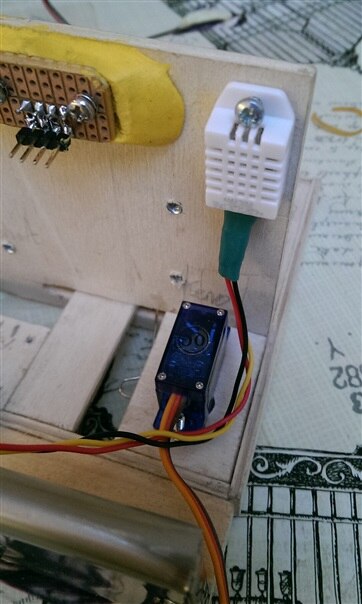

"We are going to have to do it the old fashioned way", said Hans. "Not the cat gut?!" cried Matilda. "Not quite that far back" he said. Hans rummaged in his spares box and brought out a tiny device that looked a bit like a cheese grater. "We can get the local temperature and humidity with this DHT22 and estimate the chance of precipitation from that" said Hans.

#define DHTPIN 4     // what pin we're connected to
#define DHTTYPE DHT22   // DHT 22  (AM2302)
// Connect pin 1 (on the left) of the sensor to +5V
// NOTE: If using a board with 3.3V logic like an Arduino Due connect pin 1
// to 3.3V instead of 5V!
// Connect pin 2 of the sensor to whatever your DHTPIN is
// Connect pin 4 (on the right) of the sensor to GROUND
// Connect a 10K resistor from pin 2 (data) to pin 1 (power) of the sensor
// Initialize DHT sensor for normal 16mhz Arduino
DHT dht(DHTPIN, DHTTYPE);

Hans decided to pass the local temperature and humidity over to the Python script and if there is no network or an error it can still return a position reference for them. That way all the weather related algorithms are in one place. Hans could not find any algorithms that connected humidity to precipitation but he thought if he based it around the dew point that would give a very similar result to the old cat gut.

    Not too sure on the meteorology though. The official meteorological line is that you can't predict the weather based on just humidity and temperature but there does seem to be a correlation from which I can get a reasonable guess, probably a bit better than the old cat gut. I'll unlikely have time but it should be theoretically possible to fine tune the algorithm by checking my local settings against the internet values.

    Yes, more sensors would make for a better results but I was thinking just having a simple backup for when the net is out.
    Perhaps one of the reasons for decline of the weather house is modern double glazing and central heating. I might find that Hans comes out when you have a shower and Matilda takes an interest when you grill some bacon.
    An adaptive algorithm as suggested by Enrico could work and I'd not need to change the arduino code just the python.
