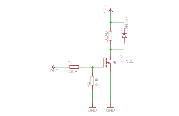

Whilst Matilda worked on the LEDs and top panel, Hans finished off the circuits for the MOSFET power switch and connectors.
Circuit Explanation
A MOSFET is used as a low side switch to turn the power to the servo, RGB LED controller board and humidity sensor. This is connected to the Arduino output with a few extra components from the Arduino Workshop KitArduino Workshop Kit.

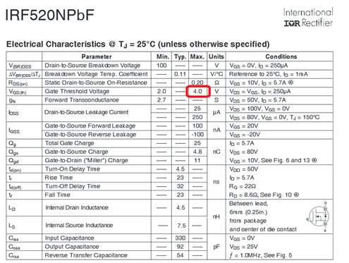

The gate of the MOSFET effectively acts like a big capacitor and for a short period before the transistor turns on it can draw a sizeable current. So series resistor R1 is used to limit the current drawn from the pin. A second resistor R2 sinks that charge to ground when the switch is turned off and ensures that the MOSFET remains off when the Arduino is asleep. The ratio of these two resistors needs to be high so that there's not a big voltage drop over R1, as the MOSFET will only switch on when the threshold voltage of 4v is reached. The final component is a protection diode, this dissipates the charge from any inductive loads such as the servo's motor when the MOSTFET is turned off.

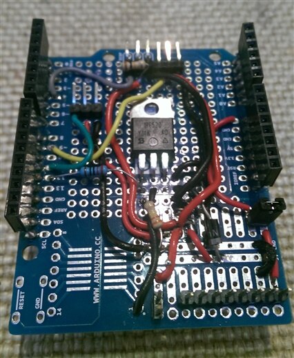

Protoshield
By this point the protoshield had been through a few revisions. This was clear by the spaghetti layout of the resulting wires. The headers for the cables were also a problem and had to be bent over to allow the connectors to fit. Some of these also had to be repositioned so that they could fit around the support struts. Given that the MOSFET will mostly be off and switching infrequently, it should not be necessary to attach a heatsink.

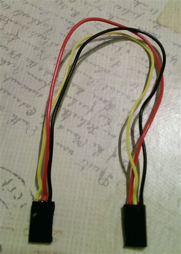

The cable for the new knock knock sensor was also created and Hans realised that the strip board had +V, SIGNAL, GND with the protoshield had SIGNAL, +V, GND as intended so that means the cable will need to be carefully fitted in the correct orientation.  Not an ideal situation but also not a complete disaster.

    Workshopshed over 11 years ago in reply to balearicdynamics +1
    Using a bipolar transistor you'd not need to include R2 as the transistor only turns on when current flows, the mosfet turns on when there is a voltage that charges up the gate so if the Arduino is disconnected…

    Hi Andy, Like you, I too use non-polarized (i.e. cheap!) connectors for prototypes, one trick (well, an obvious one, I'm sure you know it) to help with connector orientation is to put a blob of marker…
    mcb1 over 11 years ago +1
    The gate capacitance is pF. It's really only a problem when you're trying to switch it fast. You could easily drop the series resistor to a few ohms and be totally safe. Also the spec says the gate voltage…

    mcb1 over 11 years ago in reply to Workshopshed
    the housings were a bit battered
    As you've discovered, you need to push on the wire end to fully seat the pin, then with a small screwdriver or sharp item lift the plastic retainer.
    You can push the retaining part back down into the connector housing, and in extreme cases add some heat while holding it in place.
    If it is still not the best a little hot glue with pressure on the wire end (to fully seat the pins) works.
    (It can be picked out if you ever need to.)
    Not all pins and housings are the same, as we discovered at work ...
