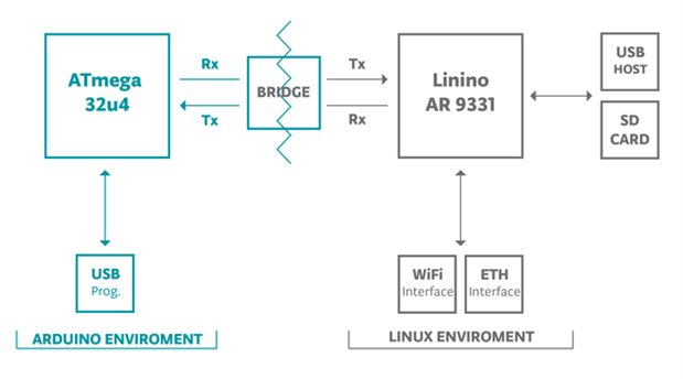

Whilst Matilda was planning and rebuilding Hans hit the books to study the new electronics they were going to add to their house. Hans was having trouble understanding the Yun parts, "why does it need two processors on one board?" he thought to himself.

The following day Hans was studying the Yun manual again and he thought of Jack Sprat and his wife. The Yun was made up of two parts, an Atmel ATMega microcontroller designed to interface to sensors and the real world and an Atheros processor running router software to connect to the WiFi and internet. Complementary functions fulfilled by each part.

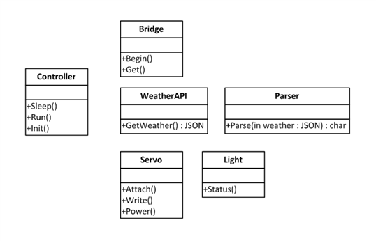

Based on his experiments Hans sketched up a class diagram for the software.
