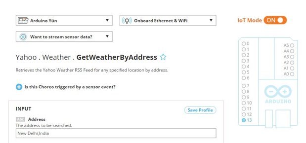

A fancy way to do this is to tell this requirmentdirectly to temboo. In the page where we configured the API you can find the hyperlink which says is the choreo triggered by an input there you say yes and configured the pin for the api to get triggered as and select digital or analog triggered and suitable pin number with input. You can even hook up analog sensor using this approach.
However if you are using active low based triggered I've noticed that temboo generated code doesn't activated the pullup resistorby default so I recomend you doing that to avoid pin floating problems.
Actuating based on API responses
Similarly like triggering API based on input you can trigger an actuator like LED based on results obtained from API for ex: tuning on LED on pin13 if temperature of city >25'c or soimage
Thats how we can use powerfull feature of Temboo on Arduino Yun without even coding a single line. image
One more interesting feature that temboo offers is the ability to stream and store sensors reading to online cloud services like Google Big Query and Microsoft power BI, for this you can use WANT TO STREAM SENSOR DATA feature of temboo.image
