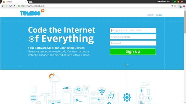

Here I've used Temboo to fetch Weather data of my city using Yahoo Weather API.image
step 1>> Sign up for a Temboo's account on www.temboo.com.

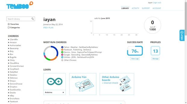

step 2>> Select Arduino Yun as board and turn on IoT mode.
step 3>> On left hand side choose Yahoo Weather > Weather by location choreo.
step 4>> Enter your city credentials and other optional inputs like you want temperature in *c or *f.
step 4>> Copy the generated code and header file.
step 5>> Open Arduino IDE and paste the code, compile and and upload to target board.
step 6>> Open Serial Monitor to check the output.
