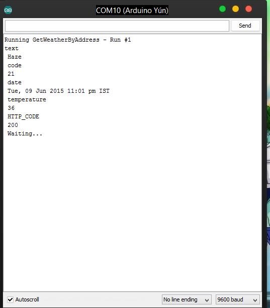

step6>> Alternatively you can add following lines of code before  GetWeatherByAddressChoreo.run(); function
   GetWeatherByAddressChoreo.addOutputFilter("temperature", "/rss/channel/item/yweather:condition/@temp", "Response");
   GetWeatherByAddressChoreo.addOutputFilter("code", "/rss/channel/item/yweather:condition/@code", "Response");
    GetWeatherByAddressChoreo.addOutputFilter("text", "/rss/channel/item/yweather:condition/@text", "Response");
This resolves Temperature, Code and Text from XML in similar fashion you can extract say Humidity.image
Will be adding a triggered sensor in the next one. Stay Tuned! image
