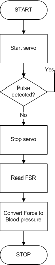

The idea behind this experimental blood pressure measurement is to replace the arm cuff that is inflated by an air compressor with an elastic rubber pulled by a servo motor. When the rubber exercise a force that is exactly equal to the pressure of the blood, the blood stops flowing through the finger. At that moment, I can read the force the finger is squeezed y means of the FSR. Force can then be converted to a pressure value by applying a simple linear conversion
The following flowchart gives an overview of the whole process

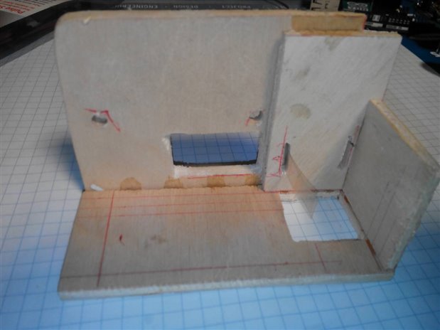

In order to make test easier, I built a frame where all the components will be placed

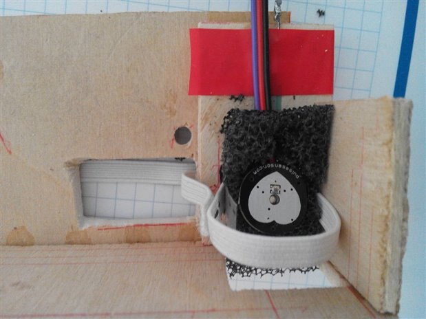

Note the plastic strip that will pull the elastic rubber back when the pressure measurement process has finished

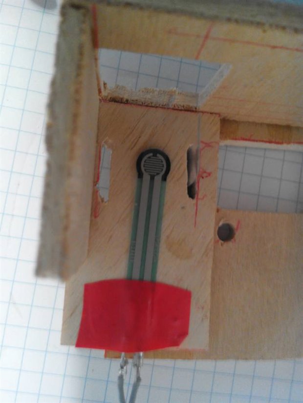

Then I put the Force Sensor Resistor in place

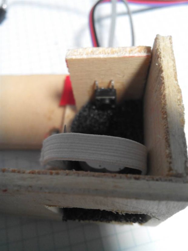

On top of FSR, I placed the heart beat sensor. I enclosed the sensor in foam to protect the FSR (and the patient finger as well..). Then, I placed the elastic rubber
Then I added a microswitch to detect when the finger is in place. Since Atmel 32U4 is not that monster, this makes me save a lot of computational power when there is nothing to measure...

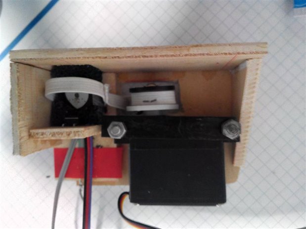

Finally, the servo that pulls the elastic rubber has been added
