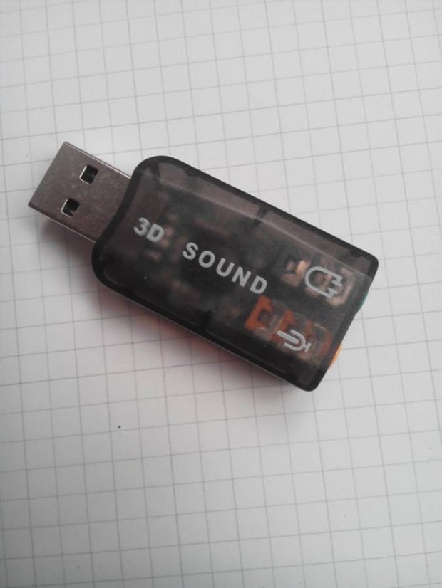

After finishing the data acquisition part of the project, let's see how to make the MagicHat a little more... magic
To make Arduino Yun speak, I first need an external USB audio card like this one here
Then, I need to install an mp3 player that will play a file stored on SD card. Installing the mp3 player is just a few packages away...
opkg update
 opkg install kmod-sound-core
 opkg install kmod-usb-audio
 opkg install madplay
Since the control logic runs on the Atmel side of Arduino Yun, we need to devise a way to launch the player. To send data from Atmel to Linino I disabled the bridge, so now Serial1 is read by NodeJS.
So, the firmware running on Atmel will send out (by calling Serial1.println) a string like
PLAY helloworld.mp3
and NodeJS will launch the mp3 player to play to "helloworld.mp3" file
This can easily achieved using the NodeJS's 'exec'  package
var exec = require('child_process').exec;
exec('/usr/bin/madplay ' + filename);

    Hi clark Looking at the price of the usb sound card (2.21 euros on amazon, shipping included), I imagine that the usb card is really stupid. I think the mp3player and linux drivers do all the decoding…

    Hi Andy Don't know eaxctly what you mean with "configure the sound card". the first two packages are USB drivers for a generic sound card, the third is the player... That's all you need to play an mp3…

    Hi clark
    Looking at the price of the usb sound card (2.21 euros on amazon, shipping included), I imagine that the usb card is really stupid. I think the mp3player and linux drivers do all the decoding works and sends out on usb a stream of pcm data (on in any way another uncompressed format)
    In case of multiple sound devices, a parameter should be added on the madplay command line to select the desired device.
    Cheers
    Ambrogio
  • Workshopshed
    Workshopshed over 11 years ago in reply to amgalbu
    I was thinking that there would be something that told the player that sound should play though the USB. I'm not an expert on how drivers work on Linux systems but there must be something that does the internal "wiring" so that it can work with multiple  sound devices.
  • amgalbu
    amgalbu over 11 years ago in reply to Workshopshed
    Hi Andy
    Don't know eaxctly what you mean with "configure the sound card". the first two packages are USB drivers for a generic sound card, the third is the player... That's all you need to play an mp3 file
    The exec is asynchronous but you can add a parameter that is a callback that notifies you when the execution completes
    Cheers
  • Workshopshed
    Does the installation of the packages configure the soundcard?
    Is the exec call asynchronous?
