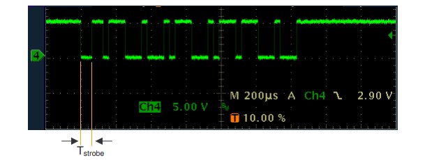

ZACwire protocol

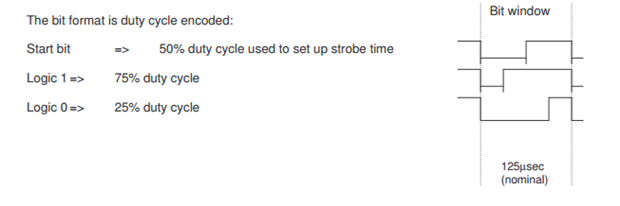

The output is sent out using a very simple protocol: the ZACwire protocol. These are the protocol rules
  • Each byte has a standard format: a start bit, 8 data bits and a parity bit.
  • The output signal is normally high.
  • Each bit transmission starts with a falling edge.
  • A bit is a "0" or a "1" depending on the amount of time the output stays low. To determine whether a bit is "0" or "1", the time the signals stays needs to e compared with the low time of the start bit (commonly referred as TStrobe)
  • The parity bit provides error detection by adding an even parity bit. This means that if the number of "1" bits in the 9 packet bits (8 data bits + 1 parity bit) has to be even

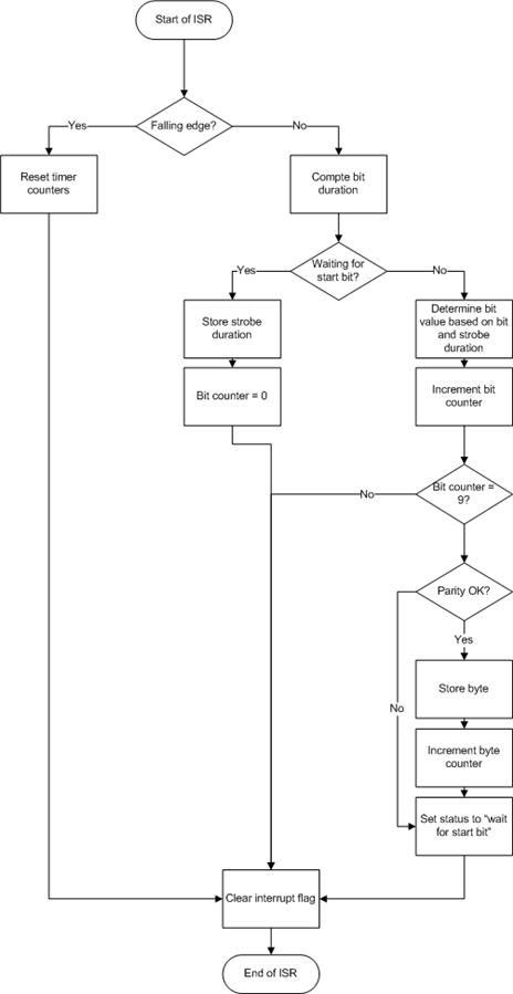

Flowchart below depicts the ISR routine is going to be implemented
Defining the Input Capture ISR routine is quite simple: just add a function like this

The implementation of the ISR method is a simple porting of the flowchart
