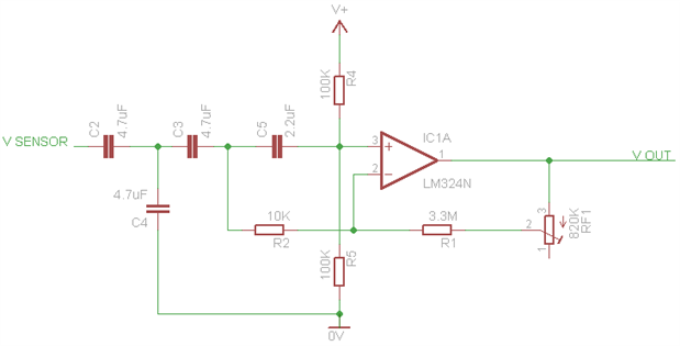

The output (VSENSOR) from the sensor is a periodic physiological waveform attributed to small variations in the reflected IR light which is caused by the pulsatile tissue blood volume inside the finger. The waveform is, therefore, synchronous with the heart beat. The following circuit diagram describes the first stage of the signal conditioning which will suppress the large DC component and boost the weak pulsatile AC component, which carries the required information.
The starting point for my experiments will be an adaptation of the original schematic of the Pulse Sensor module
The basic idea is that the operational amplifier sums up Vcc/2 with the amplified DC component of the Vsensor
Vcc/2 is obtained through the R4/R5 partitor. The AC component is measured on the C5 capacitor. This signal is amplified by a factor of 330 (R1/R2). The RF1 trimmer will make it possible to fine-tune the gain
