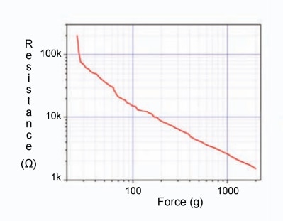

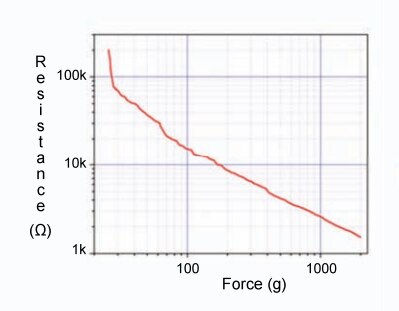

A Force Sensing Resistor is a device whose resistance decreases with the force applied on the sensor surface. A typical graph of the sensor resistance versus applied force is shown below

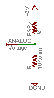

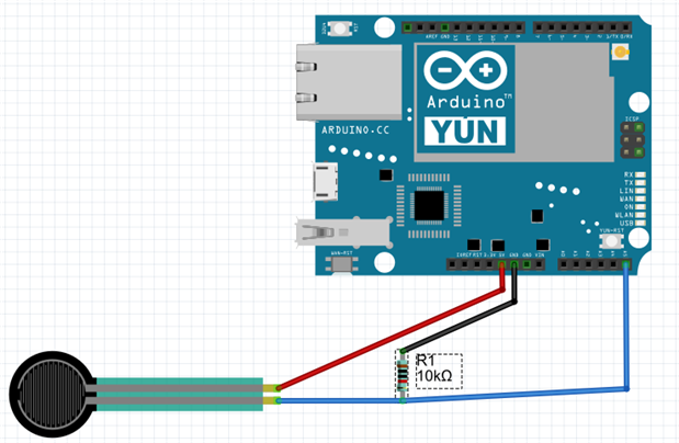

The easiest way to measure a resistive sensor is to connect one end to Power and the other to a pull-down resistor to ground. Then the point between the fixed pull-down resistor and the variable FSR resistor is connected to the analog input of a microcontroller such as an Arduino (shown).
In this configuration the analog voltage reading ranges from 0V (ground) to about 5V (or about the same as the power supply voltage)
The way this works is that as the resistance of the FSR decreases, the total resistance of the FSR and the pull-down resistor decreases from about 100Kohm to 10Kohm. That means that the current flowing through both resistors increases which in turn causes the voltage across the fixed 10K resistor to increase.
The easiest way to determine how your FSR works is to connect a multimeter in resistance-measurement mode to the two tabs on your sensor and see how the resistance changes. Because the resistance changes a lot, a auto-ranging meter works well here. Otherwise, just make sure you try different ranges, between 1 Mohm and 100 ohm before 'giving up'.

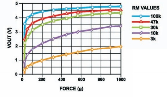

This table indicates the approximate analog voltage based on the sensor force/resistance w/a 5V supply and 10K pulldown resistor.
Note that our method takes the somewhat linear resistivity but does not provide linear voltage! That's because the voltage equation is:
Vo = Vcc ( R / (R + FSR) )
That is, the voltage is proportional to the inverse of the FSR resistance (see graph below)
