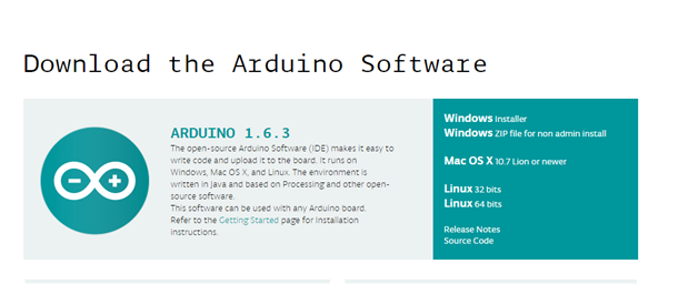

  1. Visit the Arduino Software page
  2. Scroll halfway down the page
  3. Click the link for the OpenWRT-Yun upgrade image

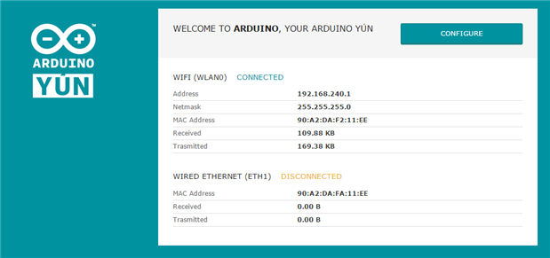

  • On your laptop, check the available WiFi Networks for a new one called something like: ARDUINO-YUN90XXXXXX.
  • Once you’ve connected to your Arduino’s WiFi, open a browser and visit arduino.local. If that doesn’t work, visit 192.168.240.1 (I’m not sure why, but I found the former to be flakey). When asked for a password, enter “arduino”

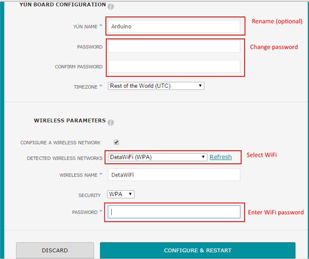

  • click the Configure Button in the top right. Here you can:
    Change the name of your Arduino Yun
    Change the password
    Connect your Arduino to a WiFi network.
  • Select your WiFi network from the dropdown and carefully enter your password. If you get the password wrong you will not get an error message. If your Arduino reboots but you still see its Arduino Yun-902XXXX as an available option, there’s a good chance you typed in the wrong WiFi password.
When all the settings are to your liking, click Configure and Restart. While you’re waiting, switch your laptop over to the WiFi network you just punched in to your Arduino Yun and wait for it to join you there.

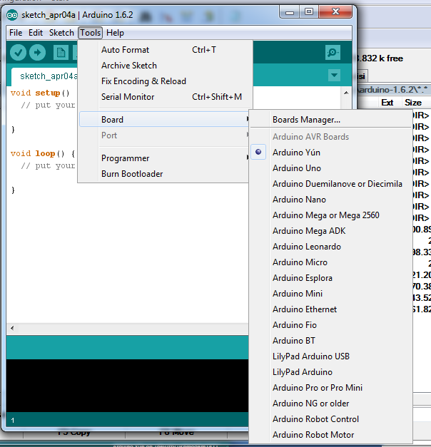

This file is about 150 MB. After it downloads, install it, then open the Arduino IDE. Then we need to do two things to set up the IDE to work with your Yun:
First, click Tools -> Board and select Arduino Yun.
Second, click Tools -> Port and select the option with the IP address (it’s probably the last one).
From now on, you can build and download applications as on any other Arduino board!
