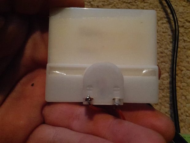

My first stage of testing was to remove the display from the meter's circuitry and hook it up to a 5v power supply to see if the dial would reach full deflection. Thankfully the dial had convenient positive and negative labels for the terminals. I briefly tapped the terminal and the dial immediately went off the scale. This may change my approach to the design for project. It may be possible to commit the motor driver and circuitry from the multimeter and instead drive the dial via a pwm pin from the Arduino via some resistors to limit the current. Of course this depends on the power required to drive the dial and whether the Arduino is capable of supplying the required current. If this is possible, then I may instead use the LED driver I was sent to implement a more interesting backlight.
I also noticed that the cover for the display was held on only with sellotape. This potentially means I could remove the cover and polish out some of the scratches that it has picked up over the years. However, my experiences with polishing plastic have been universally disappointing. If you have any advice on how to polish it, or on any other aspects of the protect, please feel free to leave it in the comments section.

    Again, here I go with my car background, but there are kits available for restoring automotive headlight plastic to their original clear surface. Most involve some very fine sandpaper, and some buffing…

    Thinking about Mike's comment, perhaps some T-Cut might work, you can get it from Halfords or even some supermarkets.

    Thank you all for your replys. The main thing that I am worried about is that I could potentially cause more damage to the plastic in my attempts to clean it. This has been a problem for me in the past. Low grit sandpaper in particular seems liable to cause more damage.
    mcb1 over 11 years ago in reply to kidiccurus
    Yes Low Grit ie 80 will cause damage.
    You need something like 4000 or higher.
    Personally I'd simply stick with either a metal polish, or even a car polish that has a 'cutting compound' in it.
    Try laying a cloth with the polish on it down on a flat surface and rubbing the meter against it.
    Short out the meter with a wire, this will help damp it so it doesn't bounce around.
    I seem to recall advising you earlier to use a resistor in series with the meter when testing it ... lucky you didn't bend it around the end stop.

    Mark, I should clarify that when testing, I made sure to only touch the terminals of the display to the PSU for a a very brief moment to avoid damage. For further testing I will be using a resistor.
    As for the display, I think will accept the scratches rather than risk causing damage. They are reasonably small and I don't want to risk more damage.
