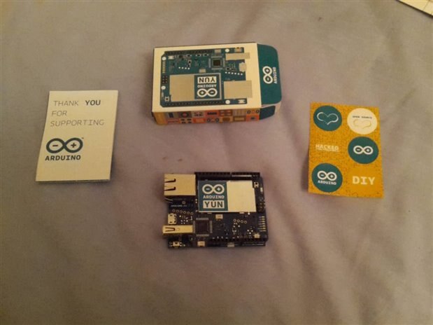

Good news, my Yun has arrived. I am not quite ready to move on to the internet side of my project, but it nice to be able to see what I am working with. On the minus side, the Ups shipping notification arrived two days after the Yun, but thankfully I was at home on the day that it arrived so there were no problems with the delivery.
