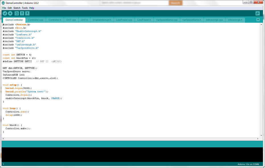

    It also means that as projects get bigger it's easier to manage. I don't put my classes into the libraries folders but incorporate them into the project. Here's what my current work in progress looks like (blinker not yet added), what you can see is all of the .ino file.
    https://github.com/Workshopshed/EnchantedObjects/tree/master/Code/DemoController
    In theory I could also drop blinker into a unit test framework. I've never tried unit testing with C++ / Arduino but it does mean that you can refactor code much more easily without worrying that you are going to break things.
