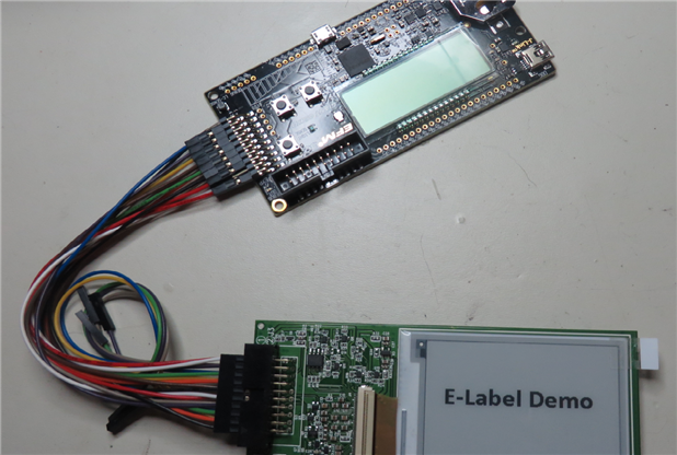

It's far too simple to be true.
The e-paper I obtained included a connection diagram and sample software to get it running.
It looked straightforward but being the skeptic that I am it seemed too simple to be true.
My inital hunch was spot on.
I followed the instructions to the letter and there wasn't enough material to get it working.
Some additional research was required.
The Connector
The first thing I noticed was that of my previous blog. The connector on the e-paper interface connector was incorrect.
Even with this now correctly resolved ....
   Nothing.
The Code
The published code sample had an IAR Workbench sample.
This had to be decoded to work out where it needed to be located in order to be compiled correctly.
The correct path is C:\Users\<xxx>\AppData\Roaming\energymicro\kits\EFM32GG_STK3700\examples\EPD Extension Board v0.92 for EMGG\iar
(Substitute <xxx> with the user name directory name for your installation)
This is not dissimilar to the standard STK3700 examples.
Even with the correct location used and successful compilation ....
   Nothing.
The Necessary Adjustments
Since the above did not work it was now time for some debugging.
Working on the premise that the published connection details and code were correct and that I had connected it up correctly (imageA very dangerous premise indeed!image);
I looked in the example code for program code constants that related to the model of e-paper that was connected.
Sure enough there was. The default model was not the same as the one I was using so I adjusted the values.
(I was using a 2.70 inch model. The default was the 4.41 inch model. - The funny thing about this was that the 4.41 inch hasn't been released yet.)
There is a constant used to define the display model number and a constant used for its corresponding example image.
ImageData.h
     #define USE_EPDType DisplayEPD270
main.c
     EPD_DisplayFormPtr(EPD_270,(uint8_t *)&Image_2_70_1);
Now with these adjustments in place ....
    The code was rebuilt and downloaded and the display worked instantly.
Here's a picture of the successful result showing the non volatility of the e-paper display.

    COMPACT over 13 years ago in reply to vsluiter
    Hi Victor,
    I purchased two e-paper modules specifically for this challenge.
    The e-paper is a raster/bit mapped device that can only have whole images downloaded to it. All graphics generation needs to be done external to the module.
    i.e. by the microcontroller or other process/device.
    To simplify this process (not that I have tried yet), the e-paper manufacturer provides a PC based program to upload text and graphics to the module.
    Cheers
    Very Compact

    vsluiter over 13 years ago
    Hey Monte,
    That e-paper demo looks really cool; did you purchase it for this challenge, or was it something you had lying around?
    Although it's frustrating to look for such a weird feature / mistake, it's nice that at least there's a driver available. Do you have a lot of possibilities in the driver (refresh, invert, write text API), or can you only upload pictures?
    Victor
    DAB over 13 years ago
    Hi Monte,
    Good job of finding the problem and resolving the issue.
    Integration is never as easy as adding A to B.  There always seems to be little bit of A plus F(c) = B.
    It does sound like they have pre-released the new device driver though.
    Anyway, good post.
