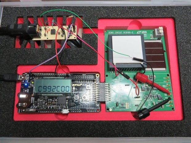

The next IDIOTic item is the parasitically powered Inverted MIDI Slave Unit.
This unit can be used for lots of different purposes ranging from just a simple status monitor or a device to control lights and the light's brightness, pan and tilt or to drive more complex items such as musical synthesizers and large public displays.
The picture above shows it displaying received MIDI messages. Great for testing and diagnostics.

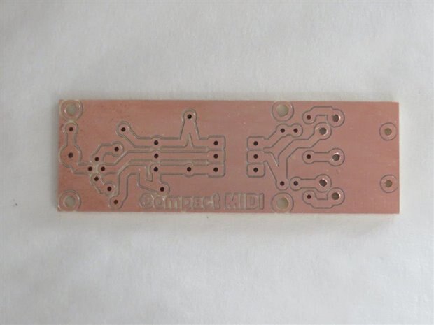

This is a picture of the MIDI interface PCB made for the STK3700.
It can been seen populated and connected in the first picture of this article.
The Current Loop energy harvester is connected in series in the current loop replacing the slave's 220 ohm resistor.
With the diode drop energy harvesting system the available power is about
P = VI
0.6 x 0.005 = 3mW.
This is enough to power to initialise and operate EFM32 on a periodic basis.
To operate on a continuous or more frequent basis more power is required.
This can be addressed from several different fronts;
     1. The inverted MIDI signalling can have its current increased by the adjustment of the inline current control resistors.
     This current should not be increased to more than 20mA to exceed the Energy Harvester's rating. I am sucessfully using 15mA (for 9mW).
     2. Power consumption of the slave unit be reduced.
     The largest burden is the optocoupler. It is currently drawing 2.3mA (@VMCU).
     It can be replaced with a digital isolator that draws about 0.3mA or other feasible option.
