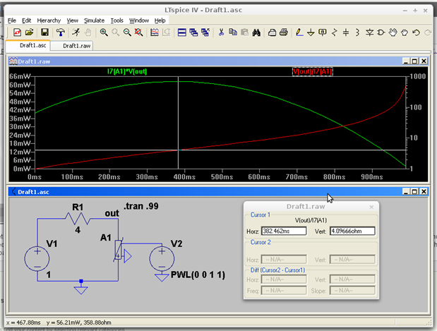

As I've seen in trying to get energy from motors and / or speakers, it is very important to match the input impedance of the harvester with the output of the energy source. I'll show this with an example of a source with 4 Ohm impedance, and 1V open clamp output voltage (for example, a motor that is used as a generator). The circuit below is 'loaded' with a variable resistor. In the plot you'll see the output power and load resistance plotted versus the varistor control voltage.
The 'maximum power point', where maximum power from the source is used is found at the place where the source impedance matches the input impedance of the harvester. Of course, in a practical harvesting application you'll want to hit this 'sweet spot', which is what the LTC3105 enables you to do.
