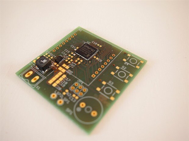

Yesterday I had everything I needed:
Components from Farnell, samples of the microcontroller from EnergyMicro, and PCB's from Wuerth / WE-Direkt  !

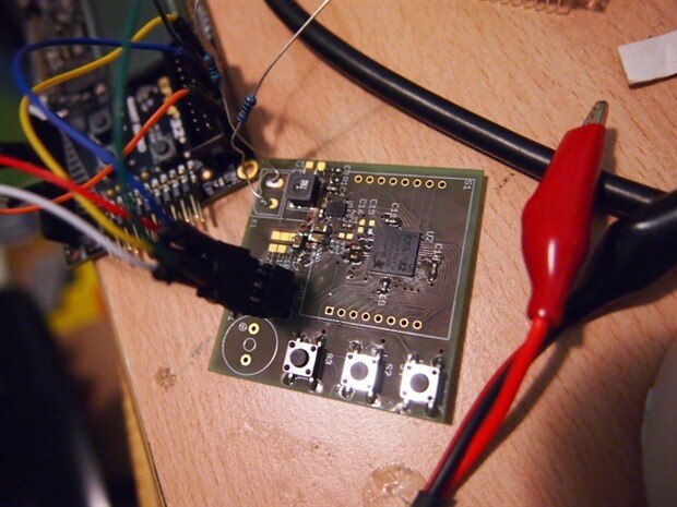

I had some trouble getting the design going. I soldered everything in place, omitting a few C's to play with startup time / energy reserve later on. I then connected the thermo electric element, and hoped I would see power getting up.... Unfortunately: no luck! I connected my power supply instead, and would only see the regulator do something  (peaking to 0.3V, then slowly decreasing again) when I would adjust the input voltage. Somehow the regulator wasn't working..
Debugging
OK. Let's try the other major component, the microcontroller. Until now, I've used the microcontroller that is placed on the STK3700, now I wanted to use the STK3700 to program an external microcontroller. I started eAcommander, and chose 'Debug Out' as option. I then noticed that I shouldn't use the signals in the lower right corner of the STK3700 (SWD, SWIO, #RESET),  but on the shrouded header, because a nice bright LED was shining next to that connector. If I had read 'application note AN002' before, I would have known that.... Now I had it connected, but had the problem that during programming I would get a popup  "Unable to read from SRAM". I looked at some posts on the EM forum (Lizard Lounge), and found that it could be that the device was locked.... For a pristine device that looked unprobable to me, but I tried unlocking anyway (button in the eAcommander), indeed without effect. I re-inspected the solder work, and discovered a small tin sliver going from SWD to SWDIO; no wonder the debug interface didn't work! I reworked those pins, and... Succes! I could program my external EFM32! I was very happy with this; with this new succes I started with new hopes on the DC/DC converter.
Debugging interface; I soldered a single-in-line socket next to the header, to use jumper cables.
DC/nothing converter......

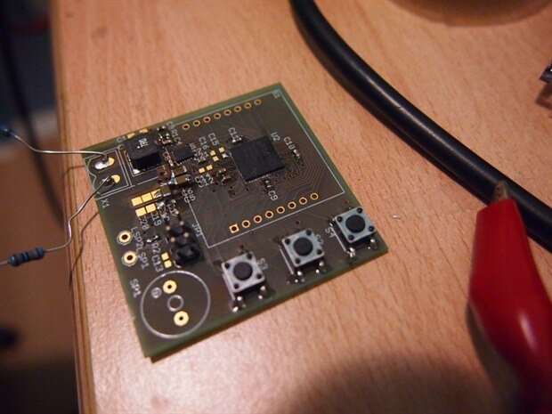

Unfortunately I had less luck here. The converter still behaved the same. Even the LDO and VAUX pins wouldn't get any voltage higher than 0.3V.... I was getting very frustrated, as no line would start switching whatever I tried... Then I thougt about the orientation of the transformer; I had already taken second looks at the layout of the demo board when I was designing, because I found the pinout a bit unclear, so I thought I'd take a second look there as well.
* Schematic? The same....
* Layout? The same....
* Placement of transformer? Different!
The transformer was rotated 90 degrees with respect to the pin 1 location on the component! I'll have to look into this when I have more time, but this was really frustrating. I desoldered the coil (luckily I have a hot air station), and rotated it. Next I applied power, and.... Nothing.
I did find out I had 2.2V out on the LDO pin, but no output on the VOUT pin. The amount of current drawn from the supply is ridiculous (40mA), so I guess I've messed something up. This is the state I left the project in last night. Tonight I'll do part two....

    I'll take a look, but I guess not since I've looked at it quite closely when rotating it. besides, the LDO and VAUX are both at 2.2V. Vout should start charging from the point that VAUX reaches 2.5V, so something is seriously going wrong there.... Of course, having a Tektronix MSO2024B at my disposal would help a lot, but unfortunately I haven't been so lucky  image
    shabaz over 13 years ago
    Hi Victor,
    (I'm just guessing) Maybe there is still a short between the inductor primary side and the secondary side (e.g. on the tracks), which would keep the primary side conducting through the internal MOSFET in the converter, which could explain the high current. Hopefully easy to check this with a multimeter.
