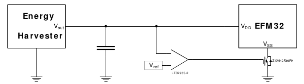

EDIT 1: Energy Micro Aplication note 0061 describes this:
"To prevent the MCU from draining the harvested energy before the energy bank has built up enough
reserves to safely power-up the microcontroller, a switch can be inserted between the harvester and the
microcontroller. Figure 2.5 (p. 7) shows a conceptual sketch of such a switch.
The full schematics of the above switch can be found on Linear Technology's Energy Harvesting Multi-
Source Demoboard. This demonstration board is paired with an EFM32GG-STK3700 and sold as an
"Energy Harvesting Solution To Go" by Würth Elektronik."
Unfortunately, I do not have a 'single' VSS pin on my device, everything is tied to a GND plane.... Let's see what I can do...
Edit2: adding a switch
Here it is: I separated the GND of the input and the converter from the input GND. I used a small FET from the energy harvesting supply board, connected it to PGOOD of the LTC3108, and now the supply charges to around 3V, and.... collapses. So somehow the GiantGecko is using too much power. Why? How? More questions.....
Edit 3:
Found out why it collapses; the PGOOD signal is only high for a few ms. need to add some hysteresis.

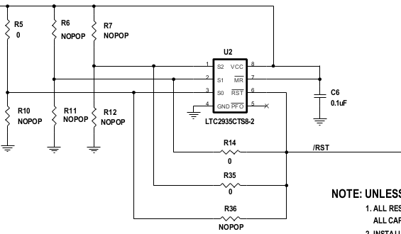

Very smart done, LT and Wuerth! Taking another look at the demo board finally gave an insight in this weird piece of schematic:
The LTC2935 doesn't look much like a comparator here, but it is! It compares the VCC to a voltage set by S0, S1 and S2. By using the nRST output of the comparator to select the threshold voltage, hysteresis is added; when crossing a voltage on a positive slope, the inputs are changed so that the threshold is now lower. When the sensed voltage is getting low enough to trip the output, the threshold is set higher.... Very nice and clever!

    First: Hacksaw is a great idea! I, in fact, do have a second board, and this could have been a possibility. But I just found out that as my converter and the powerinput are relatively close, I could just make a cut in the GND layer on the bottom.
    The development kit ( even mentioned above in AN00061) had the power switch, as an option. As far as I know this was only necessary for really low power use, whereas I have a power supply connected at the moment.... Anyway, I'm going to try to mimic this, and see what happens.
    Result: See edit2  above

    If you're absolutely sure the solution is to insert something to the VSS pin on a QFN and the ground plane, then one method (not great I must admit, but would work) would be to build half of the circuit on one PCB, and the other half on another PCB (only works if you've got a spare PCB though) and patch the two together. Or, strategically hacksaw the PCB into two pieces (a little extreme! but maybe feasible).
    But, before anything so drastic like a hacksaw, it's interesting that the dev board was able to power up the MCU without the switch circuitry. I don't know anything about the microcontroller, maybe, it is possible to adjust the config register to slow down the internal clock speed, to consume less power? It may be worth a try.
