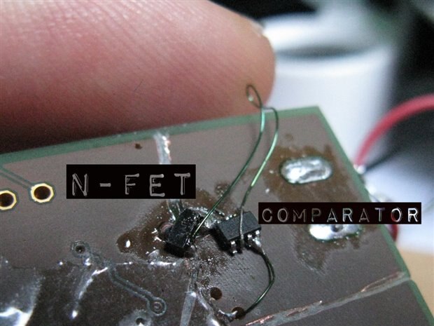

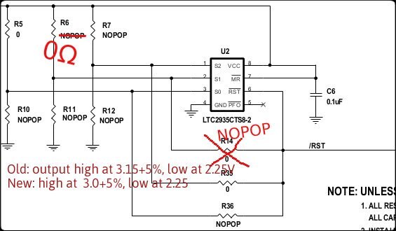

I finally got my board working, at least harvesting and going to a stable 3.3V! Yesterday I wrote about the cunning comparator circuit used on the demonstration board. Today I tried to replicate it from the schematic of the demonstration board, but the output would not turn on my FET... In despair (had I ruined the comparator?) I verified the schematic with the actual demo board and the error was clear:
The documentation did not match the populated components on the board!
In the schematic that was documented, the voltage level to trip was set on 3.15V. You'd expect the output to go high at 3.15V, then. But reading more carefully, this threshold is only for a falling input on the comparator! The rising voltage should exceed this voltage by 5%, and thus the output trips at 3.15 * 1.05 = 3.3075V. Which is not how high the regulator will get, so the output never trips.
Luckily for the engineers of the demonstrator board, they could populate some other positions to shift this level to 3.0*1.05 = 3.15V!
Please, Linear or Wuerth, update the docs! [edit: Lars Fahrbach forwarded this internally, so it'll be taken care of!]
After this fix, my board gives a nice and shiny 3.3V to the micro! YEAAAHHH!!! I can continue my project!

    e14 Contributor over 13 years ago +1
    We got the new release from LT and update the docmentaion with schematic and additonal PCB design files. You can find here the documentation: http://www.we-online.de/web/en/electronic_components/produkte_pb…
