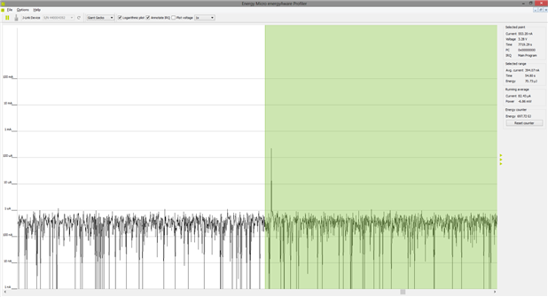

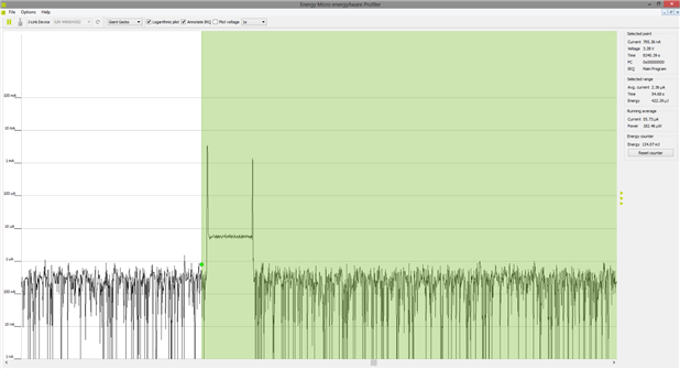

After a wake up, EFM32 checks the CO gas concentration and: if the concentration is higher than some threshold level (right how I set it on 35 ppm) or the wakeup is a result of the TEST button, the value in ppm is presented on LCD; if the TEST button was not pressed of the concentration is lower than the threshold, the result is not being displayed. Regardless of the case, the EFM32 goes into EM4 again. Below you can check two graphs, which represents the current consumption from the mentioned cases.
The average current consumption in the first case is around 2.4 uA and in the second case only around 400 nA. Is it even close to what you have guessed? In the next graph you can check the close up of current consumption between the wake up and going back to EM4 (case where the ppm value is being displayed). The whole action takes around 1.35 sec. The average current consumption in this time is around 80 uA.
80 uA is not so little for the energy harvesting power supply, but since this occurs only once every 60 seconds and takes 1.35 sec, it is bearable. Nevertheless, it could have been far more than 80 uA – even couple of mA. The reason why the value is so low is that some other energy friendly coding, functionality and other energy modes were implemented.

    From the energy modes demo I had only seen that it would just sit in EM4, and never wake up again unless you'd press reset. I hadn't realized that the BURTC could also wake up from EM4. That could be a nice feature for my project as well.
    Looking at your current graphs, I see a lot of current consumption on wakeup and going to sleep. What is the cause of that? Since your application has very long resting times you might want to take a look at the effect lowering the clock speed. Although you're going to spend longer calculating stuff, you'll be using less energy while calculating.
