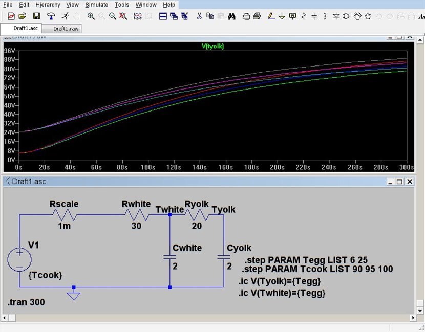

To get a good calculation of egg hardness, I'll have to integrate the heat flow into the egg. Due to shortness of development time I'll make my life simpler by just taking room temperature eggs into account (yes, I could measure egg temperature in advance, maybeI'll add that if time permits). To model the heat flow I should calculate the heat flow using the specific heat resistance and capacity of egg white and yolk. I will however do a guestimate of what is going on temperature-wise in the egg, and verify that with known cooking times...
As usual, I use LTSpice for simulations. Below, an initial guess at the variables.... In the graph you see temperature in degrees Celsius expressed in Volts, and time on the horizontal axis.
