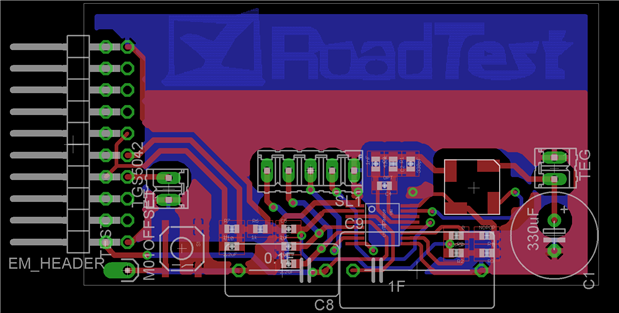

I see that everyone is finishing projects before deadline image I wanted to order a custom PCB for my project, but it takes about 7-14 days, so I decided to go back in time, when I lived in my dorm. Me and my friends were creating our own PCBs back then. The process is really simple.
  • Create schematic and PCB design.

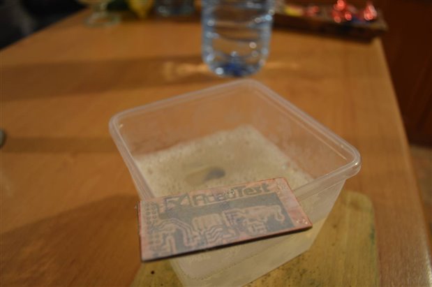

  • Soften the paper with water mixed with citric acid and washing-up liquid.
  • Peel off the paper when it softens.

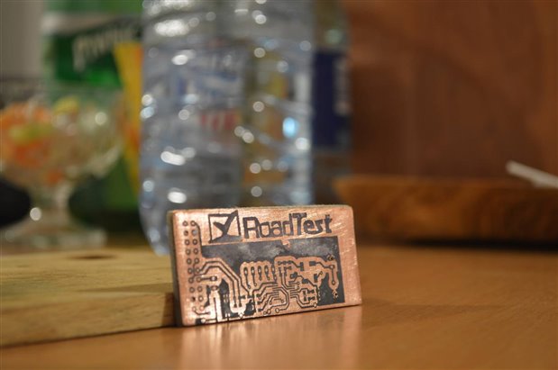

  • Etch the PCB. Afterwards remove black toner with isopropyl alcohol or sand paper.

    I usually use B327 (sodium persulfate) - be sure to keep the temperature between 35-50 oC. Back in the dorm, we had special, modified fish tank with water pump and heater. With new B327, the etching took 10 minutes in that tank. I always use sand paper to treat the copper (circular moves) and then alcohol before I iron the layers. If you are patient and you have correct ironing temperature, good laser printer and some practice, 10 mils is easy to achieve. For me the really weak part is when you have 100 vias to do by hand image That is why I only etch small boards for myself. Bigger ones I order. Although, I have seen some people who make metal vias at home.
