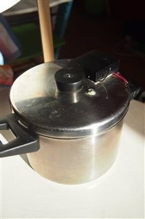

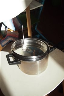

The pan
Here you can see how I prepared my egg pan; on the top I mounted the heatsink and TEG I took from the demo board (mounted as shown at the bottom of this post). I then drilled a hole through the lid, and glued the temperature probe I took from the thermometer that got dissected in another post. This is my basic setup; energy will be generated by the temperature difference between the inside and outside of the pan, and this will be used to measure the water temperature. This info will then be used to calculate the temperature of the egg that just got inserted into the water.

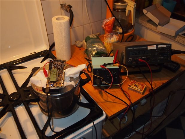

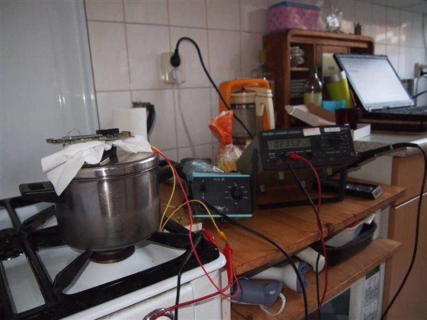

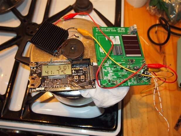

Harvesting:
And here it is; everything working together! The water temperature is 51.07°C (cooling down from cooking, very nice to see that this can already provide enough energy!), and the virtual egg yolk temperature has raised from 20°C to 41.7°C, and rising....
Phew....
I am SO glad this worked out in the end; I have been taking a look at several options for energy harvesting, and most of the times I was pretty disappointed to see the hurdles I had to take. Maybe this subject was just too hard to get a good prototype design in just 2 months. I would have loved to make a custom PCB with the needed electronics on it, which would be about the area of the heatsink, instead of bulging across the lid of the pan. In the end I chose to use the LTC3108 over the LTC3105. The latter has a nice option for matching the input impedance, and is able to generate a higher output current, but fortunately I can use the LTC3108 because the energy requirement is so low. The benefit of the LTC3108 for me is that it starts at a lower voltage.
