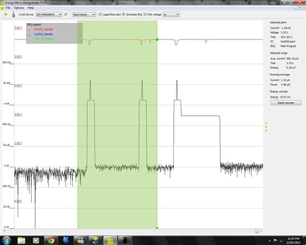

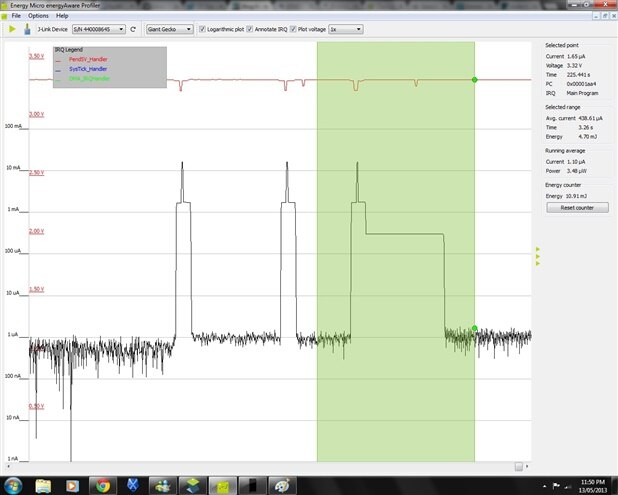

The sensor gives has an RGB led to let you the different levels of moisture at a button press. So I of course soldered on my own button which will be connected to a digital output pin later and some wires on the battery terminal and connected it up to the energy profiler to see how much power it would take. Also really liking the upgraded energy profiler that gives you nice little calculations box on the side.
Calculations done on the system for how much power a reading took. I like the led light up so would like to keep it on there.
2 button pressContinuous press
Avg Current566.16uA442.68
Time3.22s3.26s
Energy6.2mJ4.7mJ
figure one 2 button presses
figure button pressed and held down

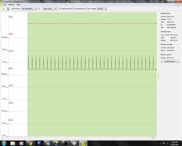

I then found out that the sensor could be left on if I held down the button for a while so did a longer time period of 180s
     Sensor on for 180s
Each of the spikes is the led blinking. So if I was lazy and just had the sensor on all the time it would consume on average 443.27uA constantly while during the day I think I could get a way with it. It is both unnecessary and wasteful to do so.
