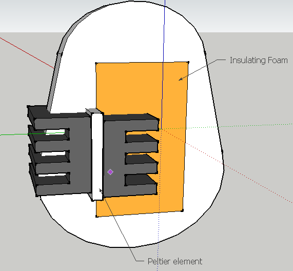

I wish I could be more positive in my blog posts, and I think I will be towards the end of this design challenge. However, at this point I meet the REAL challenges of power harvesting; that it isn't as simple as I thought it would be. I recently wrote about my turnaround from harvesting from motion toward harvesting from temperature difference. The thing I had in mind for some time now was the 'Energy Harvesting Gadget' (EHG), which in my mind would be an egg shaped device that would harvest energy from the heat of the water surrounding it to generate energy.
The cool thing would be to use the power of the EFM32 to calculate the time needed to cook an egg, some very interesting formulae are available.
Now towards the design, the sketch below shows what I had in mind:
The peltier element would harvest the energy from the temperature difference between water (rising to 100 degrees Celsius) and the insulating foam which would start out at room temperature. Inside the foam a PCB would be placed that would sense the water temperature, and an EFM32 would be able to calculate the 'hardness' of the egg.
Why it won't work
Nice idea, ey? Unfortunately it will not be able to harvest energy for a long time. I started reading a few days ago, and found a great article on the subject of energy harvesting wilt thermo-electric generators - [pdf] from the AHG University in Poland. One of the things I hadn't realized is that Peltier elements are also very good thermal conductors. Which is in a way very logical since they're supposed to be heat pumps, I just hadn't realized it would mess up this application / idea. When you're heating up the water, both sides of the peltier will very soon have the same temperature, and no energy can be harvested anymore. Bummer. Back to the drawing board.

    I dont't think Peltier is a dead end, I think the way I wanted to use it was not unitable with physics image
