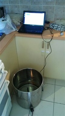

So I received my board this week and it has been fun. Got the software installed and ran some of the examples and they worked great but then got to thinking about the project. I also showed it to the sustainable engineering lecturer at work and had to make sure he didn't leave my office with it.
Trial

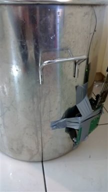

I decided to place the system on my brew pot while I did a batch of beer to see if the energy harvester would continually run as I was worried the peltier plate and heatsink would end up heating up too much and no longer work.
My highly technical attachment set up it wasn't meant to move so duct tape.
The pot is only half full so placed the Unit down the bottom and realised I should really make a cable so I can see the LCD screen and if I have a boil over on a larger batch it won't destroy everything.
Results
The trial was a success with the heatsink while getting into the 30s (room temp was 22) was still a giant gap in heat compared to the 62 mash temp. Only problem was the energy aware profiler did not like me trying to log for that long and promptly crashed when I went to save.
The system during the heating and boiling is not really harvesting wasted energy as the heat element has to work for longer the mash temp was not noticeably affected by the unit being attached with temperature staying fairly stable over the 1 hour without the element on.

    Hey DAB,
    Yeah I normally have a foam mat wrapped around but wanted to connect up device so went back to the blankets I had before.
    Victor,
    Yeah the added value for me in brew stage is little as I have an electric element and can use it inside until I get in to much trouble for the mess it makes. My friends and others though have to brew outside with propane gas so don't always have easy access to power points and they also thing it is a bit crazy to move so much water around 240V power cables people and their safety standards. Then in fermentation stage I have everything kept in a cupboard covered in insulation so would like something wireless just need to see if I can get enough power from fermenting heat and CO2 blow off to do that maybe pole the specific gravity once a day to see if fermenting is done.
    The plant wall is something that could benefit more people as I've noticed a lot of balconies here in Australia don't have powerpoints and people aren't great at remembering to watering plants.

    Hi Sean,
    Have you thought about wrapping the pot with some insulation?  A good fiberglass bat would help slow the temperature loss to the air from the metal pot skin.
    Just a thought,
