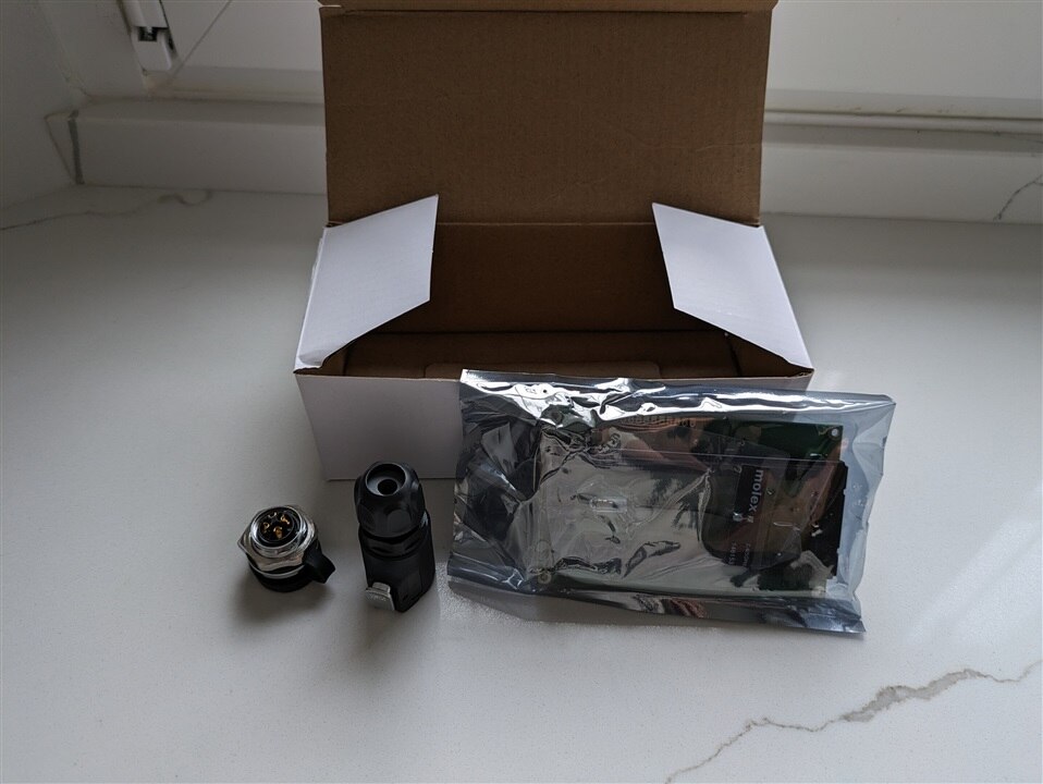

MIDAS LCD Display
Another component included in the kit is a LCD display by MIDAS, specifically the MC42005A6W-SPTLYI-V2 model. This component is shown in Figure 3.
Figure 3. MIDAS LCD Display, connectors, antenna.
It is a LCD display that can be driven by I2C. I have not tested it yet, but as my project will be using Python, probably the best idea will be to use the library already developed by javagoza .

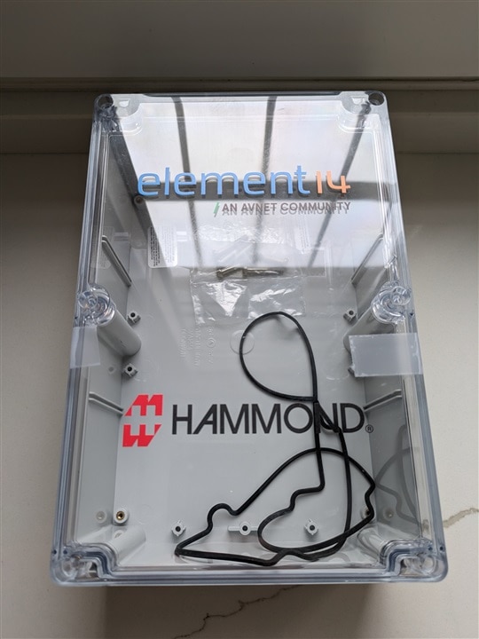

Hammond IP68 enclosure
This is the key component kit of the challenge, as it will be the one in charge of enduring the extreme conditions. The model of the enclosure is the 1554VA2GYCL, it is rated as IP68 so it should be protected against dust and also be suitable for permanent submersion in water. The enclosure is presented in Figure 4.
Figure 4. Hammond IP68 enclosure
Farnell product page describes it as follows:
"The 1554VA2GYCL is a watertight clear lid polycarbonate Enclosure ideally suited for mounting printed circuit boards or DIN rail mounted components. The clear polycarbonate lid allows for maximum visibility of protected internal components. It has gasketed lid with two piece tongue and groove construction provides protection against access of oil, dust and water. The lid is secured with self-captivating - M4 stainless steel machine screws, threaded into integral stainless steel bushings for repetitive assembly and disassembly. Stainless steel hardware is used to avoid corrosion caused by dissimilar metals."
Miscellany
The other components included in the kit are two circular connectors, which allow us to power our prototype while still being able to ensure protection. I must point out that the connectors are not IP68 but IP67, which means that they will only stand immersion up to a depth of 1 m for up to 30 minutes. These connectors are made by AMPHENOL COMMUNICATIONS SOLUTIONS.
The RF Antenna model 146153-0050 by Molex is suitable for different communication protocols like Wi-Fi, BLE, Thread, Wireless Hart or Zigbee.
All these components are presented in the previously depicted Figure 3.
