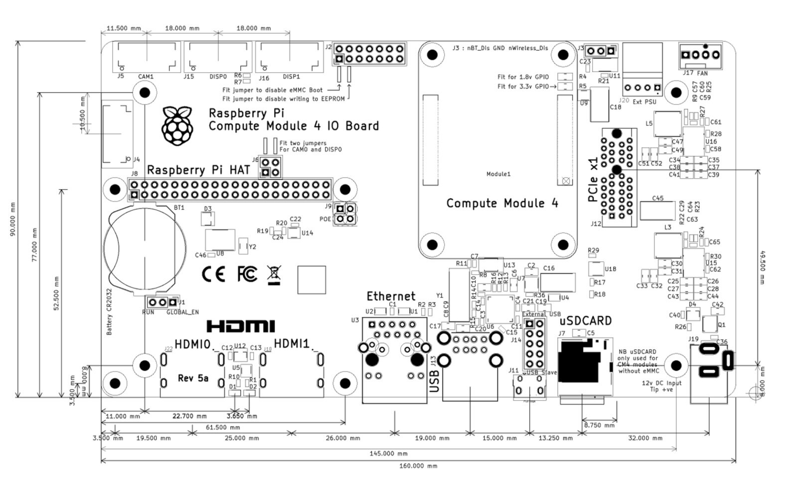

RPi CM4 and CM4 IO
The combination of the CM4 and CM4 IO boards creates a development platform that has a superset of the features of an RPi4 Model B.  The specific CM4 module that we received does not have eMMC and has WiFi so for the feature set that I'm using for this project I should be able to do most of the software development using an RPi4 and just move the uSD card to the CM4 IO.  At least that's my current plan.
\image
CM4 Compute Module
The compute module in the kit is a CM4104000 which means it has Wireless, 4GB of RAM, and no eMMC (uses uSD card).
CM4 IO Board
The IO board has quite an expanded feature set than the RPi4 Model B, but for my project I'll be using the following limited set of features:
  • +12V DC power Input (+7.5V to +28V possible - the charge controller source will be +11V to +15V)
  • Camera CSI port
  • uSD card slot
  • 40 pin GPIO connector (UART, I2C, GPIO Interrupt)
  • RTC
Here's the complete Feature list:
  • Accepts the complete range of CM4 modules
  • External +12V PSU
  • 2 × Full-size HDMI 2.0 connectors
  • Gigabit Ethernet RJ45 with POE support
  • 2 × USB 2 Socket, with header for two more sockets
  • Micro USB socket for updating the CM4
  • Micro SD Card socket for CM4Lite modules
  • PCIe Gen 2 socket
  • Standard Fan connector
  • External power connector (+5V, +12V)
  • 2 × MIPI DSI display FPC connectors (22pin 0.5mm pitch cable)
  • 2 × MIPI CSI-2 camera FPC connectors (22pin 0.5mm pitch cable)
  • Raspberry Pi HAT connector
  • RTC with Battery socket and ability to wake up CM4
