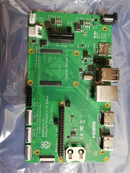

Raspberry PI unboxing
In this challenge, Sponsors and Element14 were so kind as to give us some good quality hardware to make our experiments. Those components will be described in more detail in the following material, starting with Rasoberry PI SBC.
As of active components, we were granted:
  • Raspberry PI Compute Module 4,
  • Raspberry PI Compute Module 4 IO Board,
  • Molex internal 2.4GHz/5GHz antenna

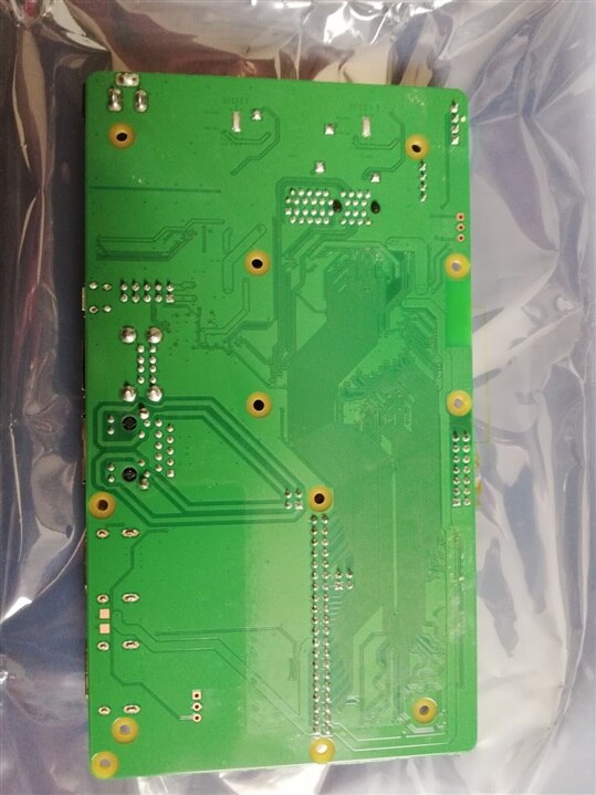

They have arrived (with other components consisting of design kit) well packaged and (in the case of Raspberry PI boards) inside colorful retail carton boxes. Below are some photos of these components:

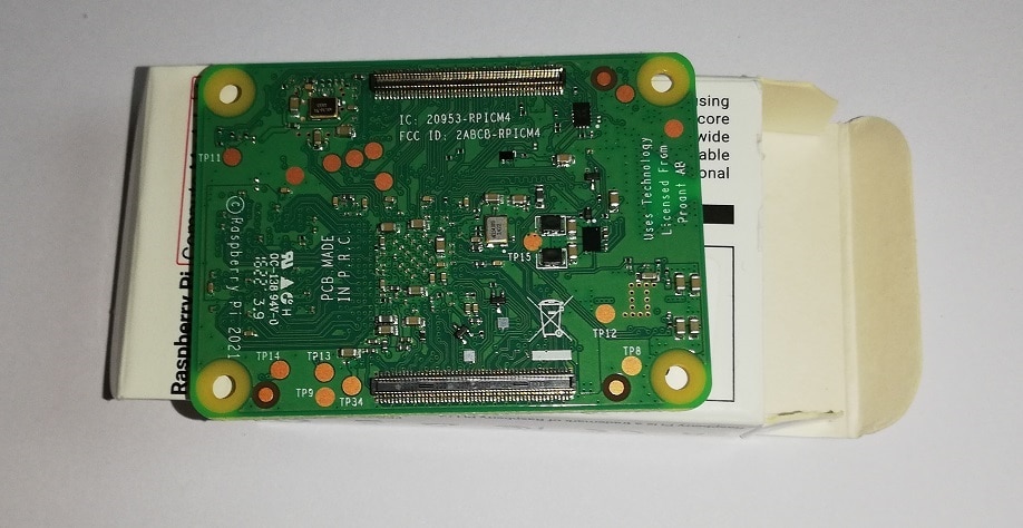

{gallery}Raspberry PI unboxing
compute module - side B
What is interesting is the fact that the compute module has arrived without any sort of anti-static bag, but despite this fact is working correctly - maybe some additional ESD protections are builtin?

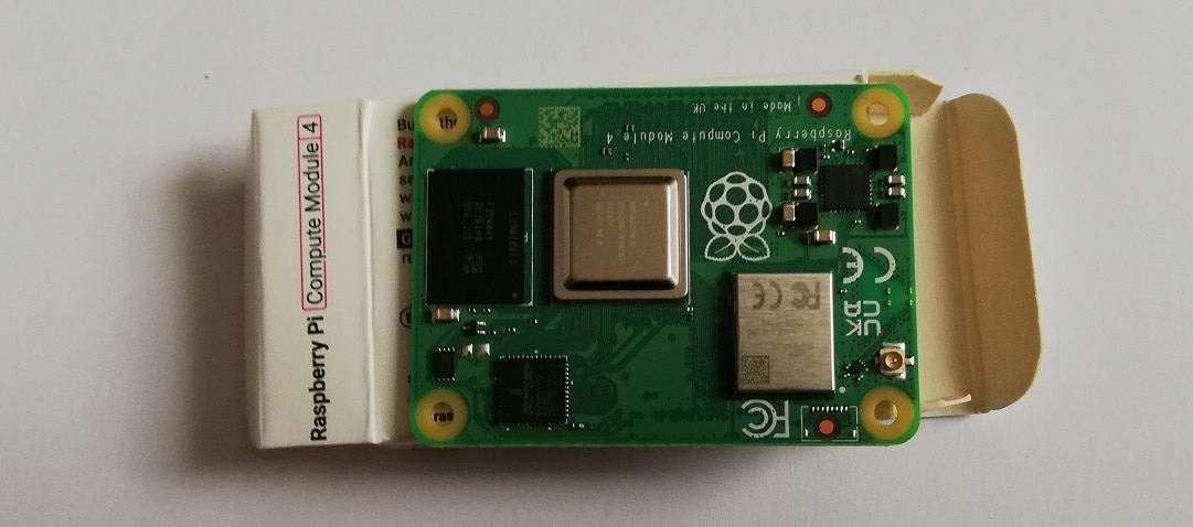

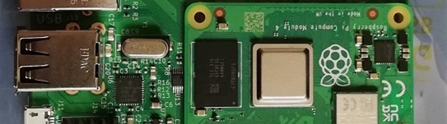

Raspberry PI Compute Module 4 (CM4) can be treated as a Rasberry PI 4B but in format suitable for installation inside other products. In the package of 55x40mm it includes:
  • 4 core, 1.5GHz Broadcom BCM2711 ARM Cortex-A72 SoC,
  • 1,2,4 or 8GB of RAM,
  • 0 - 32GB eMMC,
  • optional 2.4GHz/5GHz WiFi, Bluetooth 5.0, BLE interface,
  • Gigabit Ethernet PHY,
  • PCIe x1 interface,
  • 1x USB 2.0 interface,
  • 28 GPIO pins,
  • SD card interface (for variants without installed eMMC memory),
  • dual HDMI,
  • two display (DSI) and camera (CSI) interfaces,
and is designed to work in -20°C - +85°C temperature range.
As CM4 is not meant for standalone deployment, CM4 IO Board was also provided. It is working as breakout board for compute module, with some additional hardware:
  • power supply (specified for input 12V, but only when powering with 12V PCIe connector, external 12V output or a fan strict 12V is needed - in other cases, wider range of input voltage can be used: 7.5V - 26V),
  • 4-port USB 2.0 HUB (with two ports accessible on the header) - disabled to conserve power by default,
  • MicroSD socket - only for compute modules without eMMC builtin,
  • fan connector,
  • Real Time Clock with battery backup and the possibility to wake up powered down CM

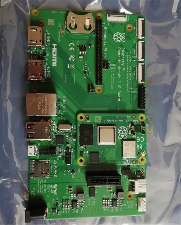

Compute Module provided is an CM4104000, which means
  • radio module installed (CM4104000),
  • 4GB RAM (CM4104000),
  • no eMMC builtin (CM4104000),
Module installed on IO board looks as below:
cm4 and io board
and the question that's need to be addressed is - does it require a heat-sink (especially given many models of heat-sinks offered for CM4 and the popular opinion that Raspeberry PI's generally need them)? We will try to discover...

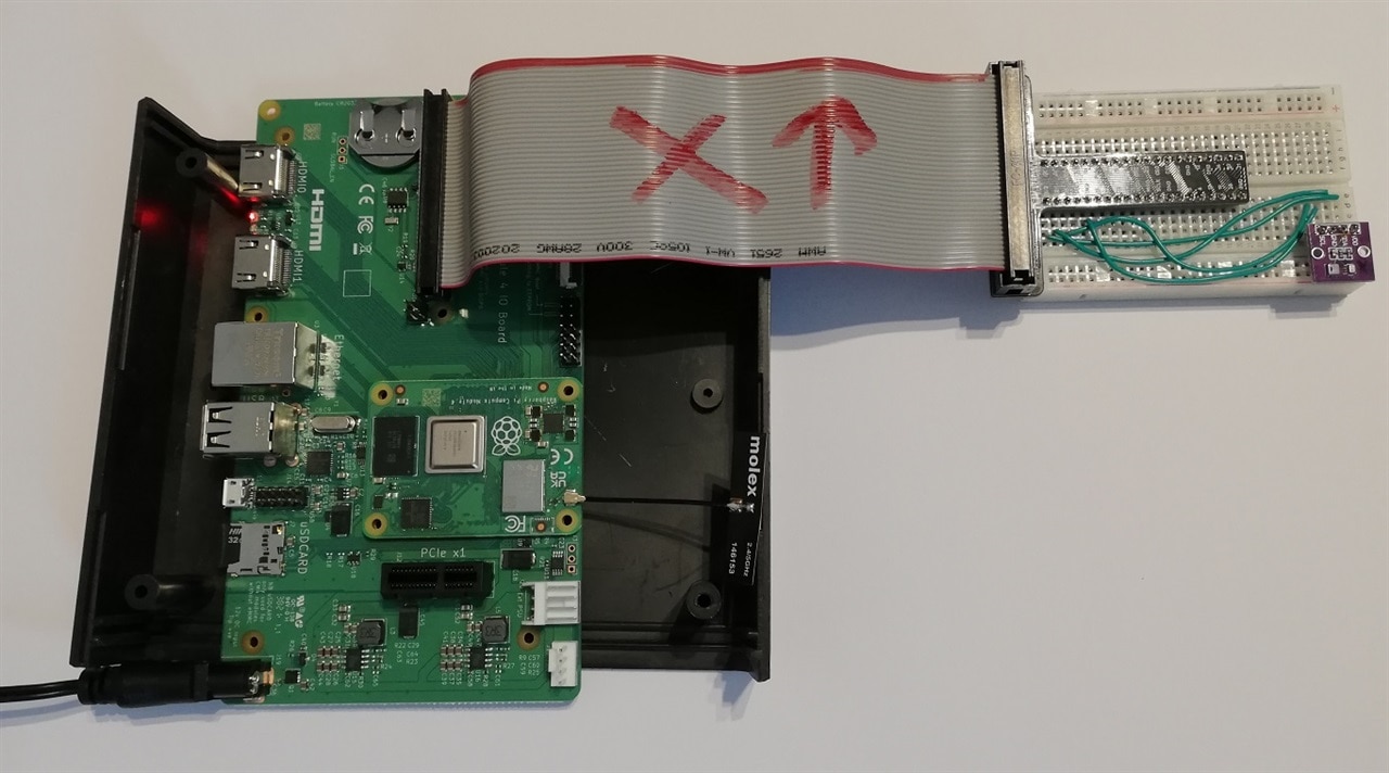

External temperature sensor was installed on prototyping board, connected with GPIO header of Raspberry PI IO Board
temperaure sensor
and a trap was encountered - before sensor installation, supply voltages on breakout board were measured and turned negative (-5V at 5V rail and -3.3.V at 3.3V rail) - after some checking it was made evident that connector cable was faulty (red line was on opposite side than first pin indicator, which have reversed all the pinout). Final config has included faulty cable indication as below:

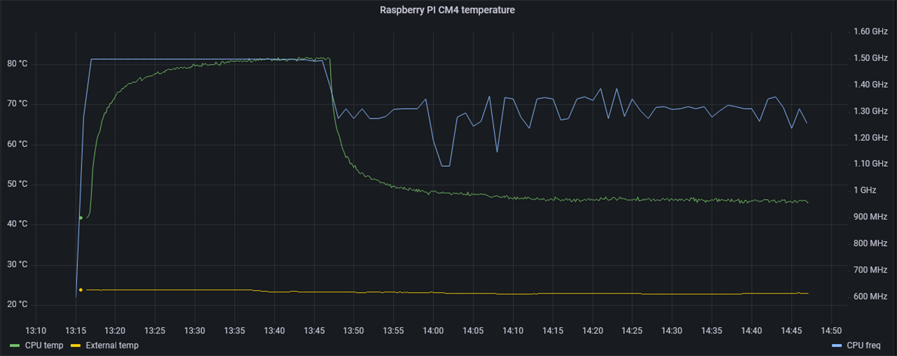

Open case test

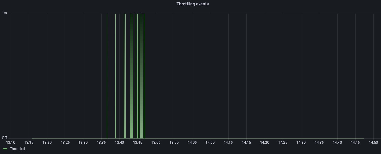

To get some baseline and verify if heatsink needs to be acquired, initial tests were conducted in open case configuration, when board was only protected by the top and bottom parts of enclosure, with free airflow through the sides.
Test was conducted by running stress load tester on all four cores for 30 minutes, using following command:
$stress -c 4 -t 1800
open case temperatures
open case throttling events
as can be seen, throttling threshold is set at about 80°C, throttling events are rare and short, CPU temperature stabilizes at 80°C without the need of visible clock frequency reduction, so it seems that CM4 can be run in open case without heatsinks and it's performance isn't affected by excessive temperature.
