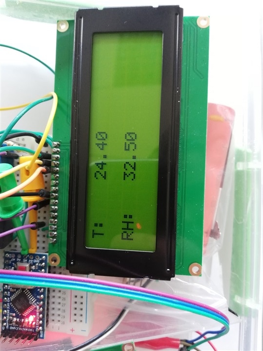

To obtain a reference, displays at room temperature were examined. First, our reference module
room temp - reference LCD
one can notice uneven backlight - not that noticeable in real operation but evident on the photo. Then - our test display:
room temperature - Midas
as can be seen, backlight with series 33Ω  resistor is barely visible, but equally distributed on the whole LCD surface. Fonts are sharp and background is not visible.

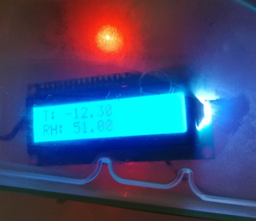

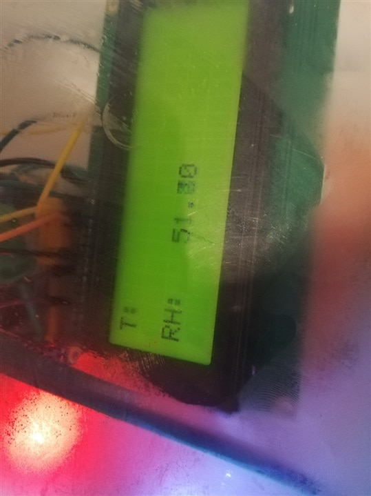

As our test display is specified to work at the temperature range -20°C ÷ 70°C, it was put to the freezer next. After some time, enclosure was removed and display quality checked (initially without opening the box)
freezer - reference
freezer test display through the lid
as can be seen, something happened to temperature measurement on our test display, but otherwise both are working correctly and fonts are readable, but the lid somewhat obscures the view. So - let's open it (and observe resulting condensation)
freezer - open lid
as can be seen, temperature reading has returned (probably there was a problem with parameters of calling floating point printing function - when resulting text was going to be too wide, it refused to write anything).
As a side note - we can see relative humidity reaches 100% and condensation form (not very visible on the photo, but both displays were quickly covered in ice forming from condensation appearing on cold surfaces - by the way, that was the effect I always wanted to obtain in Waterproof/Extreme challenges). Another observation is that display refresh slowed in noticeable way - one could see when characters were redrawn one-by-one.
After a while, image on the reference LCD deteriorated, probably because of the water inducted leakage
detoriated display
but this problem was not observed in our test display. Fortunately, after powering-down and letting them dry, both displays were operational again.

After the test we have learned that both reference and tested displays can operate in the temperature range of -12°C ÷ 40°C displaying readable text (without requiring contrast correction), but in low temperatures their speed is visibly impaired, that could be problematic for some types of user interfaces (for example menu based).
