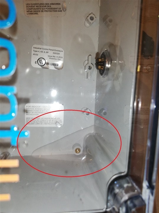

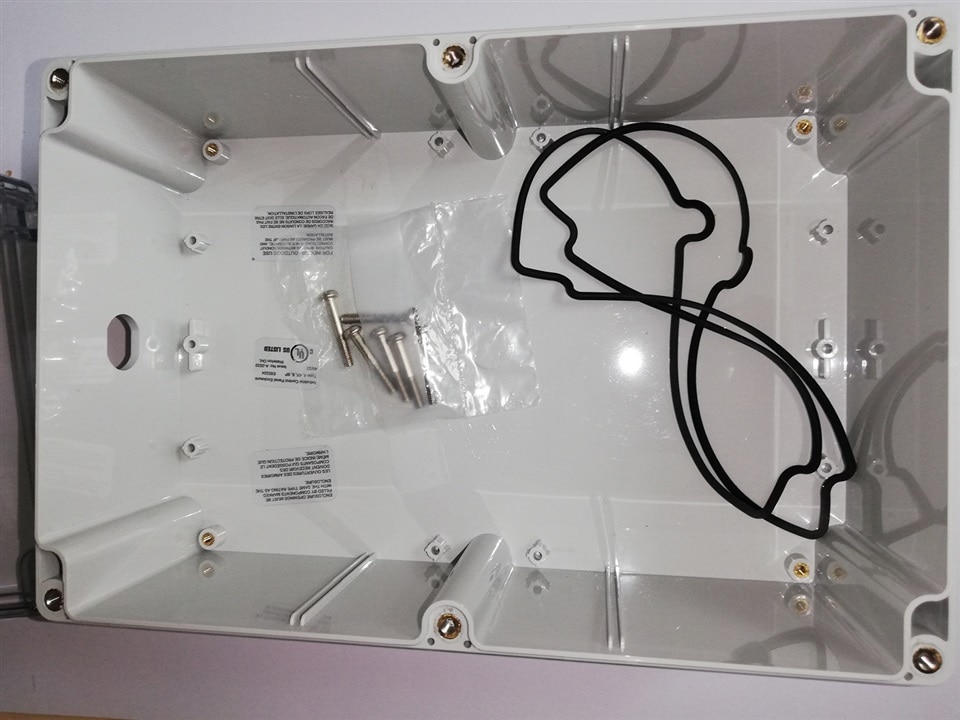

Enclosure internals are shown in the next photo
enclosure internals
and sport features like:

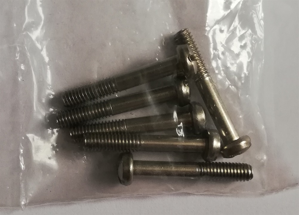

  • self captivating screws (you will never lose screws again by putting removed lid upside down),
  • threaded bushings not only for the lid, but also for the components inside (which enables frequent opening without the fear of damaging the enclosure by re-threading plastic parts that is possible in some budget enclosures where screws are inserted directly into holes in plastic walls),
  • profiled gasket for installation in "tongue & groove" type construction for additional protection,
  • vertical PCB guides for alternative component mounting options,
Our version is made of polycarbonate (there is also ABS variant for indoor use) and is UV stabilized for outdoor use. It is also IP68 rated - there are similar enclosures (but with four screws), which are NEMA 4/4X only - there was a long discussion about this last year, but the manufacturer's support finally clarified that "Except 1554/55 V size which is 4,4X only" is about only 4-screw variants.
Self-captivating feature can be better seen on the photo following:
screws
as can be seen, threaded part is thicker than the next section, so - during the initial installation - lid openings get threaded and then screws stay in place even when the lid is turned upside down.

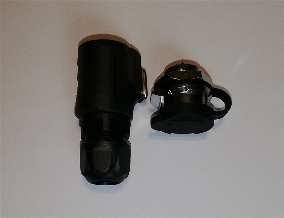

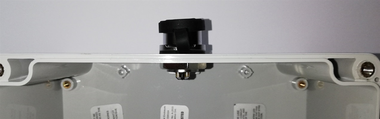

Connector set
Next part of our challenger's kit is an connector set, consisting of 4-contact socket and the matched plug.
{gallery}connector set
connector 1
connector 2
connector 3
This connector belongs to the IP67 rated MRD Rugged Circular Locking Connector series by Amphenol ICC and features four contacts and metal latch lock.
One thing worth mentioning is the condition of IP67 rating - it is usually specified for "unmated condition unless otherwise  stated", and here such statement is present: "IP67 in the mated conditions water/dust proof" - hence the rubber protection cap for the socket to protect it from water ingress. We will test it shortly.

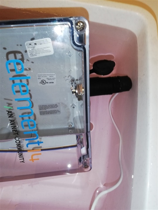

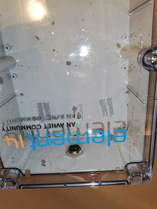

As our enclosure and connector is rated to at least IP67, our next test will be water immersion. First, container with dyed (to make eventual leaks more visible) water was prepared
dyed water test

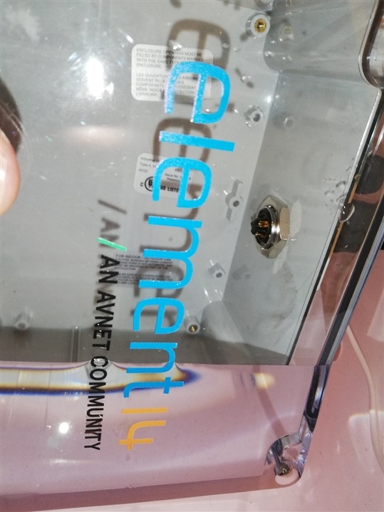

then connector was installed in the enclosure:
socket installed
and the first test - water immersion of enclosure without a plug attached and with protection cap installed. As can be seen, no air bubbles after initial immersion are visible (which would indicate water leak) and the enclosure interior is dry after the test.
Immersion test - ok
Then some tests with the plug installed but using the cable of improper diameter (giving opportunity for water to enter the plug at the cable entry point) which proven indecisive:
{gallery}Indecisive test results - plug but no sealed
cable test 1
cable test 2
cable test 3
and finally immersion test with protective cap removed and without the plug. This one is negative as expected and proves than cable installation should be done in adequate conditions because during it enclosure assembly is not guaranteed to be waterproof
water leak after test

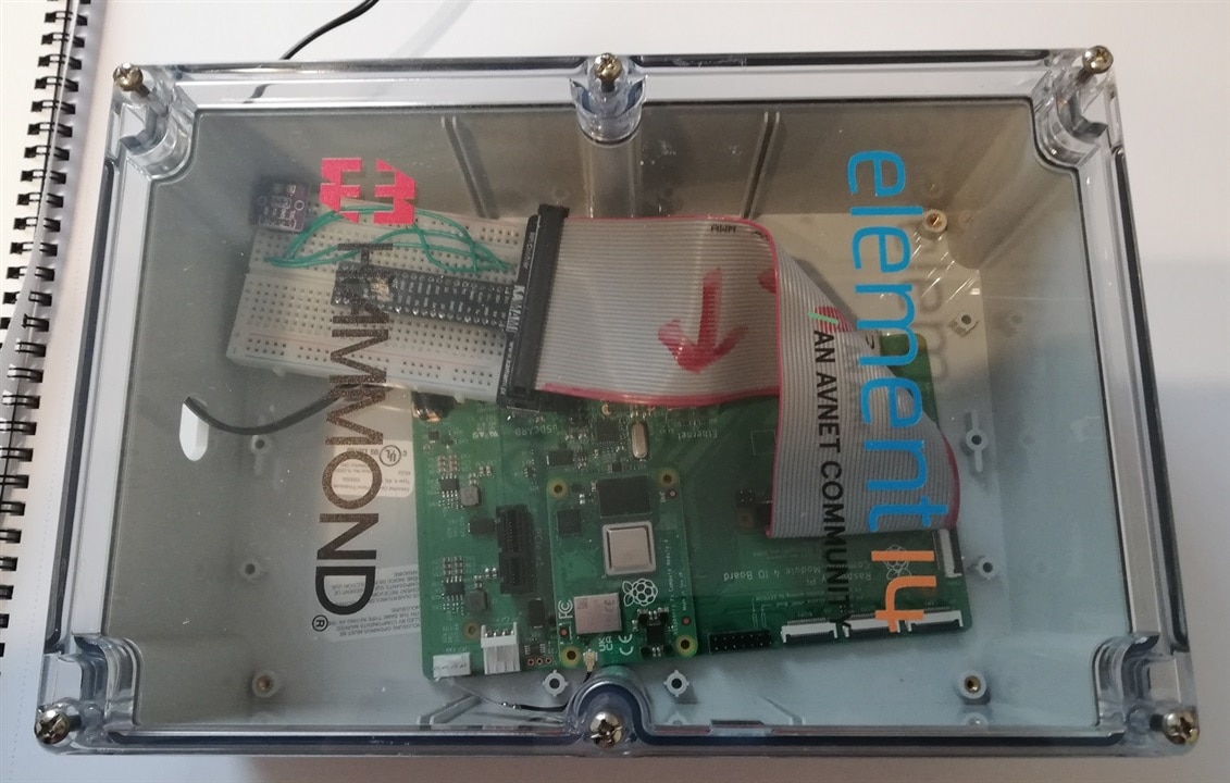

To asses how the installation inside of waterproof enclosure is worsening thermal operation of the Raspberry PI, stress test were repeated.
Raspberry PI board was put into enclosure operated indoors at room temperature and stress tests were repeated (in some stages as the test procedure was adapted after analyzing intermittent results - for example, enclosure sealing was examined to prevent stray air exchange).
thermal tests preparation
Load test was executed - as in previous case, using four (the number of CPU cores of installed SoC) workers, aka hogs for half an hour

First results indicated something like slow but constant temperature grow inside of enclosure (and proportional idle CPU temperature increase) - not good
preheating

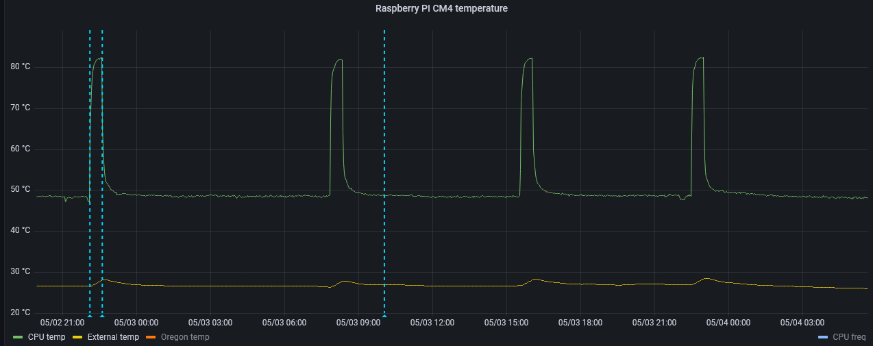

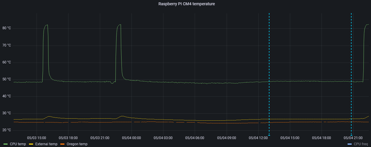

as temperature increase seemed constant but slow, some stress tests were executed first (to asses if it is going to cool itself between tests), then external temperature monitoring was added to take into consideration slow changes of ambient temperature
initial stress tests
after adding external temperature sensor (orange line below), it has been made evident that the enclosure (during low CPU load) is operating at about +1.8°C above ambient and it relatively quickly cools down after brief high CPU usage period
external temp sensor

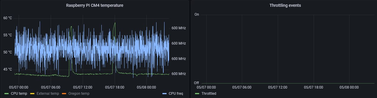

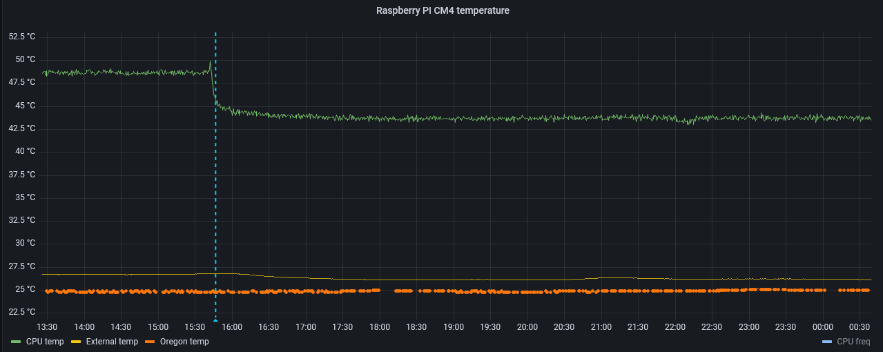

After than change, temperature reduction was observed. Not only enclosure temperature in regard to external temperature have dropped to about +1.2°C, but mean idle CPU temperature decreased about 5°C
powersave mode on
This change can be attributed to CPU frequency change: not only during idle operation it was reduced from about 1.3GHz to 600MHz, but also during stress tests it have stayed the same, limiting heating and eliminating throttling events.
stress test during powersave mode
