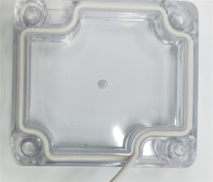

As comparation, Here is another so-called water-tight enclosure with round rubber band,
Put the gasket together,
look close to compare the section
The installation of the gasket is totally different, for the comparing white one, the rubber line shall be overlap and cut, small gap is inevitable,
The result can be obvious, the IP grade can be different.

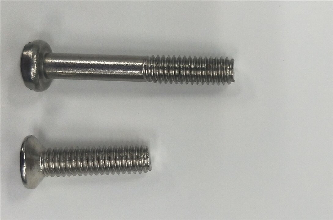

3.2 screws
There are four screws to fix the front lid and bottom box, take close look to the different
The spiral is not throughput for Hammond IP68 Enclosure, Let us go to the two small video clips
And
This can secure the screw from scatter during assembly.

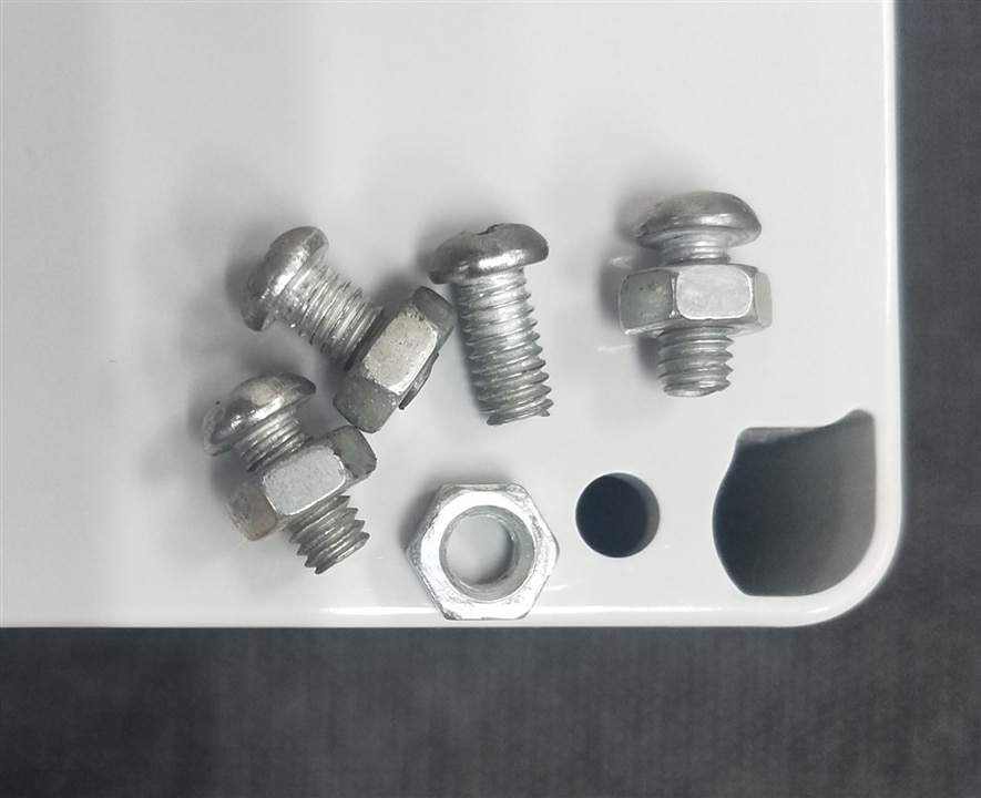

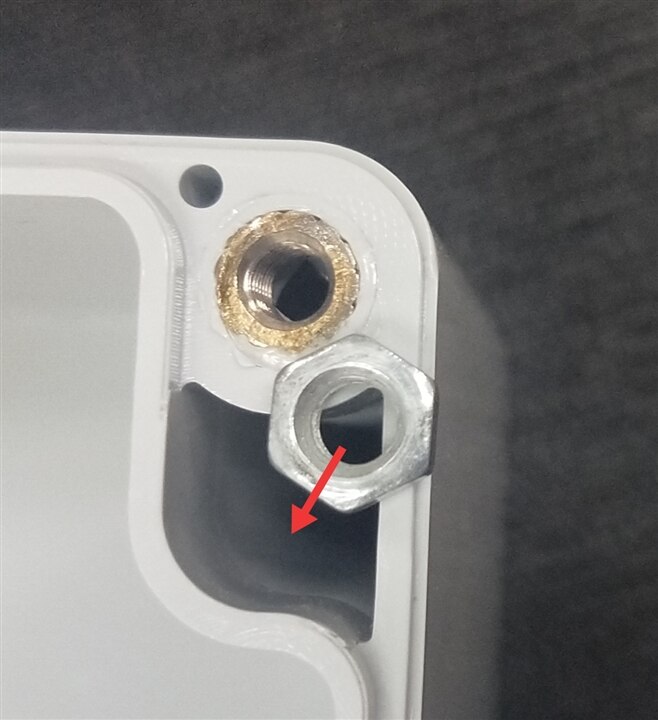

Another screw for the enclosure fixing, four screw and nut sets shall be used
Put the nut into this slot
With the help of one pencil, it can be tightened
This  different from fixing solution by Hammnd(1554FOOT WEB INSTRUCTION) not included in DEV kit, which is much better
