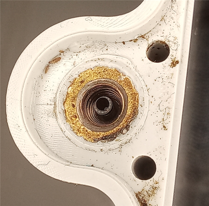

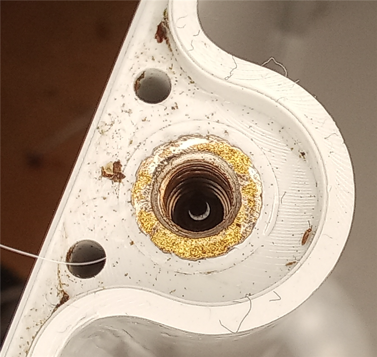

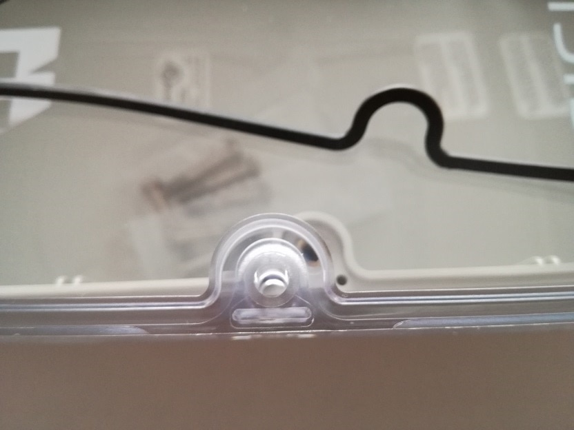

When I signed up for this challenge, I didn't think one of the conditions i should account for when testing the Hammond enclosure would be life growing either in it or on it, but both plants and animals made this enclosure their home:
The enclosure spent almost a month continuously outside, exposed to direct sunlight and rain, on the sunny days, the sun shone on it for about 6 hours, and when it rained, there wasn't anything between it and the clouds to shield it from the water either. When I took it inside this week to complete this project, I found it as you see in the picture above, covered in algae on three sides, and when I took a closer look, I also saw some tiny little creatures living in the lip under the lid:
When I opened the enclosure, a very strong chemical-y smell hit me. That was unexpected, since the enclosure's datasheet mention it being UV stabilized. The smell was definitely plastic-y, but since there were other plastic things inside(cables, heatshrink tubing, pin header separators) I'm going to trust it wasn't the enclosure decomposing but one of those other things, since they don't have any UV rating that i could find.
Another thing I found interesting was what happened to the stickers inside the enclosure:
It's clear the stickers were affected by the conditions the enclosure was subjected to, so let's take a look at what those conditions were:

    Anthocyanina over 2 years ago in reply to JWx
    yeah, it's likely, since the plastic material on the cables was PVC. I think with this finding, anything that goes inside the enclosure must have some UV resistance rating, if the enclosure is to be placed in direct sunlight. Now I want to get a pair of UV sensors to compare how much UV gets inside the enclosure vs how much hits the sensor directly outside. I guess the plastic used for the lid is mostly UV transparent
  • JWx
    JWx over 2 years ago
    and about chemical smell - I have observed this also,it seems that after heating to the high temperature ( ~ 80 deg. C in my case), there is a strong smell of resin from the laminate I used (cheap, paper based one). Maybe in your case some material was damaged by the temperature, giving off not only chemical smell but maybe also some kind of solvent that have damaged stickers?
  • JWx
    JWx over 2 years ago in reply to Anthocyanina
    for them it is something like living under the rock Slight smile it seems you have much better environment for this challenge than many participants...
  • Anthocyanina
    yes, they are still outside the enclosure, but I didn't expect anything to bother to go inside that space and set home in that very small space. I would say barren space, but evidently plant life found a way there too! goes to show how important a gasket is for enclosures like these, had it been just a press fit hard plastic on hard plastic, i'm sure little critters would have made their way inside!
  • JWx
    If I see correctly, those animals are technically on the outside - gasket goes on the inner edge of the screw mounting area:
    gasket area
