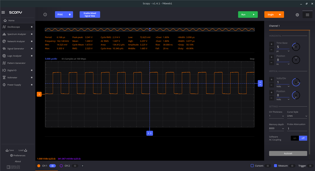

This code can generate a PWM frequency of your choice and you can also set the duty cycle using these two functions pio_pwm_set_period() and pio_pwm_set_level().

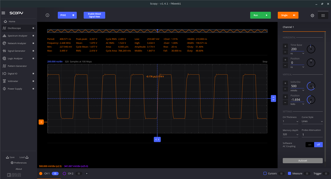

And here is a 162kHz PWM frequency with a 50% duty cycle seen on the assigned GPIO:
Success!
I now had a simple means of generating high speed PWM signals in a normal low voltage safe environment.
I could now move onto the next part of testing out some MOSFET’s using this PWM signal, as a switch, to see what happens to the voltage levels across the source of the MOSFET and ground.

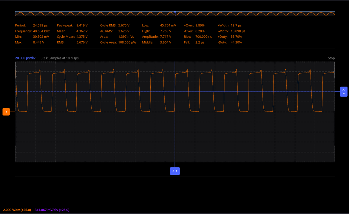

Switching MOSFETs using +100kHz PWM signals

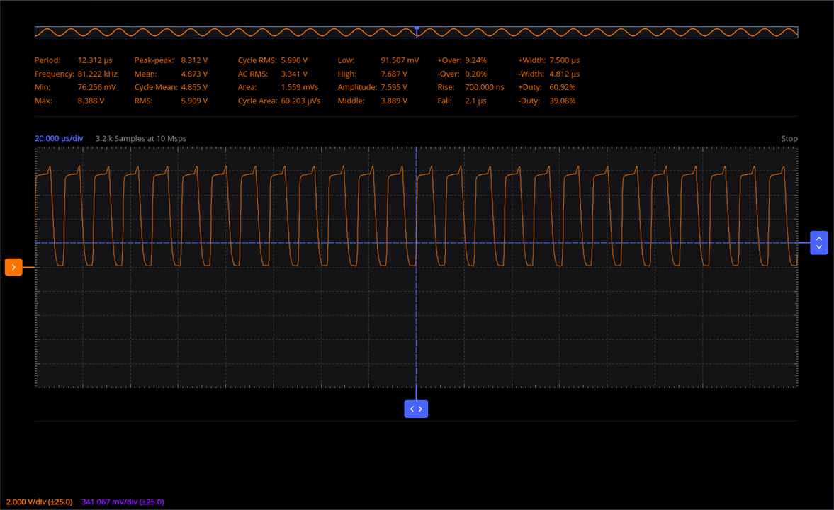

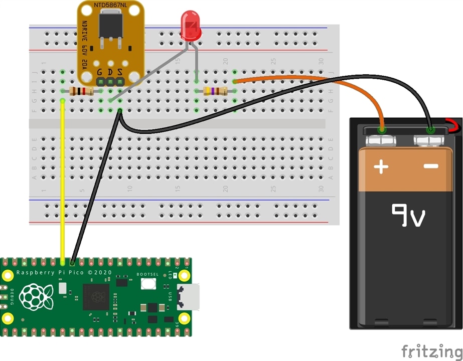

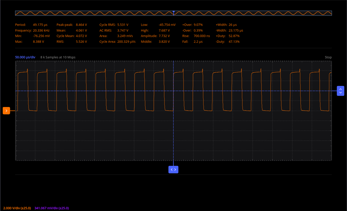

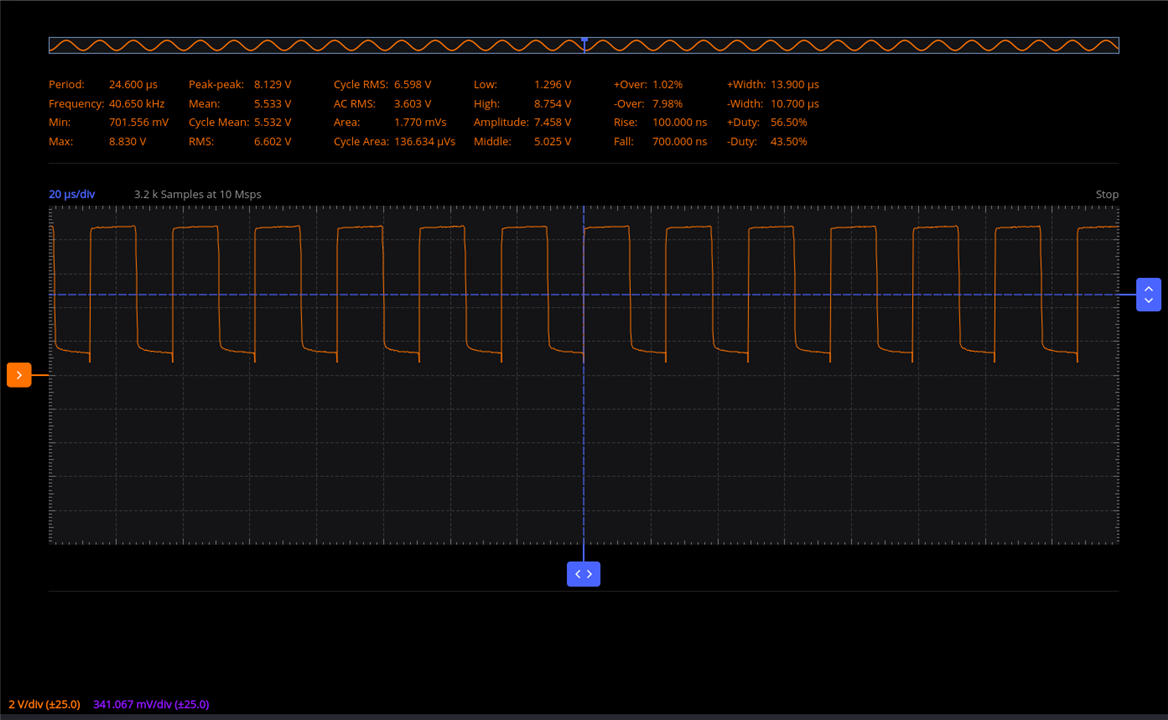

I started with the first one I could find on my desk. It was a n-channel MOSFET from ONSemi (NTD5867NL) nicely packaged as a breakout board from Freetronics, which also included the necessary resistors.
For my MOSFET testing, I started with a low PWM frequency and then increased the frequency until I reached my target frequency of 120kHz. I was keen to see at what frequency the square wave changed shape. In all cases I kept the duty cycle at 50%.
{gallery:autoplay=false}N-Channel MOSFET
So, based on my tests (as shown) I was able to reach 80kHz PWM before the NTD5867NL n-channel MOSFET could no longer replicate the clean square wave.
Does this match the specification? I’ll leave it up to you to decide.

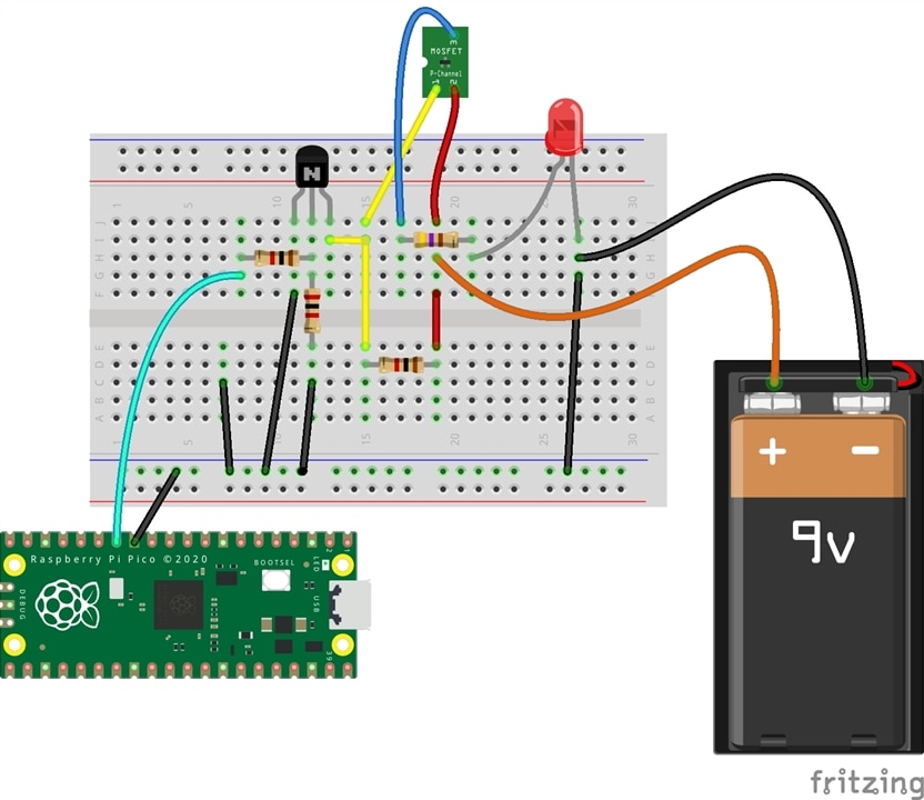

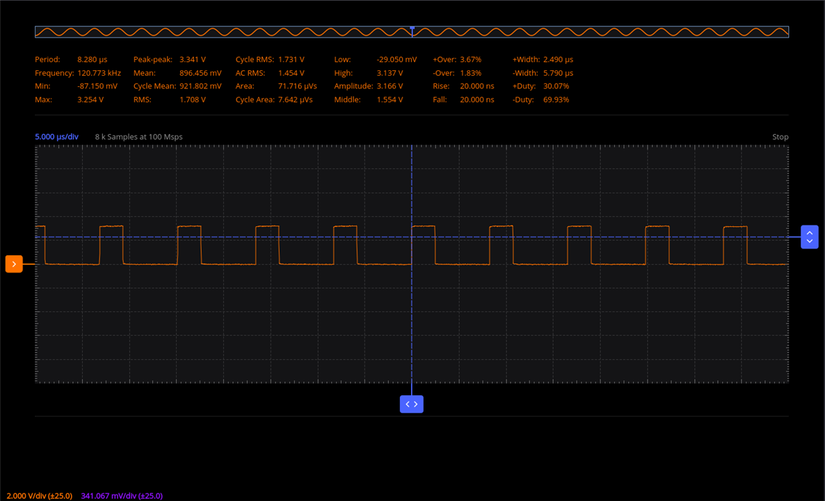

Experimenting with a P-Channel MOSFET

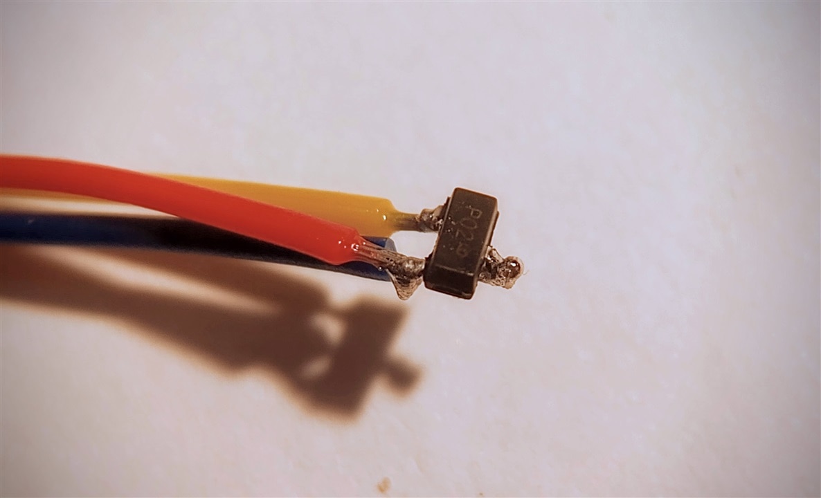

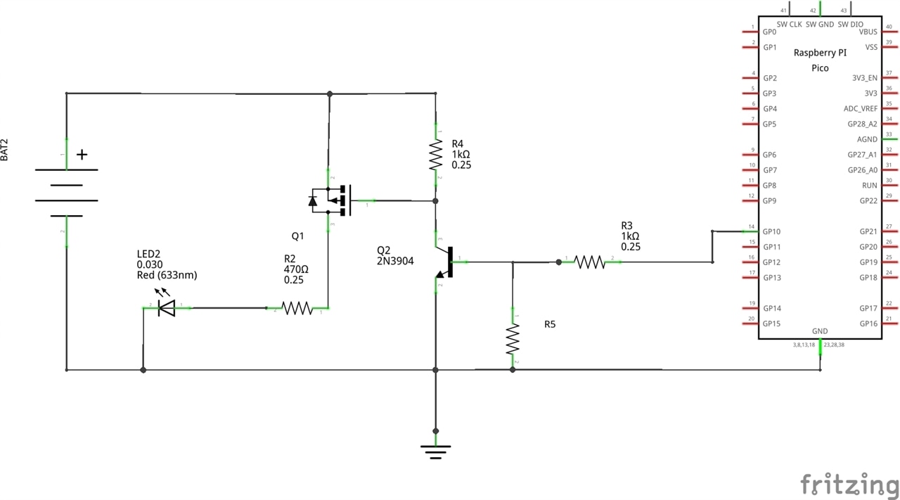

I had forgotten to order in some through-hole P-Channel MOSFET’s so I was left soldering on wires to a SOT-23 SMD component. Thankfully, I had a small enough soldering tip to make short work of this little hack.

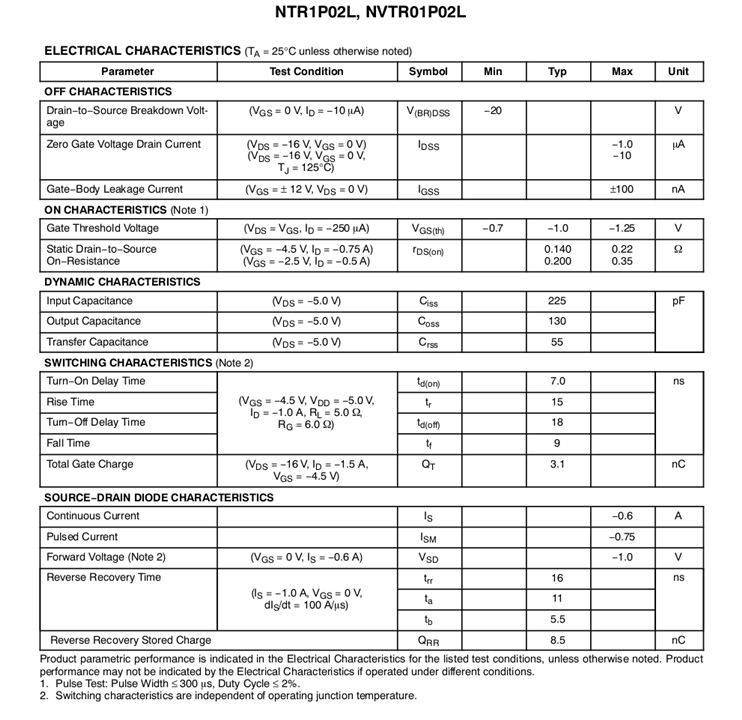

The tiny MOSFET in question was the NTR1P02LT1-D from Onsemi. According to the datasheet, typical applications for these miniature SMD are DC−DC converters and power management in portable and battery−powered products.
The test circuit a fairly standard p-channel switch circuit which included an additional transistor to switch the MOSFET with a 3V3 microcontroller:
{gallery:autoplay=false}P-channel Circuit

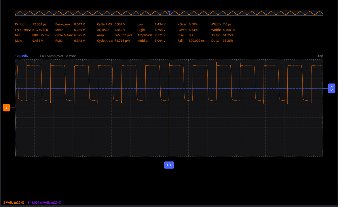

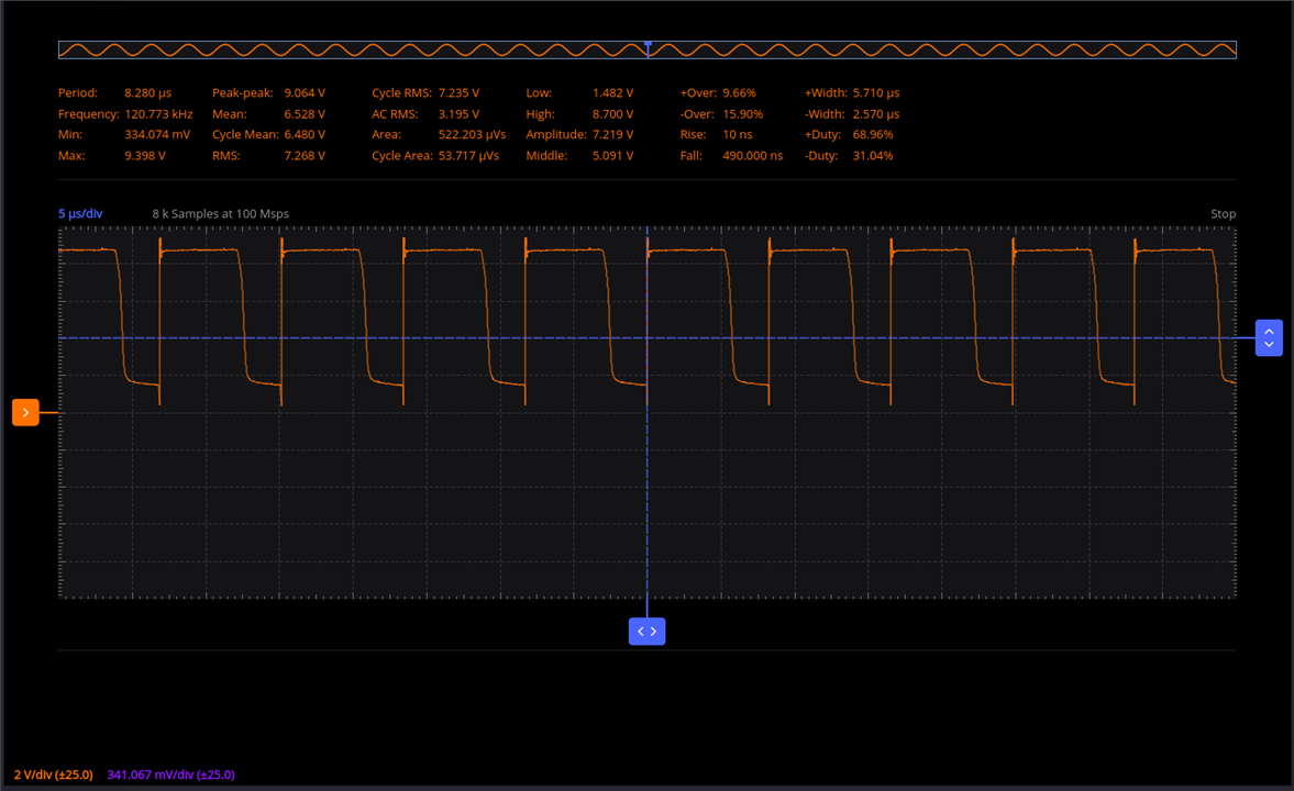

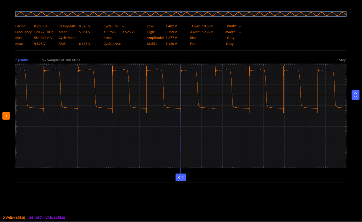

The results were fairly encouraging as I was able to reach 120kHz. Although it was not ideal.
{gallery:autoplay=false}P-Channel PWM Results
Then, after a little pondering, I came up with an improvement. By adjusting the PWM duty cycle to 30%:
I was now able to get the desired square wave through this p-channel MOSFET. Happy days.
I’ll leave it up to you to decide whether this output meets expectations based on specifications shown above.

    "Does this match the specification? I’ll leave it up to you to decide."
    Whilst the datasheet specification looks very impressive, switching characteristics are a secondary attribute: they depend very much on the test used to measure them. That's because the thing that slows is capacitance, and you partially get round that by throwing more current at the capacitance so that the voltage changes quicker.
    The manufacturer wants the part to look good in a comparison, so the test is designed to show the part at it's best within the limits the part is rated for. In the case of the NTD5867NL, they have the device switching 20A to 48V in the output circuit, and they're initially throwing several amps at the gate (4A in this case, if the gate is metal rather than heavily doped silicon). In your case, the output is very lightly loaded and the gate current is probably initially something like 100mA - the output pin of the Pico is driven high by an internal MOSFET with an on resistance of maybe something like 20-25 ohms. So you won't see the figures they are showing you on the datasheet.
    One thing that does help you is that the microcontroller pin driver is fast, so you aren't being slowed by the performance of the driver in the way Javagoza was with his discrete bipolar circuit. The limitation, though, is that you can only get the gate to 3.3V, so fine for switching lowish currents with a logic-level MOSFET, but may struggle switching higher currents.
