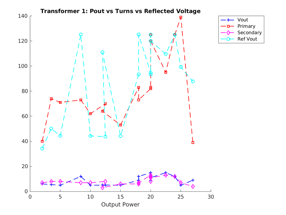

Thirty Six wattages from 2W to 85 W which are internationally used in laptop and mobile chargers have been selected. The voltage and current ratings used in this study are not from my choice but has been selected as per market specifications.
For each of these thirty-six flyback transformers, two transformers with the best optimization and lowest possible losses in different modes – continuous or discontinuos on different cores, have been calculated manually, which were later sold to manufacturers to be originally used in the product, viz., mobile or laptop charger.
These flyback transformers are operated in continuous or discontinuous mode, switched from MOSFET which is driven from PWM signals by microcontroller. The switching frequency is fixed for a particular transformer but all these 72 transformers have different switching frequencies from 41 kHz to 97 kHz, and have different core materials. The selection of which transformer rating is operated in continuous or discontinuous mode or designed with which core, is in general random but has been decied by these factors - best optimization, lowest possible losses, capability of the core.
To add more practicality, for the same wattage, different voltage and current ratings have been used, for instance, 20W can be made with 15V or 9 V or 11V or 12V. The transformers which have been derived by such combination are prefixed with ’p’ in ‘Watt’ column,e.g. p0, p1, p2, p3 means one design with one voltage and current rating, second design with other voltage and current, third design with other voltage and current, and fourth design with other voltage and current rating.
For each of thes 72 transformers, thirteen calculcations - core losses, copper loss, leakage losses in the flyback transformer, combined MOSFET losses, gapped core specific inductance,Alg , primary inductance, current waveform, flux densities - maximum flux density, peak flux density, AC flux density, reflected output voltage, number of primary turns, number of secondary turns, are done manually using formulae given in references which are tabulated in Tables I, II, and III.
As this study is specifically on the flyback transformer losses and magnetics, the collective MOSFET losses,LMOS , include conduction losses,(RDS(ON ) loss,current sense resistor losses), and switching losses
( CV2F, , crossover loss), are given in the Table I.
These MOSFET losses,LMOS thus, include losses due to finite switching time of MOSFET and due to dissipation in the stored energy of the parasitic capacitance of the transformer and the output capacitance of MOSFET.
Flyback transformer has three kinds of losses- (i) Core Loss, Lcr , which is combination of eddy & hysteresis losses. (ii) Copper Loss Lcp , include both DC & AC skin effect losses and (iii) Leakage Losses in the transformer, Llkg , which is commonly measured from the transformer primary with the pins of the secondary windings shorted. But, in this paper, the mentioned values in the table are calculated and estimated with primary inductance tolerance of 5 % .
The flux densities is also divided into three - maximum flux density (Bm ), peak flux density (Bp ), and AC flux density (BAC ). These parameters if gets exceeded during the operation causes saturation in the flyback transformer core, which are known to happen at the time of transformer energization. From Table II, BAC < Bm < Bp , BAC is the lowest as it is the flux density amplitude at full power, and
This constitutes the experimental validation as earlier mentioned, based on these 12 calculations, the transformers were designed by the manufacturer and sold in the market.

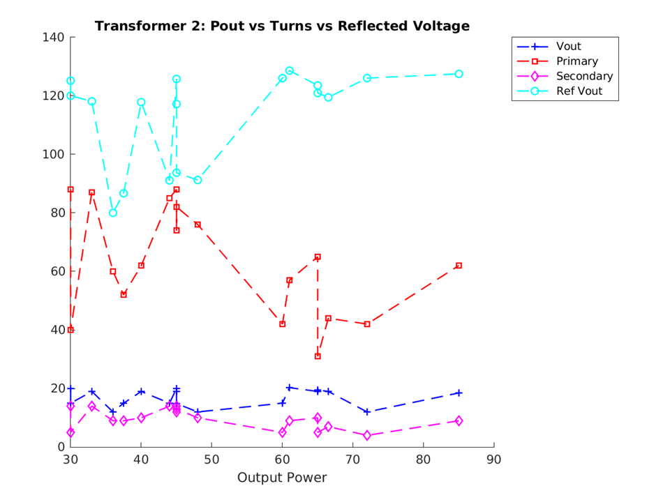

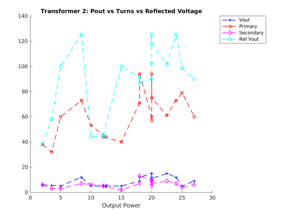

All the tables are tabulated for both designed transformers T1 & T2. Thus,
Table I lists all the three losses, Lcr , Lcp , LMOS at the transformer switching frequency fsw along with gapped core specific inductance,Alg . Alg defines its’ non-linear relation with inductance, and is the inductance coefficient.
Table II lists the cores used along with three flux densities (Bm , Bp , BAC ) and continuous/discontinuous mode, m with ratio, Kp .
Table III lists the output voltages, VO from the market specifications on which the wattage, W is needed, along with transformer primary inductance (Lp ), leakage loss in the transformer Llkg , number of primary (Np ) and secondary (Ns ) winding turns, reflected voltage, Vor .

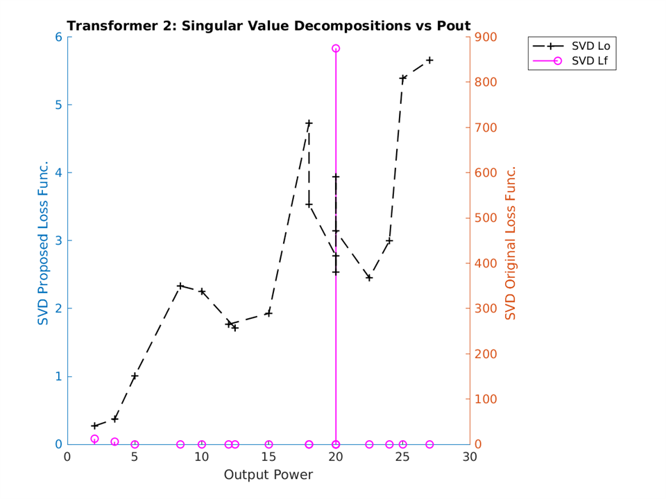

1.5 Loss Functions & Matrices
As shown in subsection ‘C’, the losses can be written in matrix form. Similary, the coefficients of Lo and Lf can be written in matrix form, e.g. [0.1536 -0.09921 -0.08965].
It is also known that (besides using L′ f ≤ 0, for predicting stability), the stability can also be predicted from the definiteness of matrices, that is, if the matrix is symmetric or symmetric positive definite, it is stable.
The Cholesky matrix decomposition is the known method to tell positive definiteness of matrix using Cholesky factorization.
Table VI, lists the results after calculations from matrices of the loss function (Lf ) and original function (L). The definiteness of matrices whether the matrix is symmetric or symmetric positive definite, is given in column D (L) & D(Lf ). These are calculated using Cholesky matrix decomposition, and has been tabulated as yes (‘Y’) or No (‘N’).
The results of SVD has not been used but obtained to be used for future research.
The singular value decomposition, SVD (L) of the original loss function,and, SVD (Lf ) of the proposed loss function, is also tabulated in Table VI.

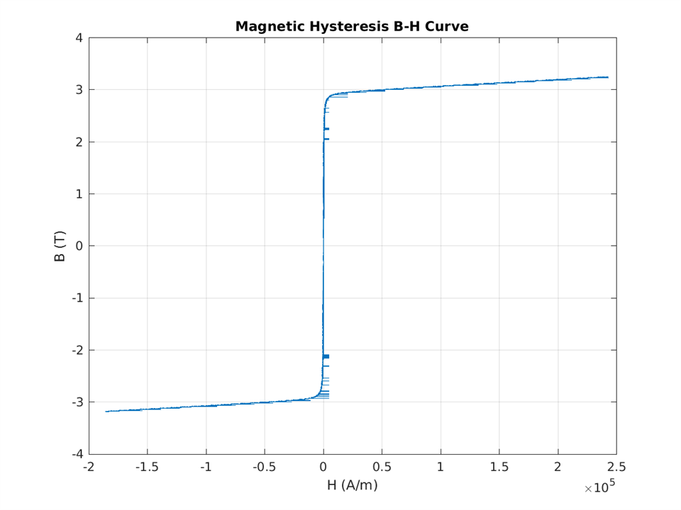

1.6 Other experiment Considerations and practical suggestions
All the following transformers are flyback switching two-winding transformers, designed and implemented in practical industrial use, with estimated efficiency of 87%, with safety standard of EN 61000, Class 3, in adapter enclosure, to be operated in constant voltage mode with output voltage tolerance of ± 2%. Following other known considerations also has been taken into account.
All of the transformer core’s has an air gap in its limb to reduce the chances of magnetic saturation, which increases the magnetic field intensity, H, without changing any saturation flux density of the core material,thereby, increasing the working range of BH & the throughput of the flyback transformer.
In all of these transformers,the margin is half the required primary to secondary creepage distance ≈ 2.5 mm, and the margin winding is applied with layers of slit tape, wrapped in sufficient layers. The primary layers have been separated by at least one layer of polyester film tape,3M 1298,which reduces chances of interlayer voltage breakdown. The layer to layer insulation has been improved with epoxy. The maximum operating flux density has been chosen taking into account the peak flux density, core saturation, start-up, short-circuit, current limit and variable inductance values. In flyback transformer designing, the reflected output voltage, Vor is an important parameter as during diode conduction, it is reflected back to the primary, through transformer turns ratio, and is the secondary winding voltage.
These flyback transformers could be designed to operate in continuous (C) or discontinuous (D) or borderline mode, which is decided by parameter current waveform Kp , which simply means whether the magnetic field in the core over one complete switching cycle is zero or not. The mode of operation used in 72 transformers is given in Table II, listed in the 6th & 12th column under m as ‘C’ or ‘D’, which corresponds to continuous or discontinuous mode respectively.
For continuous mode, Kp ratio, allows the margin for wider leading edge current spike, which is caused by the discharge of the drain node capacitance of MOSFET. For discontinuous mode, Kp is the ratio of MOSFET off time to the conduction time of the diode connected with transformer secondary.

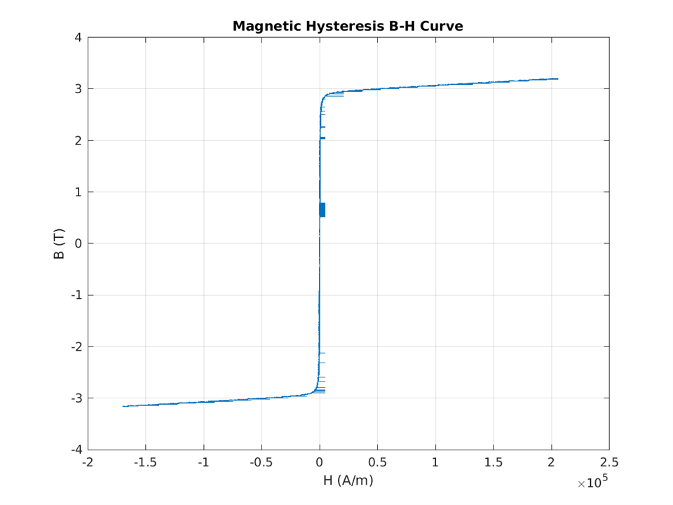

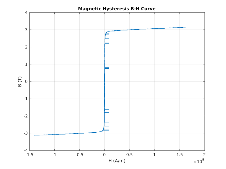

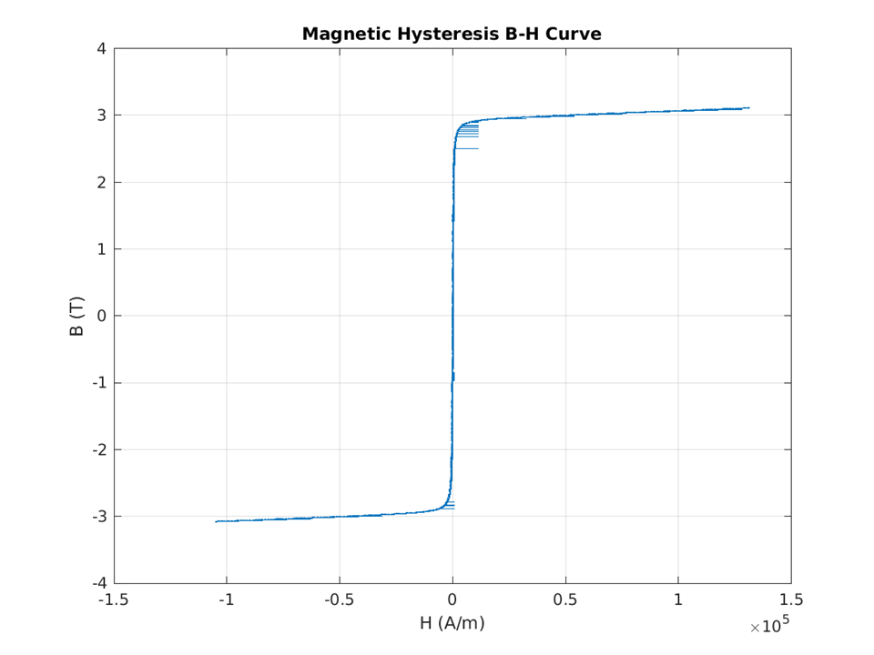

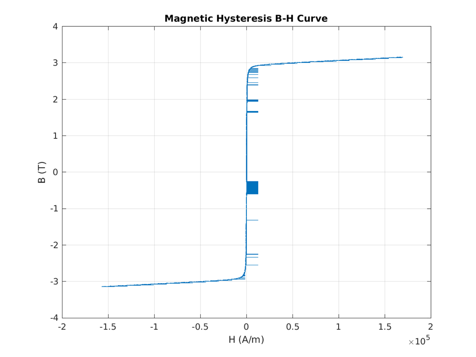

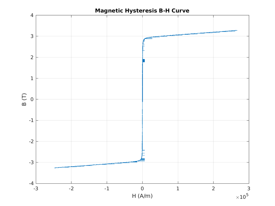

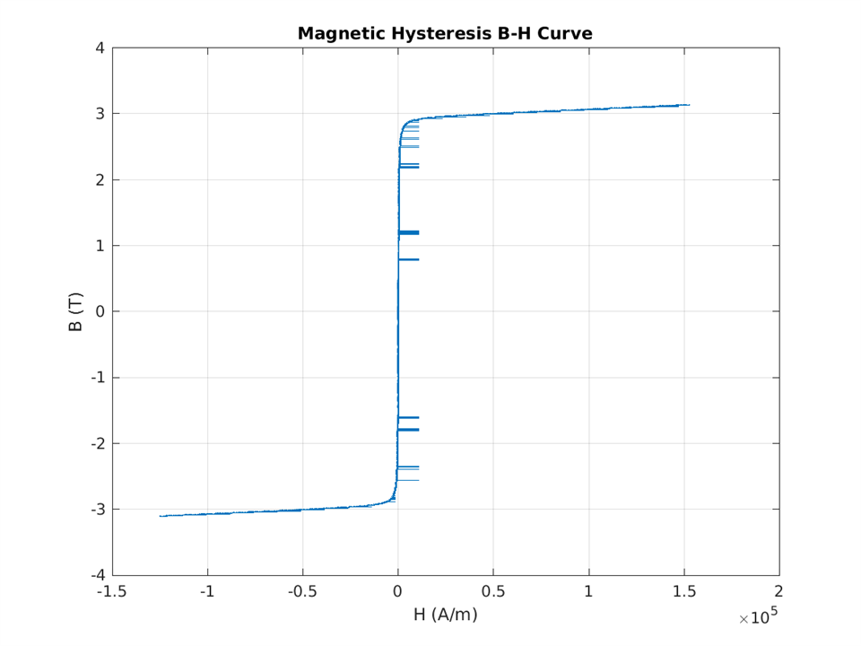

1.7 simulation set up parameters of the battery load (along with formulae used in non-linear battery),
The load is taken as li-ion battery,where the load battey model has been implemented with state of charge (SoC), self-discharge resistance, temperature-dependent leakage resistance, five time-constant, τ dynamics, deterioration of battery performance over repeated charge and discharge cycles.
As this is comparative study on 72 transformers with different voltage ratings, the exact voltage is variable but the charging voltage of each cell is 4.2 V(tolerance of around ± 50 mV per cell). Let the voltage Vb across battery be Vb = vt (S, T ), where S is the state of charge.
In this study,the load battery is modeled with five parallel RC sections with 5τ time constants,τ1 , τ2 , τ3 , τ4 , τ5 , = (S,Tb ) where S is vector [0, .25, .75, 1], and Tb is temperature in kelvin with vectors [273.15, 298.15,323.15].
The self-discharge leakage resistance, Rblkg (Tb ) has vector [8000, 7000, 6000].
As practical batteries deteriorate over repeated charge and discharge cycles, the vector of discharge cycle is [100, 200, 300].

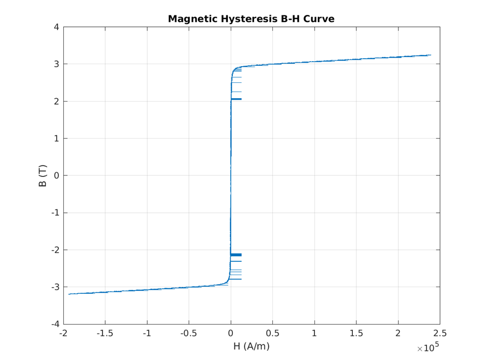

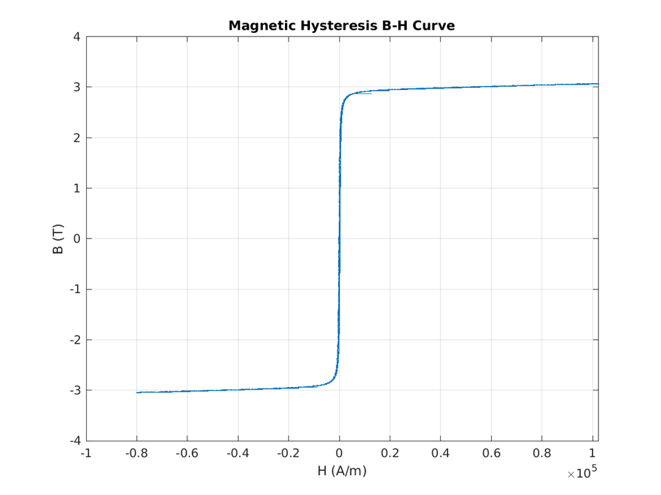

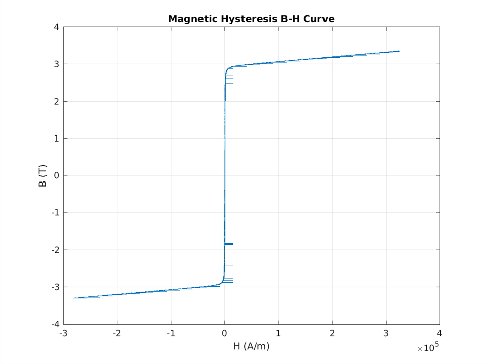

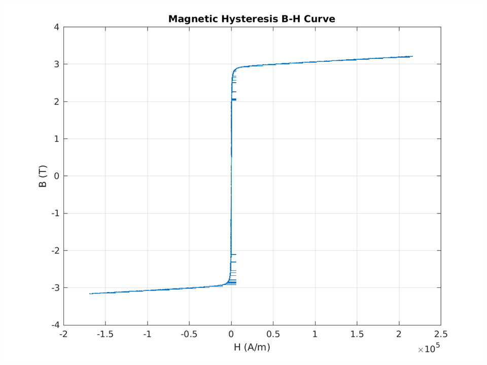

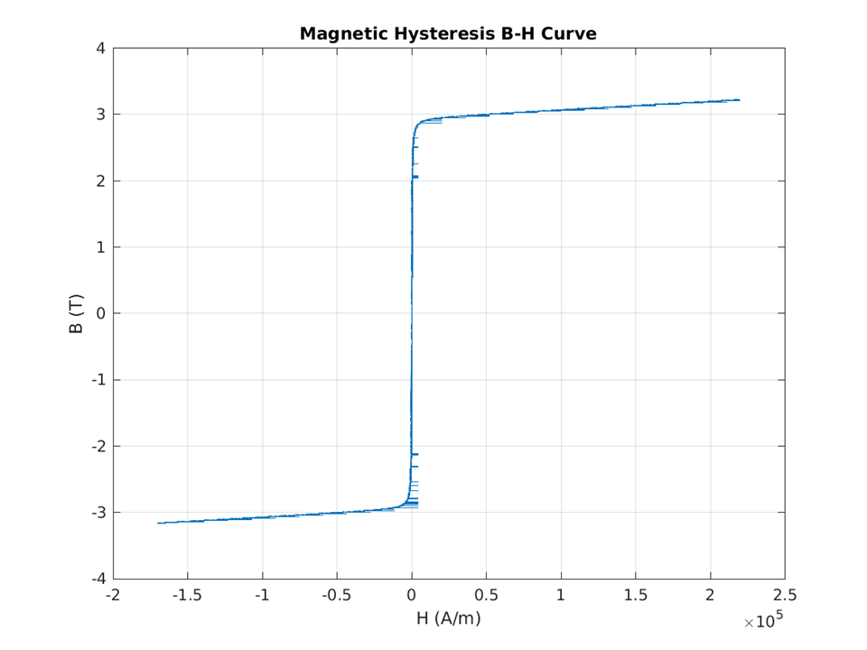

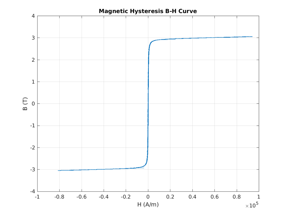

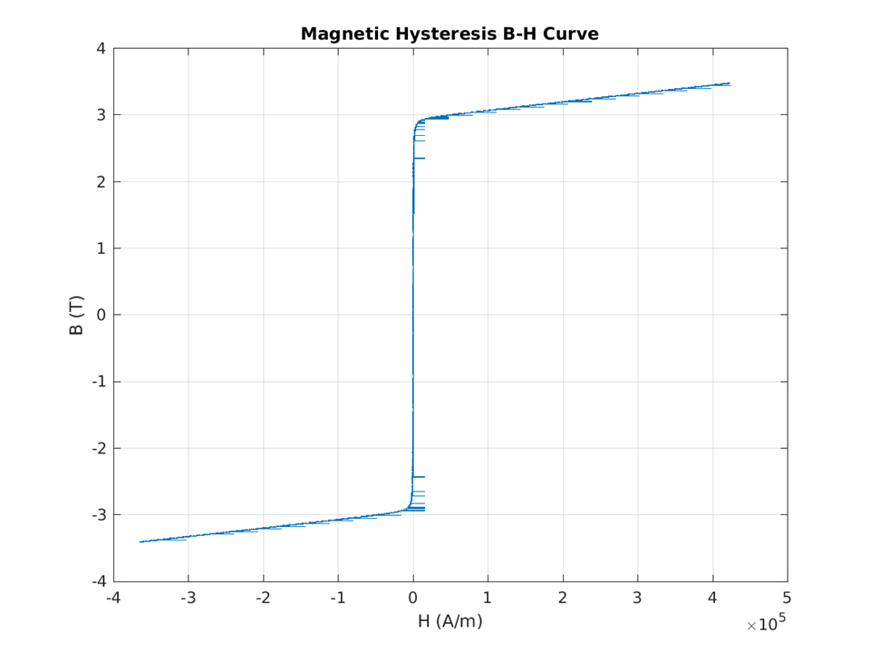

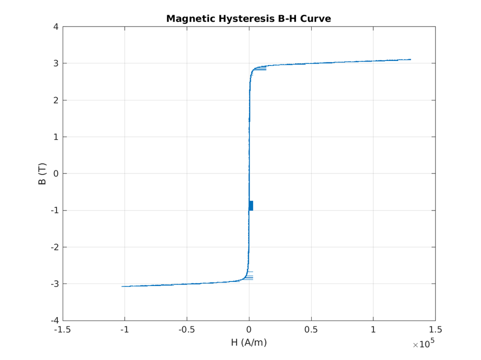

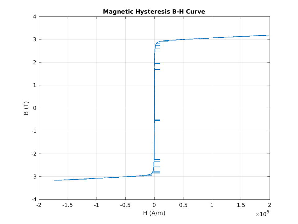

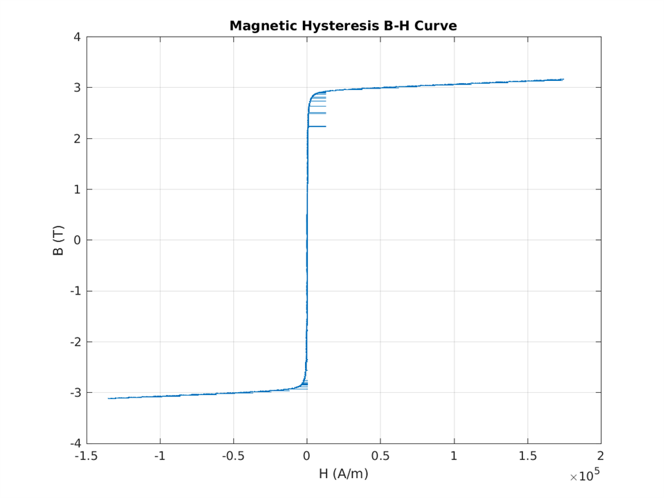

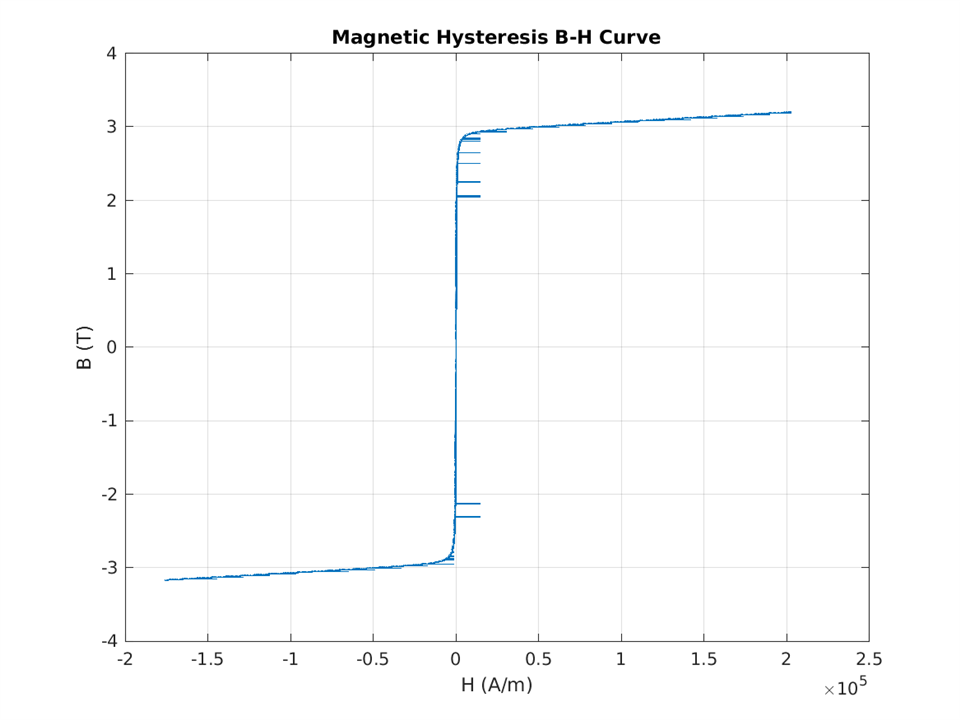

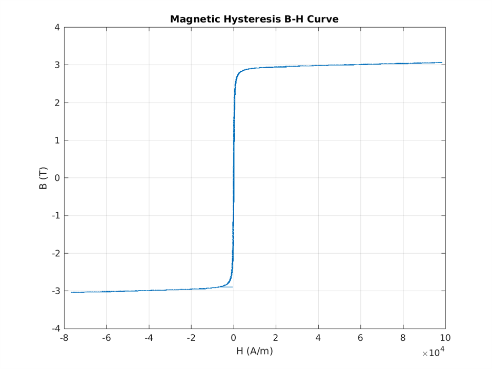

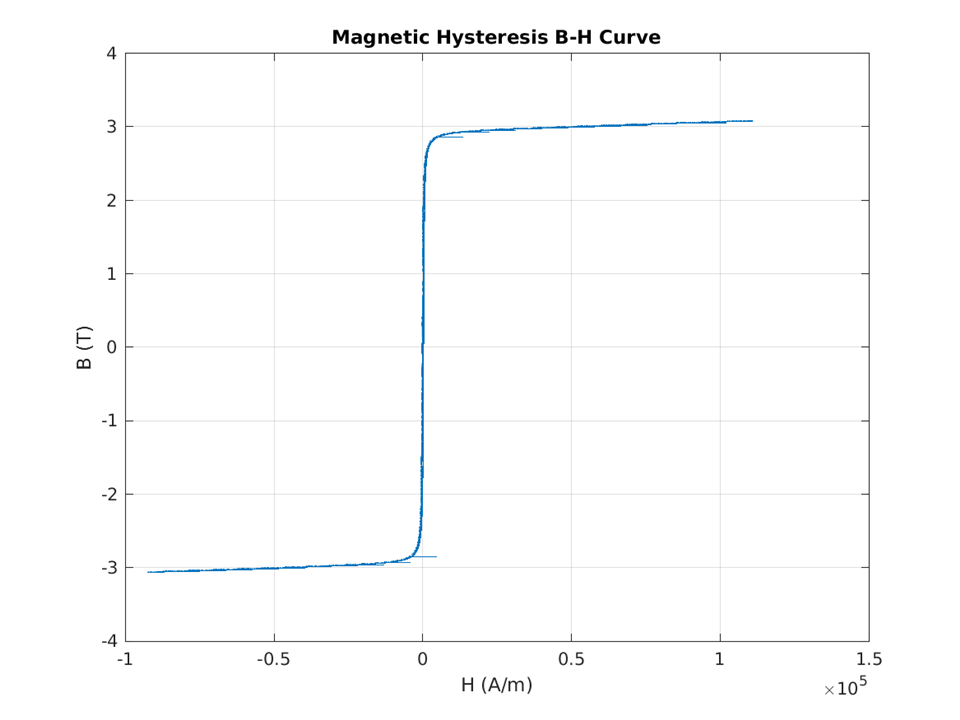

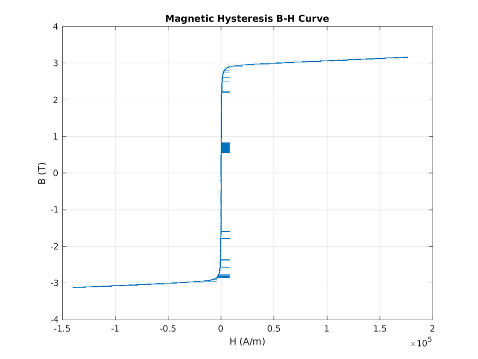

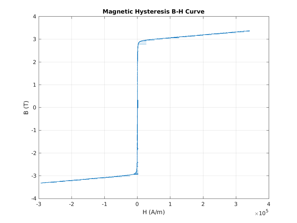

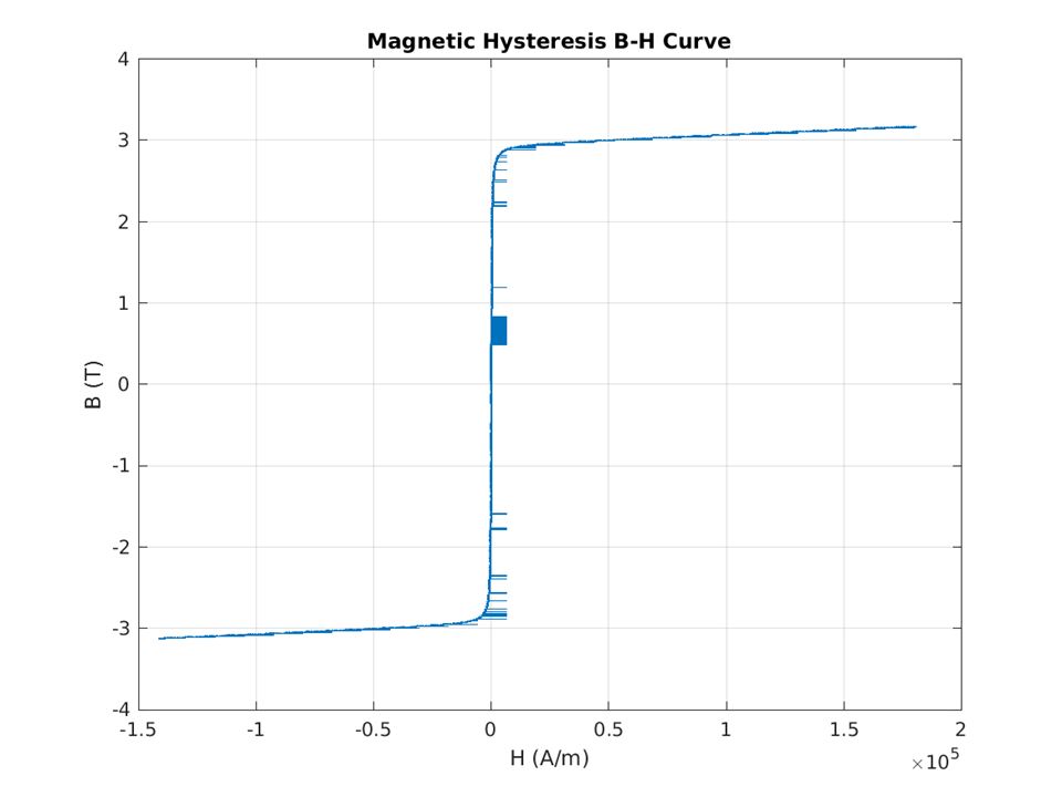

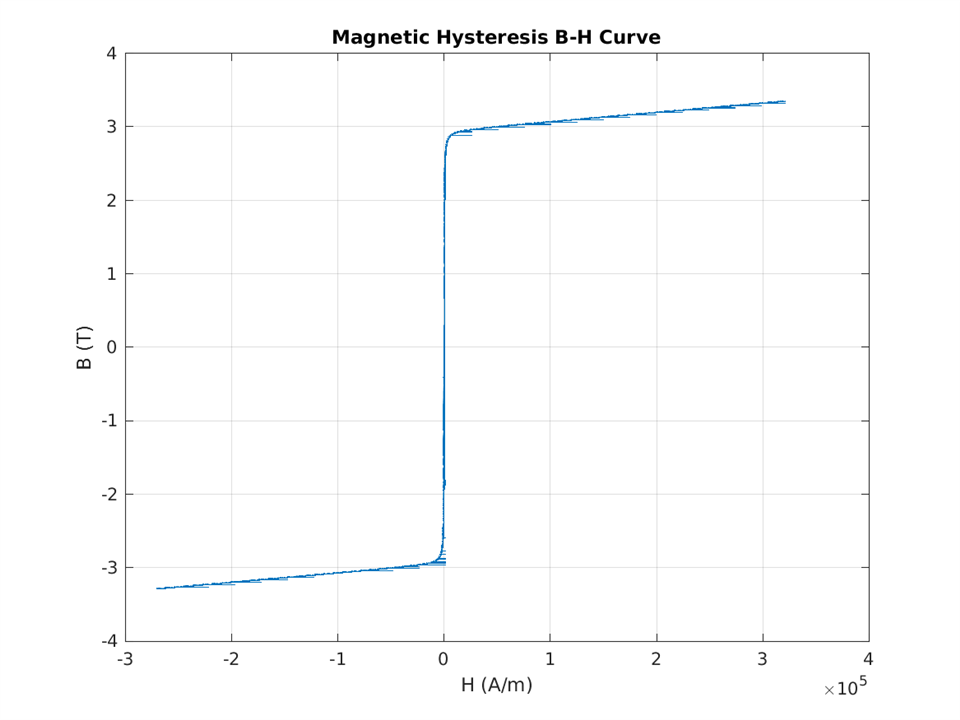

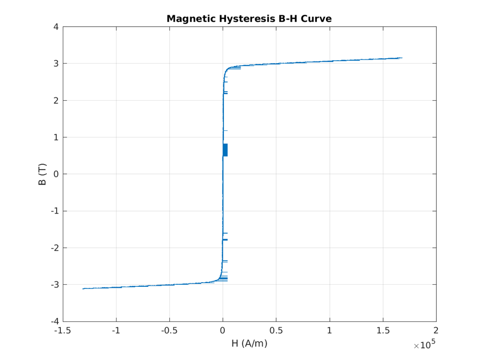

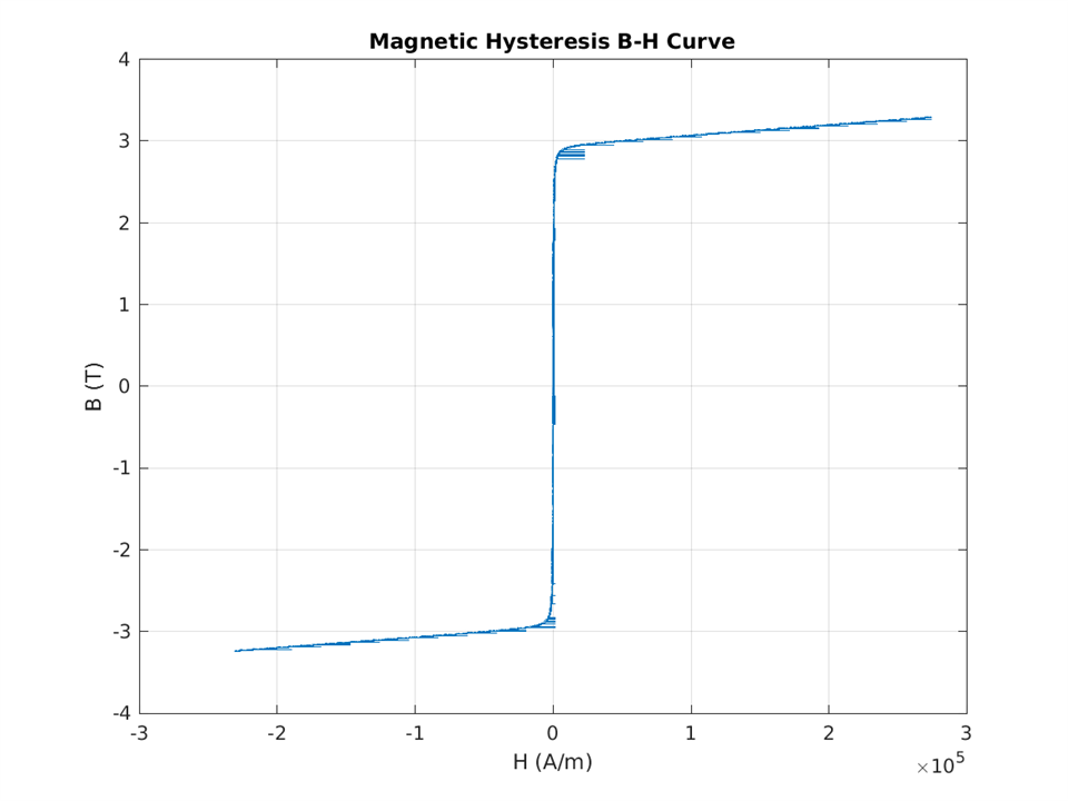

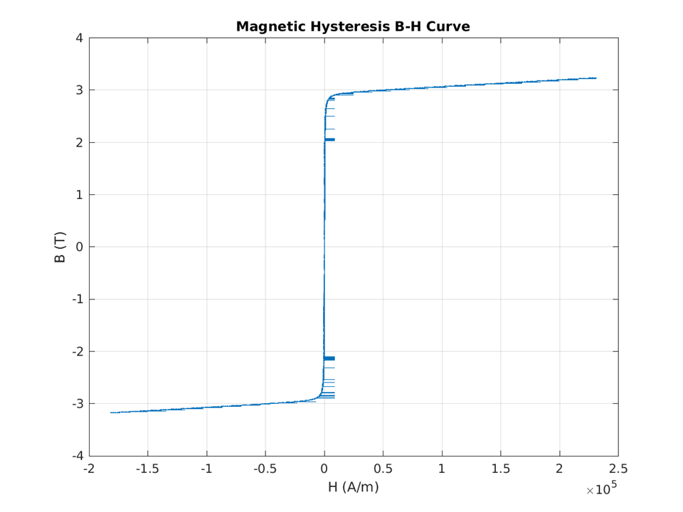

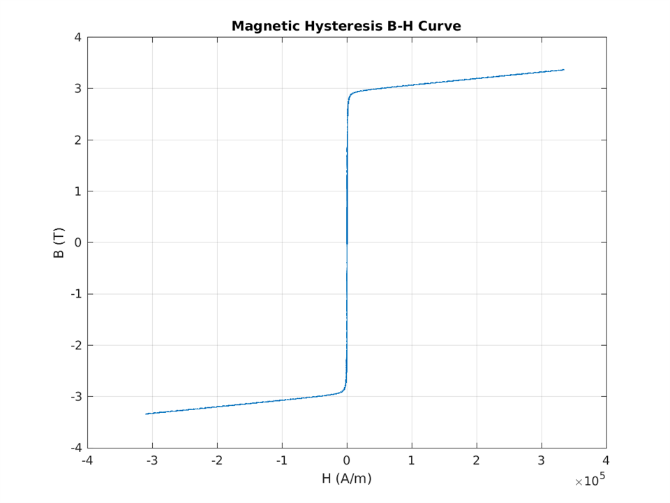

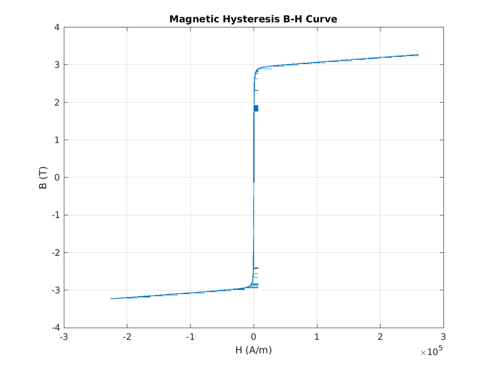

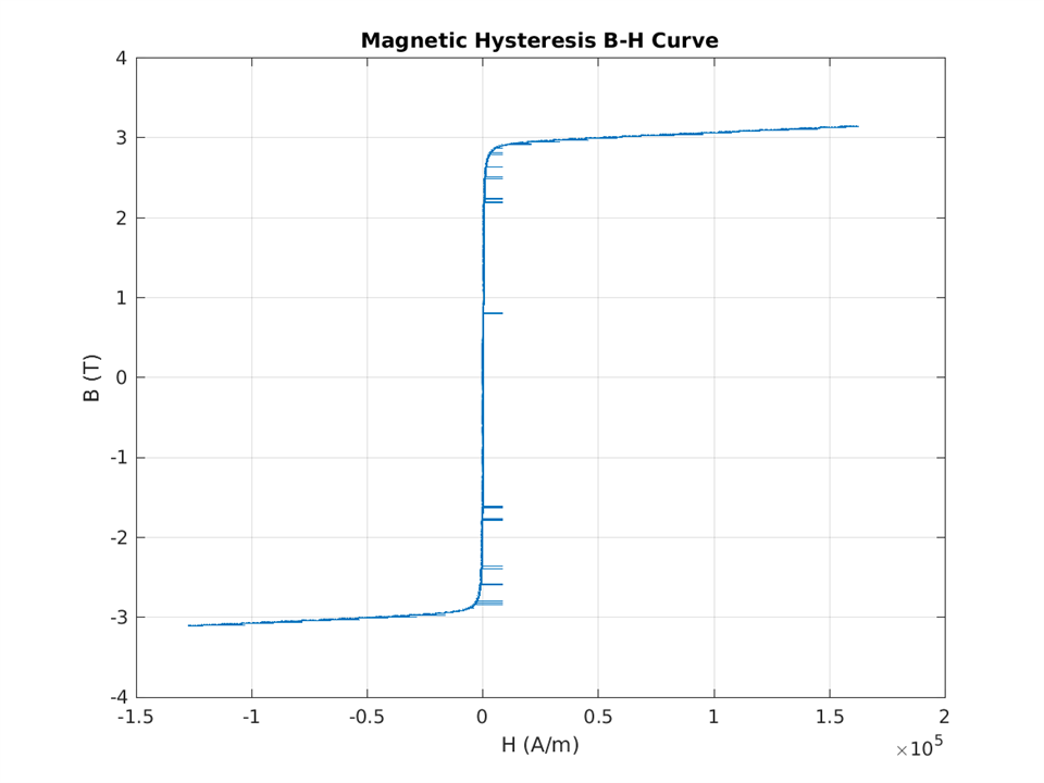

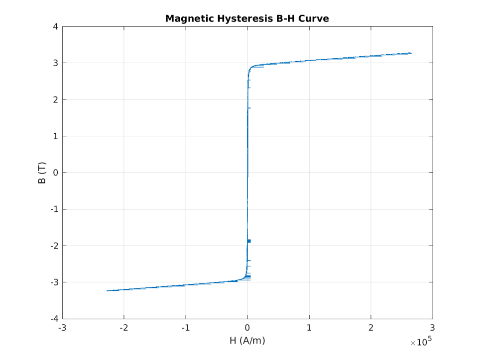

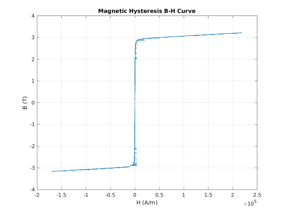

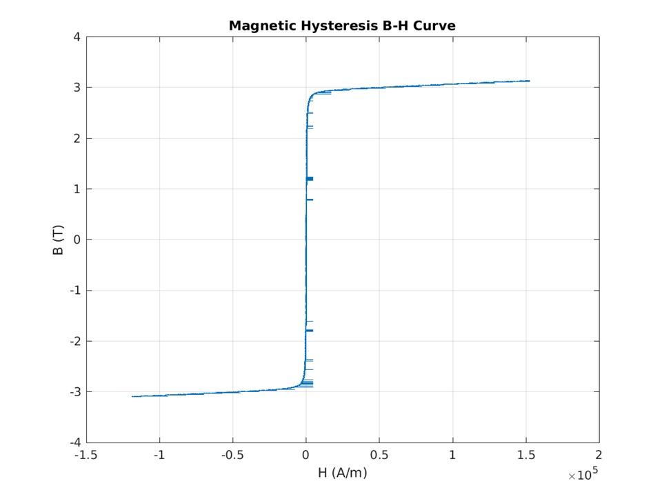

1.8 Jiles-Atherton model
The practical implemented transformer values - Ns ,Np ,Llkg ,Lp ,Ls , losses,core’s effective cross-sectional area & mean length path with air gap length, had been put in each of these 72 simulations.
Let, G, is the variable gain, used to trace curve when the magnetisation, saturation, Bm is in opposite
direction,
and G= Kδ − α(Man − Mirr ).
The three coefficients in the equation are α, c, K.
(i) inter-domain coupling factor, α (0.0001 < α < 0.001);
(ii) coefficient for reversible magnetization, c, 0 < c < 1
(iii) bulk coupling coefficient, K.
In the initial start, parameters like field strength and flux are all zero. The coefficients c, K, α matrix [0.1 165 0.0001] are fractionally perturbed as ∆p = [6 1.5 1.5], after 300 input Vs cycles i.e.,after 300 times complete revolution of 360◦ .
1.9 Lyapunov exponent
It is obvious that when three coefficients will be adjusted to mimic load perturbation, BH curves will be obtained and during the complete perturbation of the load, numerous trajectories of hysteresis curves will be obtained. It is known that Lyapunov exponent characterize the rate of separation of infinitesimally close trajectories.
Two Lyapunov exponents have been derived for future research use
(i)λJA ,the Lyapunov exponent, which is calculated from BH curve of core loss, which by definition is eddy and hysteresis (listed inTable I, in mW)
(ii) From simulation, that is, hysteresis losses LH (JA) in mW, after JA perturbation simulation.
Let the BH curve obtained after 300 input cycles with 3 perturbations has N points (h1 , b1 ), ..., (hN , bN ).
For the point (hi , bi ), i = 1, ..., N on BH axis
Then, a single value of λJA is obtained from polynomial curve fitting using Vandermonde matrix.
Table VII, lists the value at the first order derivative, L′ f and the λJA and LH (JA) in mW.

Fig. 6 & Fig. 7, shows the plots of output voltage, reflected output voltage, number of primary & secondary turns, for transformer 1 & transfomer 2 respectively. It can be seen that the reflected output voltages,Vor are even ≈ 20 times higher than as, in Vout = 5V ; ≈ 21.33 times higher than as, in Vout = 5.2V ≈ 11 times higher than as, in Vout = 12V ; ≈ 6 times higher than as, in Vout = 6V, and soon. These Vor if other core is used to design at the same voltage level.
