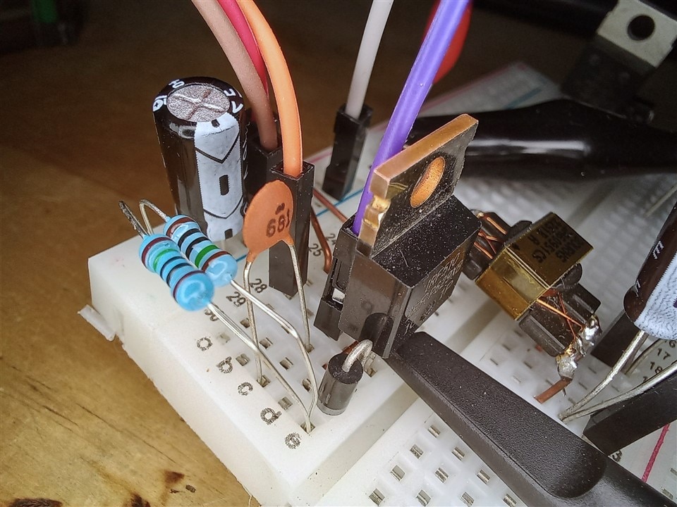

This is a blog about experimenting with flyback transformers and all I've done this far is ramble with simulations, so I'll get to it:
We set an acceptable power to be dissipated by the resistor, then:
And for the resistor:
This is from another video by Biricha that explains the entire process.

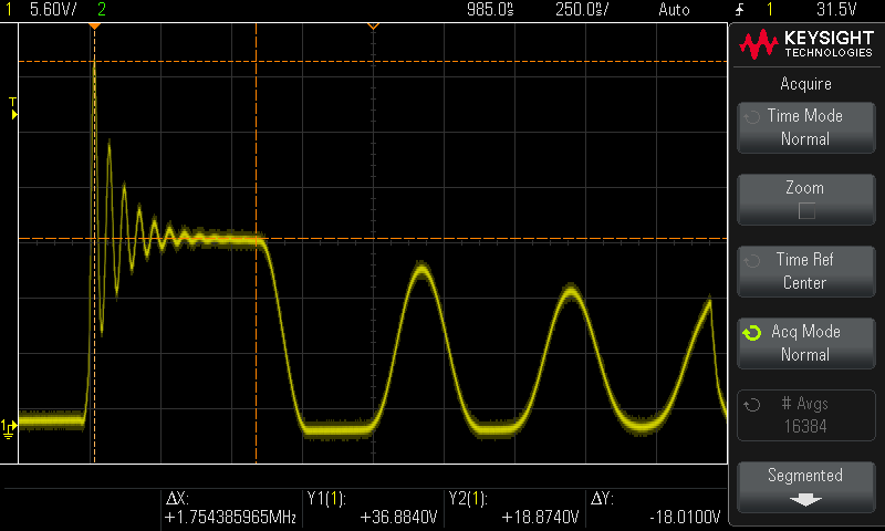

Simulation? not this time, let's see how the real circuit does:
A before shot:
And after!
Fine, I lied, I can't resist a good simulation, especially when reality matches it almost perfectly:
Simulation values were adjusted to match the values of the real measured components.
We still see a voltage spike, which, again, is not harmful at these voltages. However, it's always good to consider the general case, as we never know what we'll have to design for in the future. And in the future, too, lies what we can do about that spike: Clamp it down!
