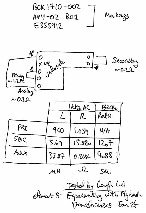

Out came the desoldering braid and being single-sided, the transformer popped out with no fuss. Doing the same with the B&K Precision BA6010 Battery Analyser and Rohde & Schwarz MXO4 Oscilloscope, I was able to deduce the pin-out, measure the inductances, winding order and winding ratios.
Given that this was for a 5V/2A power supply, or 10W roughly, this already rules out the use of the 063929 and 063932 in the kit (not to mention that they were destroyed in the previous part). Looking at the remainder, I would say the 093830 rated at 8W is probably the closest match – it has a secondary ratio of 18.5 compared to 12.7 which would probably mean slightly lower voltage than expected. The auxiliary winding would be substituted with the shield winding which has a ratio of 4 compared to 4.88. Numerically this may seem close but percentage-wise, it is significant.
But compared to my other options, it is much closer. For example, the 094931 has an auxiliary ratio of 2.75 which is too low, 094932 and 094929 doesn’t have anything resembling the right auxiliary ratio at 1 and 1.1 respectively and 063934 has a ratio of 9.6 for secondary which is perhaps too small (but would have perhaps been my next candidate). I can begin to understand why custom-wound transformers are necessary!

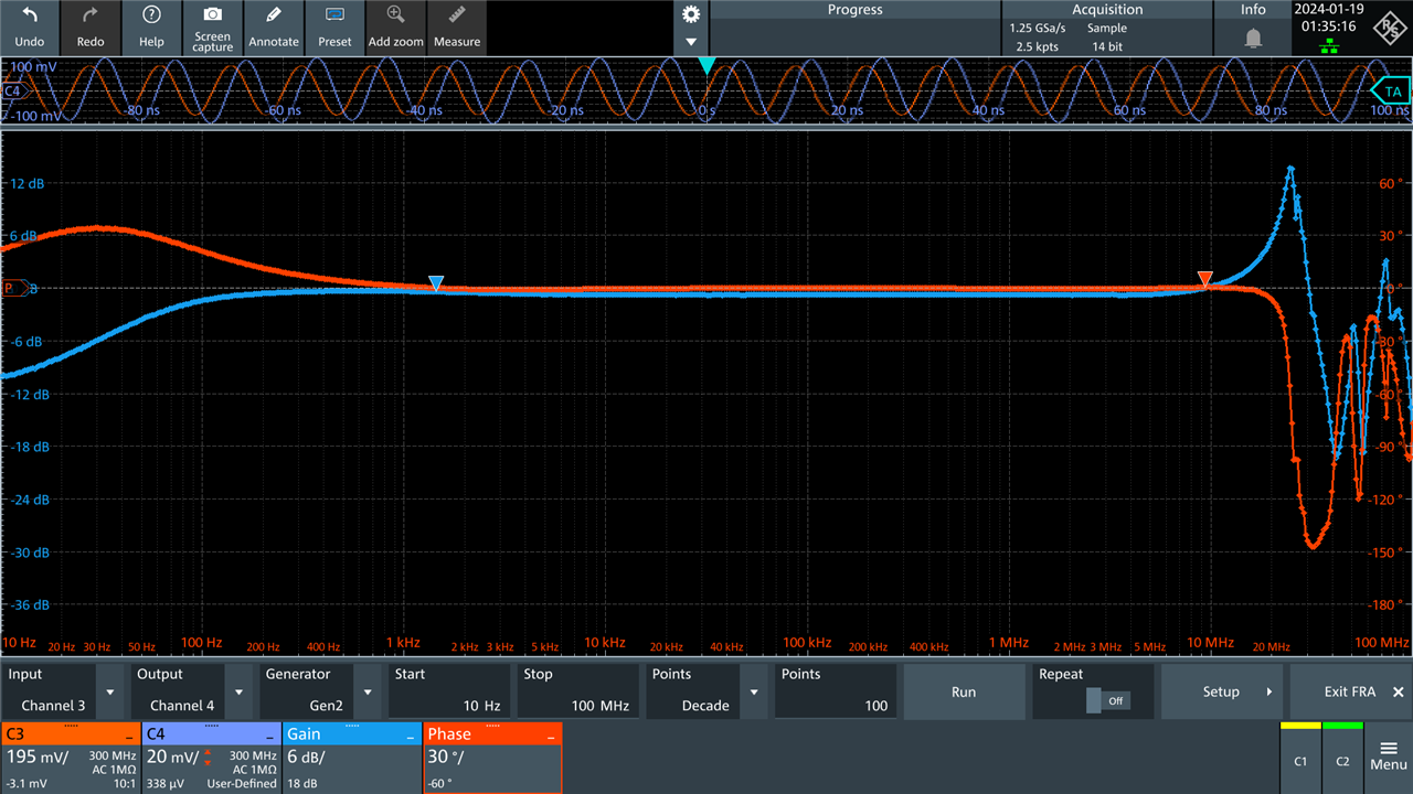

Testing of the ordinary PLC transformer (PFBR45-ST13150S) showed an excellent flat bandwidth response across a range of frequencies starting at around 45Hz (-3dB) and extending past 10MHz. Above there, the mess that is visible is likely due to the clip grounds.

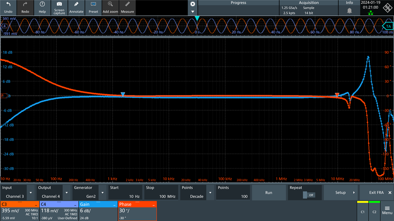

Testing of the reinforced insulation PLC transformer (PFBR45-SP13150S) showed a nearly identically flat frequency response. This indicates good signal integrity for the wide bandwidth of HF carriers commonly used in Ethernet over Power and other PLC technologies.
