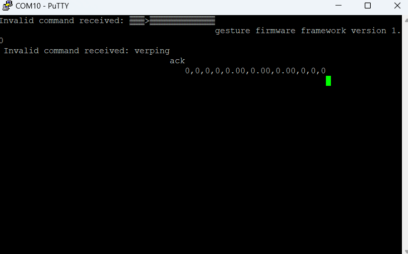

The MAX25405EVKIT comes with a MAX32620FTHR board which is preprogrammed with custom binary file for the gesture recognition. The application note at Maxim Gesture Sensor EVKit Serial API (maximintegrated.com)
mentions "The serial interface can be implemented over the Universal Serial Bus (USB) virtual serial port or over a Universal Asynchronous Receiver-Transmitter (UART). The EV kit is shipped configured to use the USB serial port to work with the EV kit PC Graphical user Interface (GUI). If a UART serial interface is desired, custom firmware in binary format is available."
Upon researching more, I found the firmware_framework code that contains the code for gesture recognition compiled using mbed compiler.
The readme file says that a file called interface.h and interface.c define the communication protocol. When I open the interface.c file, I can see a comment in the code that says Option to implement serial API over UART instead of USB but there is only a MACRO set as #define macro_name 0
I tried to change the 0 to 1 and compile the code, however, it does not compile successfully. The USBDevice library shows some error while compiling.
Did anyone try to change the serial API over UART instead of USB? Was it successful?
EDIT: I have successfully compiled the code for UART. However, I'll do some experiments and write introductory blogs before I re-program the MAX32620FTHR board with my firmware.

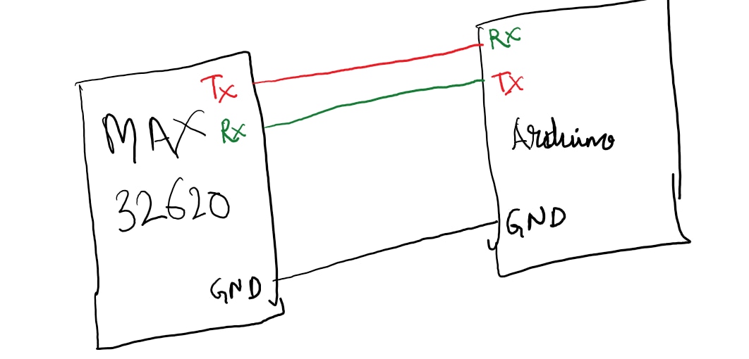

    Hi thanks for this. The only problem with this is that I will have to re-write the entire code for the gesture sensor. What I'm aiming for is just to get the gesture results over UART instead of the USB connection. As per the application note from Maxim, this should be possible.
    I'm trying to read the values from the MAX32620 board using Arduino. Here's my code. I'm not sure if this is correct.
    int ges_res = 0;  //variable to store gesture result
    void setup() {
      // put your setup code here, to run once:
    Serial.begin(115200);         //initialise serial comm. at 115200 baud
    void loop() {
      // put your main code here, to run repeatedly:
    Serial.write("ver");         //send a command to the MAX32620FTHR firmware as it expects a command from user
    delay(1000);                //delay to slow down the interval at the command is being sent to the FTHR board
    ges_res = Serial.read();   //read the ges_res from MAX32620 board
    Serial.println(ges_res);        //print the result on the serial monitor

    Today I tried to read the UART from the MAX32620 into a FT232 USB to UART interface, it seems that the MAX32620 is not sending anything over UART. This is for the framework code provided by Maxim

    He want to do something different. By default firmware communicates with computer over virtual UART over USB. But he do not want this virtual UART. Rather he want real UART. He do not want to comunicate with board from computer but he want use Arduino instead. He correctly found macro which can switch firmware to use real instead of virtual UART but his communication do not work. I am currently out of home so I cant try his firmware but I will do this this weekend.
  • misaz
    misaz over 4 years ago in reply to rsjawale24
    Do you use any level shifter? What is your connection? Can you post some photo?

  • rsjawale24
    rsjawale24 over 4 years ago in reply to misaz
    Hi! No, I'm not using any level shifter, I assumed that UART is using the standard logic levels.
    Here's my connection diagram -
    Baud rate for both the devices is 115200.
  • misaz
    Do you have voltmeter (multimeter)? If yes, try disconnect wires and measure voltage on MAX32620 TX pin. It would be one of 1.8V or 3.3V. What Arduino do you use? ATMega based or some newer ARM Arduino? In case of standard 5V Arduino UNO this connection is dangerous. In case of newer ARM based Arduinos which are usualy powered by 3.3V this connection may be sufficient in case if you measure 3.3V on TX pin.
  • rsjawale24
    Ah! I tried multiple arduinos. Uno, Micro and then MKR WAN 1300. Let me do the measurements on the pins. I had completely forgotten that MAX32620 has different voltages then the standard MCUs. I'm reading about 0.8V on the Tx pin of the MAX32620. I'll check the datasheet for the UART logic levels.
