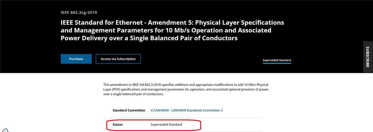

As every datasheet of Single Pair Ethernet component that I have encountered states, 10BASE-T1L is specified by IEEE 802.3CG recommendation.
Unfortunately, according to the IEEE website, last version of that specification, 802.3cg-2019 is marked as superseded.
superseded
What makes things worse, there is no clear information by what it is superseded...

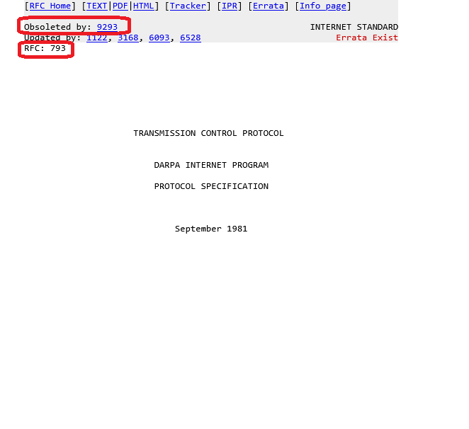

This situation is clearly different than for example RFC Internet standard stack, where every obsoleted standard is not only marked as such, but a successor standard is linked (example below)

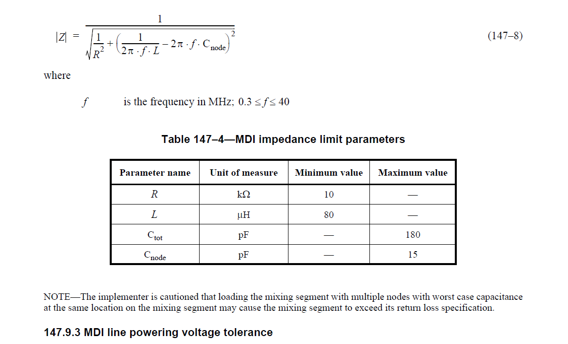

Another clue that 802.3cg is now a part of 802.3 can be found in only one public document in 802.3CG stack, an errata - which consists of one table that can be found in exactly the same form (and the same table identifier) on page 5921 of 802.3-2022
which - in my opinion - proves that Single Pair Ethernet specification is now included  in the main 802.3 recommendation and manufacturers could update their datasheets Slight smile
