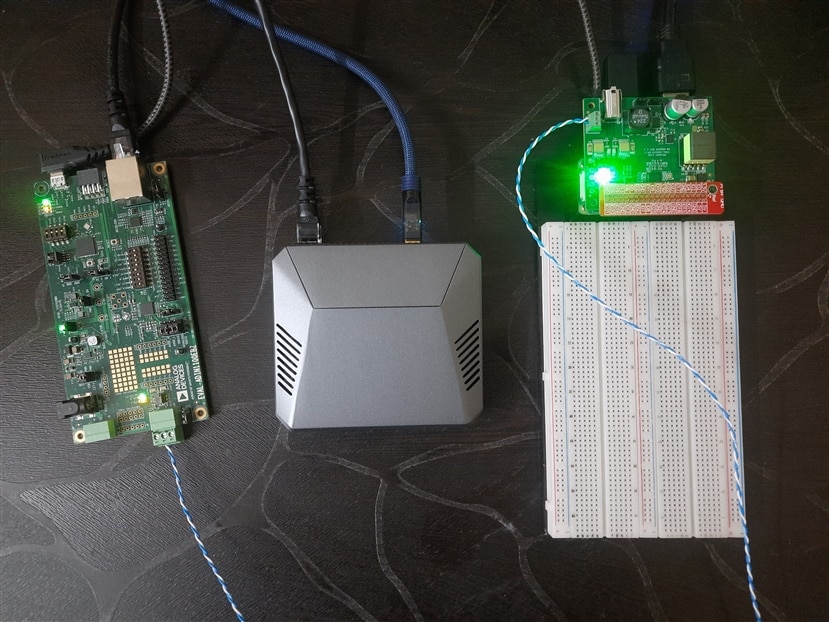

Here's the Setup
The current test setup(similar to the setup in my previous post but instead of the router I'm using the Pi 4 for a Offline SPE network)  has a Raspberry Pi 4 (with the Argon One case, got it since it provides better cooling and also looks cool Sweat smile ) as the main compute of the test setup, connected via standard Ethernet cable to an ADIN1100 media converter, which translates the signal into 10BASE - T1L. That signal then travels over the salvaged twisted pair wires to a CN0575 HAT sitting on top of a Raspberry Pi Zero 2W, which is my edge device in the test setup.

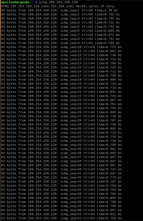

Start with the Ping !
Before throwing any heavy traffic at the link, I just pinged the Pi Zero 2W to check basic latency and stability.
The results were not disappointing, there was zero packet loss. The average round trip time was 0.665 ms, the minimum was 0.632 ms, and the maximum never went above 0.771 ms (Finally got the sub-millisecond latency which I mentioned in my previous forum post Grin ).  The standard deviation was just 0.026 ms, meaning the latency was rock steady with almost no variation between packets.
--- 169.254.158.120 ping statistics ---
100 packets transmitted, 100 received, 0% packet loss, time 20185ms
rtt min/avg/max/mdev = 0.632/0.665/0.771/0.026 ms
For a bare twisted pair wire setup, this was a great start and gave me confidence to push further.
