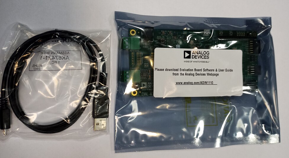

As we have discovered previously, ADIN1110 differs from ADIN1100 PHYs we have used so far that it includes complete Ethernet adapter (both PHY and MAC functions). In this Challenge, we were provided with evaluation boards for both ADIN1100 and ADIN1110.
External box of ADIN1110 evaluation kit is very similar to that of ADIN1100
ADIN1110 eval box
and inside there are two components: a board and USB cable
{gallery}ADIN1110

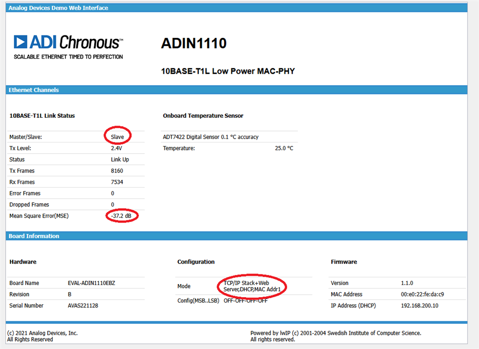

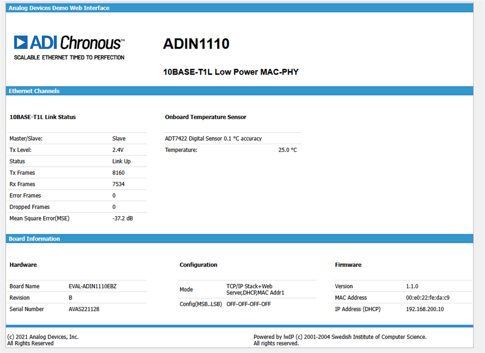

and is (after configuring DHCP server on Raspberry PI, because default configuration of ADIN1110 evaluation board uses dynamic address) working, serving page as below:
From this page, some interesting data can be gathered:
screenshot - annotated
As we can see, it has autonegotiated as slave/follower (which is consistent with default jumper setting of "prefer follower"), some quality metric is displayed and DHCP configuration is also present.

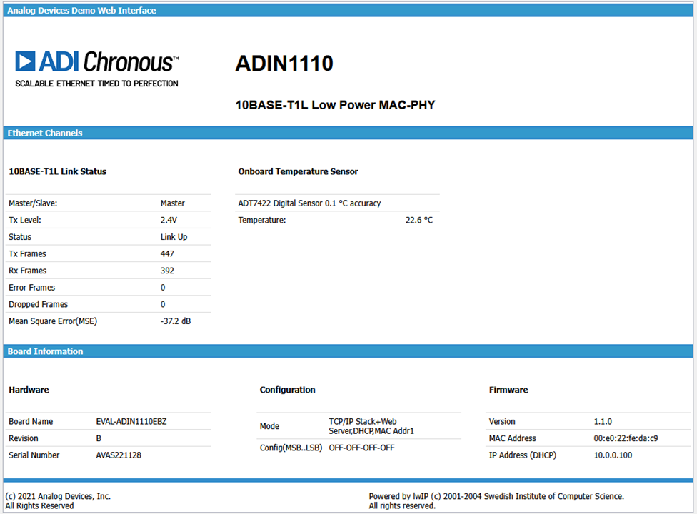

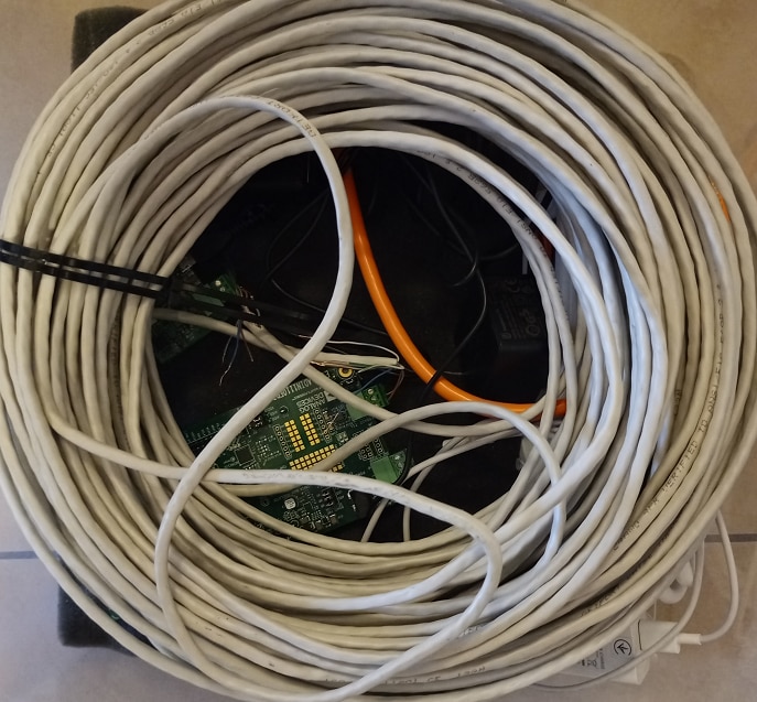

Then - in line with wolfgangfriedrich suggestion - available UTP pairs were connected in series, giving effective distance of 192 meters (and additional crosstalk between pairs).
And? The system was still working:
What is interesting - MSE metric is still the same and autonegotiation resulted in Master role (despite configured preference for follower).

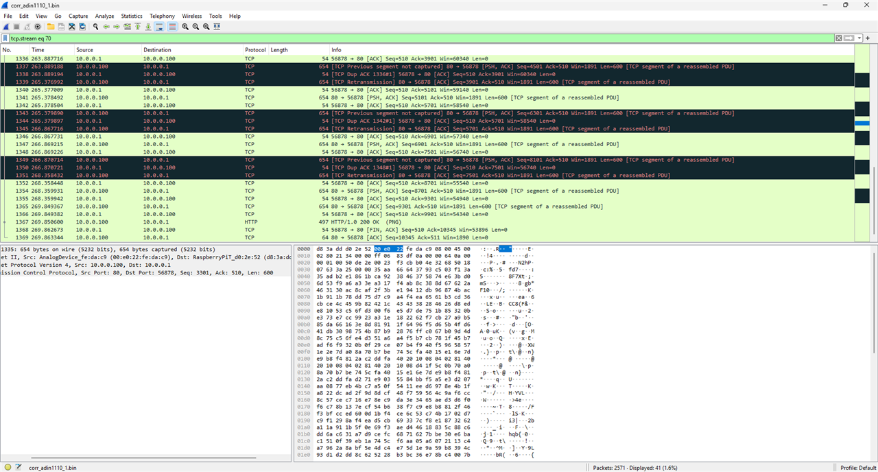

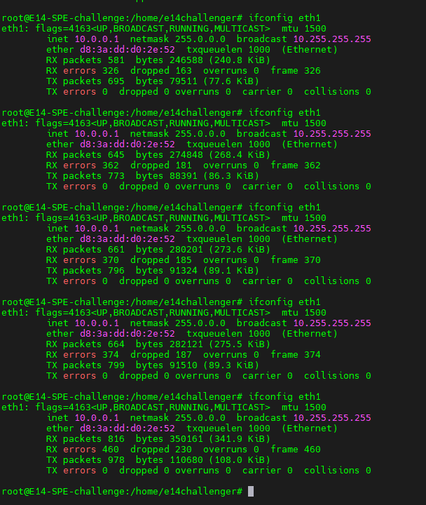

 Unfortunately, on Raspberry PI side ever increasing counter of receive errors was observed:
No good - although TCP retransmission  retrieves those lost packets, something is wrong:
but - ICMP echo from the host is not affected, not even a single ping is lost.

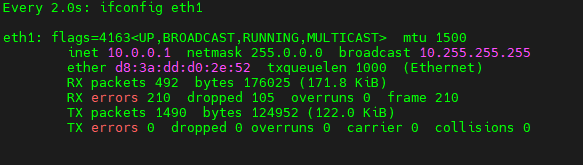

After some research initial setup (with 30 cm of MODBUS cable) was restored - and lost packets were also observed:
As a conclusion - ADIN1110 works on 192 meters of low quality cable. There is some packet loss but only in very specific situation: TCP data transmitted from ADIN1110, ICMP is not affected.
At this stage it seems that this problem is elsewhere: USB adapter or Raspberry PI or maybe ADIN1110 demo software?

    and - yes. it is impressive: 192m of cheap wire with improvised connections every 48m (just two wires twisted together - I would reject such a solution if I encountered it at work), probably generating signal reflections and impedance mismatch and probably no packet loss caused by the connection - especially when "standard" Ethernet over metal (this cable is not even copper but copper clad) is specified at 100m max (even 10Mb/s)
