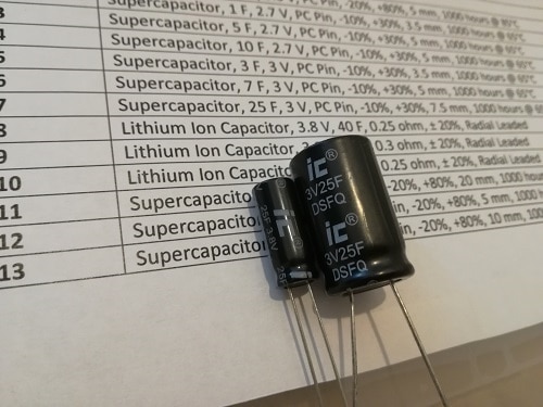

Capacitor types and families
Our kit contains capacitors from different families offered by our sponsor - Cornell Dubilier, kindly provided by Element14 in pairs of each part number (that can allow for parameter difference estimation between individual parts and/or building higher voltage circuits). It contains:
  • from DGH family (standard voltage - 2.7V, high current family) - 1F, 5F and 10F capacitors,
  • from DSF family (increased voltage - 3V, high current family) - 3F, 7F and 25F capacitors,
  • from EDC family (high voltage, low working current, low leakage memory backup family) - 0.47F and 1F capacitors,
  • from EDS family (high voltage, low working current, low leakage memory backup family) - 0.22F/3.6V and 0.1F/5.5V capacitors,
  • from VMF family (LIC hybrid supercapacitor family, high temperature tolerant) - 25F and 40F hybrid supercapacitors,
  • from VPF family (LIC hybrid supercapacitor family, designed for work from -25 deg. C, but with somewhat limited lifetime) - 40F hybrid supercapacitors,
It is worth noting that when other manufacturers offer capacitors rated at 2.3V-2.5V (standard) and 2.7V (high voltage), CDE managed to increase this voltage to 2.7V/3V and probably to 3.6V for low current models (if EDS224Z3R6H turns out to be single capacitor and not series connected pair).
Some of our capacitors are in fact supercapacitor batteries (as scottiebabe has shown at the challenge's forum some time ago) - pair of series connected capacitors, allowing for higher working voltage. This setup - it seems that without any balancing circuits, counting only on individual parts tolerances, is manufactured for years and seems to work good - below there is comparison with (about 20 years old) Panasonic Goldcap, that I have salvaged from old Intel server motherboard and which is in working condition despite old age.
5V supercaps
There are two things worth noting - size difference (they are both 1F/5.5V parts) which indicate manufacturing process improvement and observable thinning in the middle of the cell, indicating point of connection between individual supercapacitors.
Another thing worth noting is volume difference between standard and hybrid supercapacitors - below we can see two 25F parts. Smaller size of LIC indicates higher energy density.
LIC/standard size comparison
