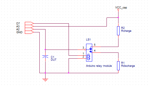

Inspired by the recent E14 LabView RoadTest I have decided to test Octave (open source Matlab replacement) Arduino integration for capacitor measurement.
Having obtained LattePanda v.1 during previous design challenge, I have decided to use it for this project. Theoretically, it is ideal candidate as it has Arduino board integrated with Intel Atom based SBC.
It is some sort of trade-off of course - main board has limited performance (using low-powered Intel Atom CPU) and using integrated Arduino Leonardo board raises cost of possible damage: standalone Arduino can be cheaply replaced, but damage to the builtin Arduino is not easy to repair.
Considering this I have decided to use hybrid approach at first - using Panda with external Arduino Uno. This way, if something happens to the board during development, it can be easily replaced, with the option to use integrated Arduino Leonardo when design stabilizes.

For example, using following schematics (where relay is in fact relay module for arduino - complete with overvoltage protection diode and a driving circuit)
arduino schematics
and Octave script like below

plot(x1_axis, data_chr, x2_axis, data_dis);
one can get charge/discharge plots of capacitor (like below), giving foundation for more advanced experiments.
