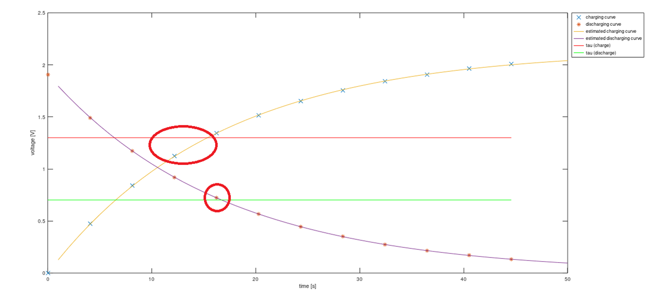

To better illustrate this, we will limit number of data points to 12 (measured every 4s) - in this case timing of crossing 0.368U and 0.632U thresholds cannot be precisely measured - resulting in significant error, but curve fitting still provides good quality data:
Capacitance [charge, using coarse charge time] = 0.001218 [F]
Capacitance [charge, using curve fitting] = 0.001645 [F]
Capacitance [discharge, using coarse discharge time] = 0.001620 [F]
Capacitance [discharge, using curve fitting] = 0.001671 [F]
charge/discharge difference [coarse time] = -32.99 [%]
charge/discharge difference [curve fitting] = -1.56 [%]
As we can see below, by accident measurement point during discharge happened to be near threshold line, but qualifying (with value lower than threshold) data point during charging happened almost 4s earlier, giving large measurement error. Of course, when using better formula (involving not only elapsed time but also voltage difference) errors are reduced, but not to the level of estimation using curve fitting.
