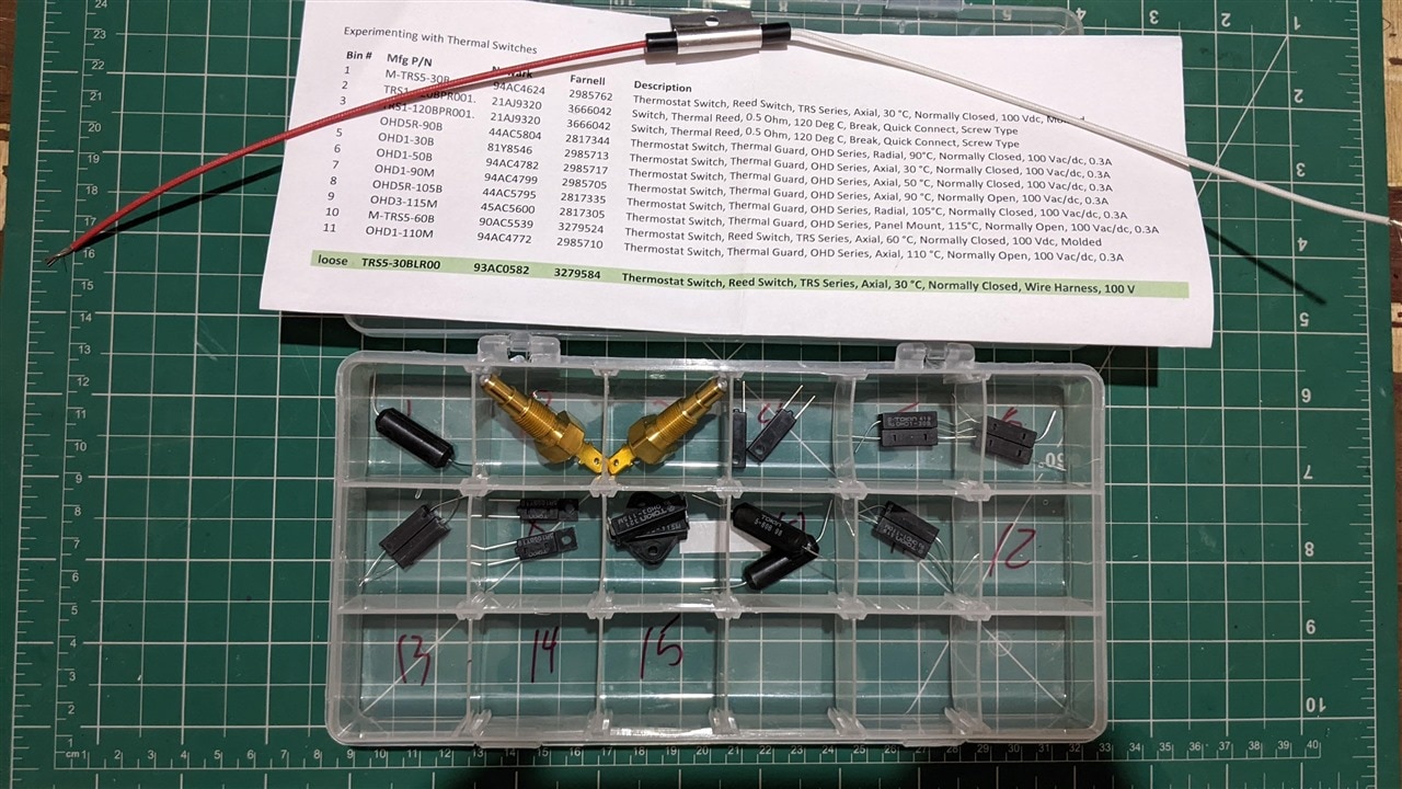

Firstly I would like to thank both KEMET and element14 for the opportunity. I have learned a lot of things in this experiment. I had received a kit with 12 sensors and all are amazing
for their respective applications.
Kit
In this experiment, I'm testing how one can check the accuracy and the point at which the conductivity begins and the effect of an external magnetic field on the device
Since I wanted to measure both temperatures near to the sensor and also the magnetic field, I thought of building one small experimental setup consisting of a microcontroller,
a display, a 3d magnetic field sensor and also a temperature sensor.
