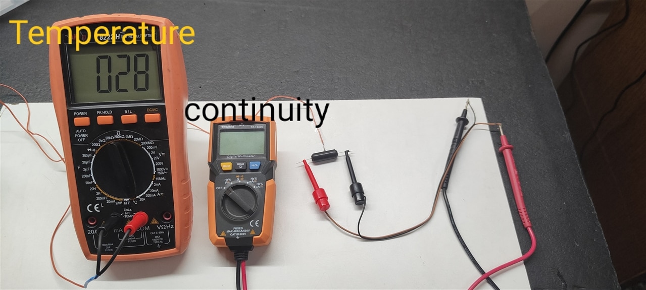

I am Testing all the Thermal switches according to the details provided in the respective Product datasheets.

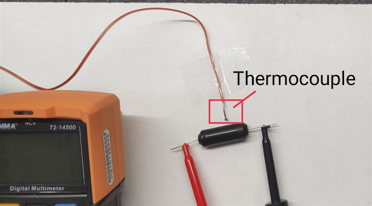

Thermocouple To Measure The Temperature Of Thermal Switch
Block Diagram of Arrangement Of the Testing
In this particular experiment Blog, I am testing thermal switch Open and close states with their operatable temperature. to test the switches I am using two multimeters, one for testing open and close state another multimeter is used to monitor the temperature of the Thermostat, To vary the temperature I am using Temperature controlled Solder Station.
The Whole Experiment is recorded and You can see the details in the Below Video
