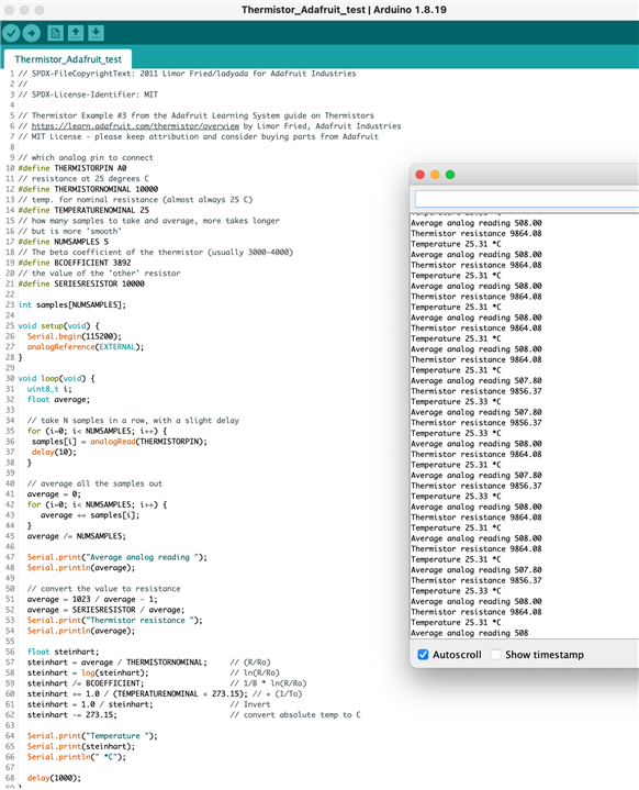

Ultimately, the part I’m interested in is towards the bottom of the article where they pull everything together into a neat little sketch that gives us the temperature readings we are after.
The math can get complicated, but they've already done the hard part of turning it all into a few lines of code.
No Charts, just 2 numbers!
One thing that’s really nice about the final summary sketch is that we only need to know 2 bits of information about the thermistor: the Beta coefficient, and the resistance at room temperature - both are on the data sheet, and probably even on the store listing. We don’t have to worry about typing out long tables of figures, and the typos that come with it.
For their tutorial they suggest a 10k resistor on the other side of the voltage divider. They are using a thermistor rated 10k at 25 °C, so I’ll just go along with that too, choosing my Molex 10k thermistor from the kit element14 so kindly provided, and using a 10k resistor for the voltage divider. I know that the fixed resistor can be tuned for my target temperature range, but that’s one of those technical details that I’m trying to avoid (for now), and such tuning is not necessary to get our first results.
Plugging it all in, here are my results…
First thermistor test results
Conclusion?
That was surprisingly easy! And the temperature looks to be right on target (compared to what my thermostat says).
Thermistors are not that complicated to use!
Seriously the part that took me the longest was when I soldered breadboard-friendly ends onto all of the thermistors in the kit!
Hooking up the wiring was straightforward, and the sketch was already built by Adafruit (MIT licence, so it's free to use, just be kind to give credit where credit is due). All I had to do was copy and paste the code into a new sketch, and update the Beta Coefficient to match my thermistor.
If we don’t require scientific-level accuracy, we can get a pretty good results by just picking a thermistor, hooking it up with a resistor, and using a basic microcontroller to read the temperatures.
